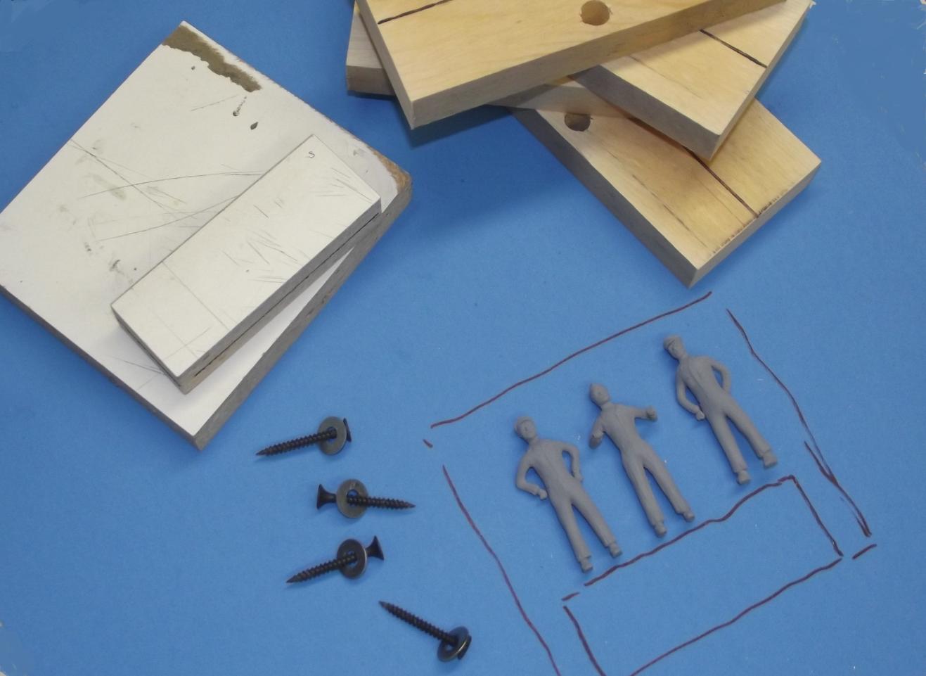

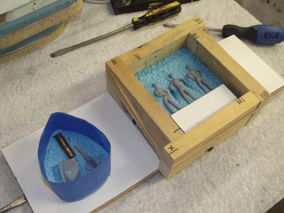

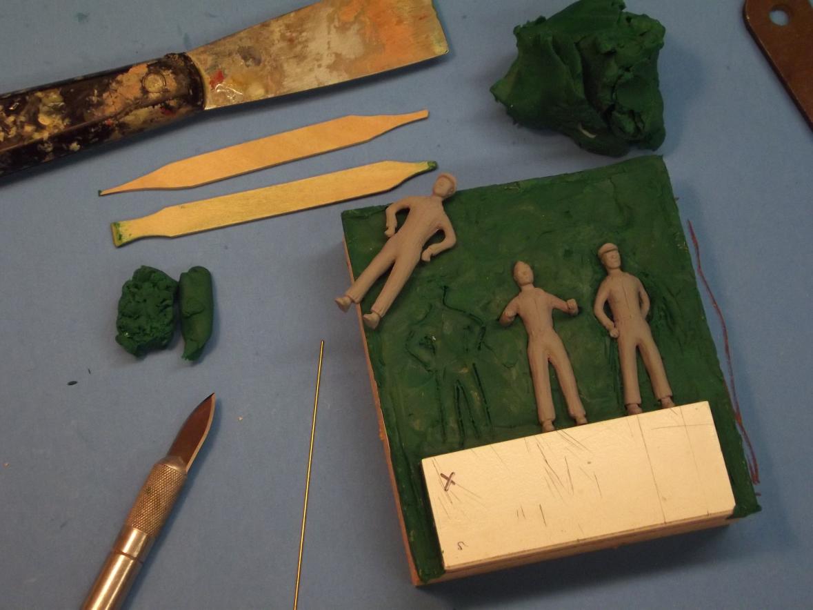

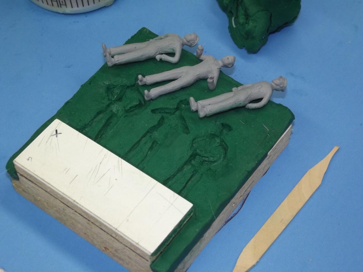

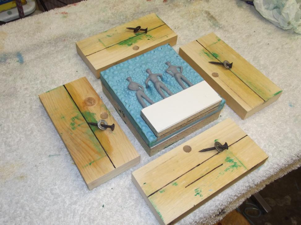

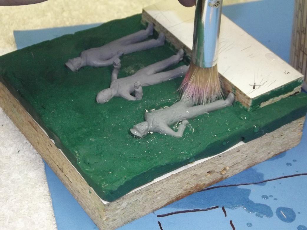

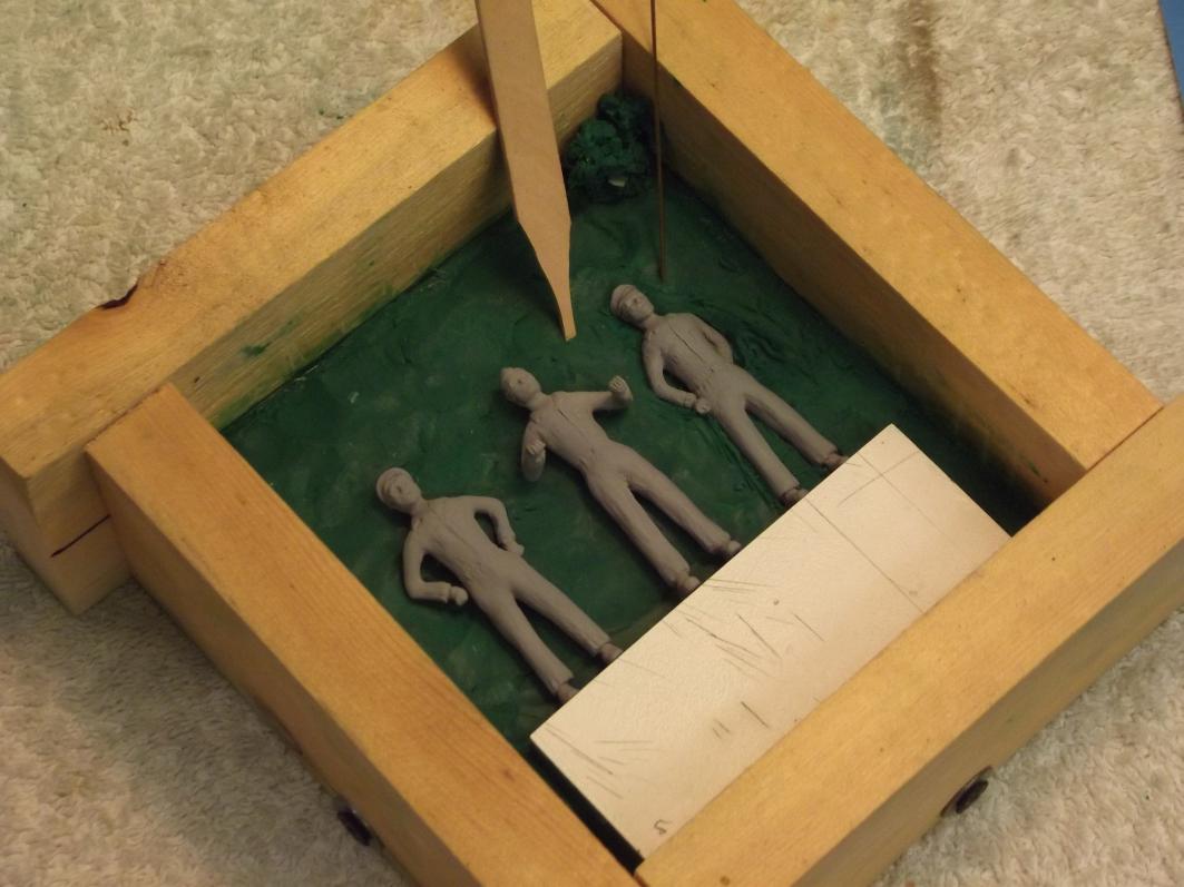

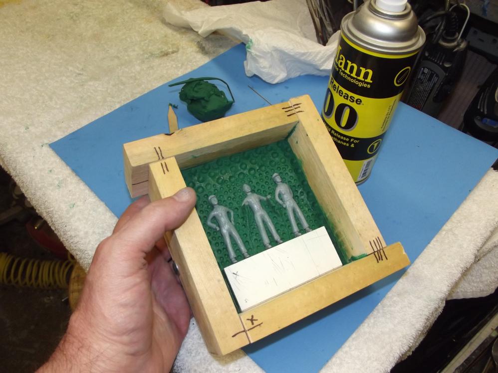

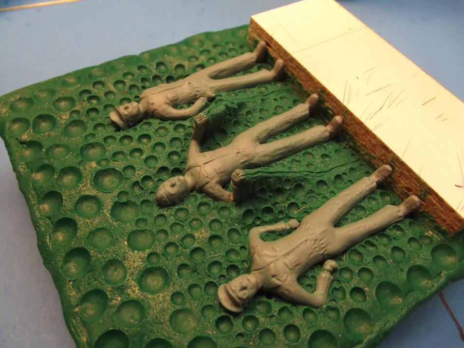

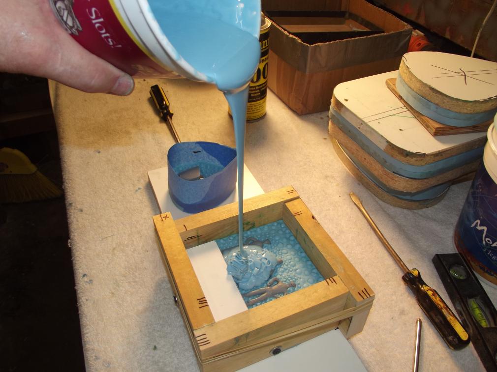

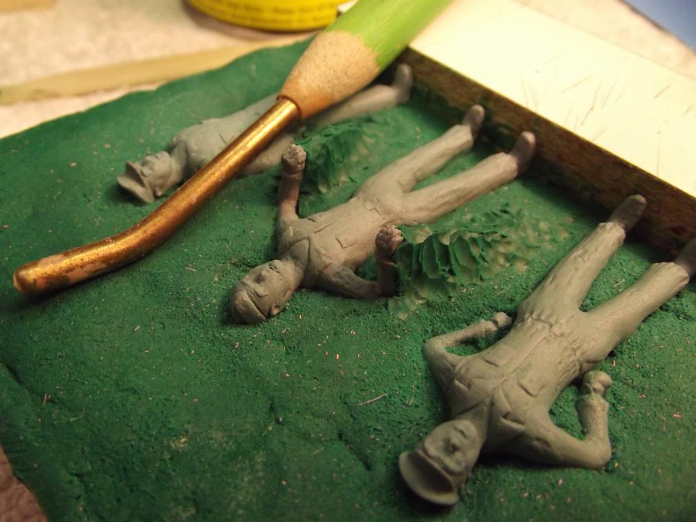

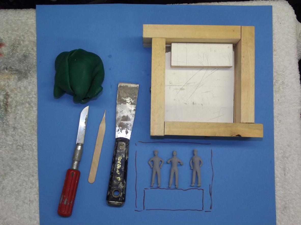

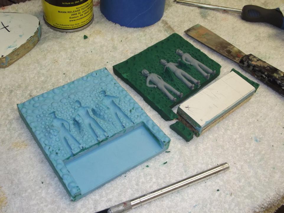

    OK, you ungrateful, critical, arm-chair-expert, SOB's! Here's the rest of the gay Nazi sailor work:

    Now ... go watch The Producers!
