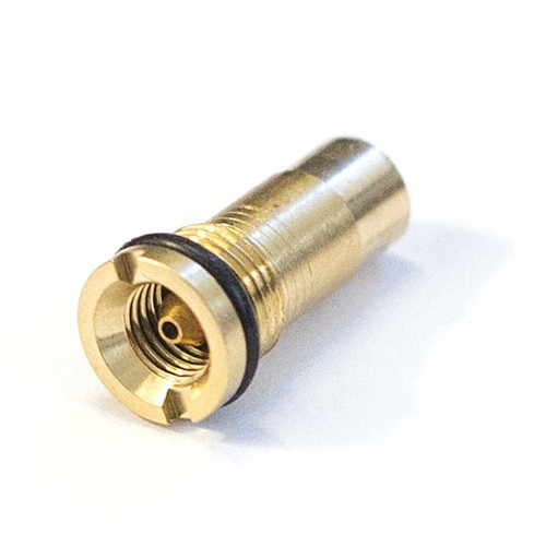

    What's the correct Badger Propel alternative and where can I buy it?
    Gents,
    The Propel supply in southern New England is gone, and it's looking like Badger doesn't sell the gas anymore. What do we use that's safe for our boats? Do we need to make up new charging rigs? Is it time to retire a couple more boats???
    Take care,
    Bill

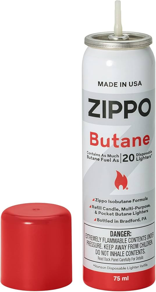

    Is there something special about the airbrush propellant? If it’s just a from of lpg, e.g, butane and/or propane then a bottle of calor gas or refills for camping gas coolers should suffice?
      • 2642
      Difluoroethane (R-152a) is a gas that tends to be listed as used for airbrush and aerosol propellant. It’s is mildly flammable, but butane and propane are highly flammable.

              Yes, gents, the gas is for in SubDriver equipped boats I've had for years. These are 1/72 and 1/96 scale and the gas goes in the back-up ballast system. I could use butane, but charging would be a certain adventure! ;)
