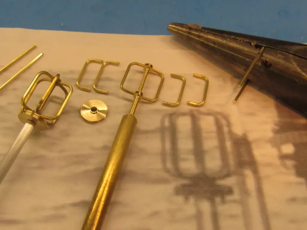

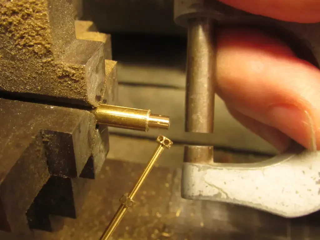

                David, can you repost additional pics of the process for this one? I get the jist of it, I like the precision and detail of such a small and complicated part. D0 it in your 'today's work' if you want.

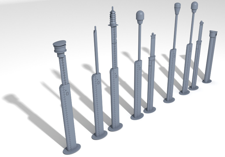

                      Having a full set of masts imports flexibility in your build options.
                      A set of 1/72 masts printed in ABS-like resin are pretty tough, and the more expensive engineering resins are even more durable.
                      When building custom boats, I print the sails with all mast openings clear, then insert a raised or lowered version to fill the openings. Generally, the periscopes (two types for the 774 class) are the only raised masts, but the customer gets the final say. A dab of RTV to the bottom of the masts allows easy replacement if required.
Name:	Rev 4 Ortho Perspective.jpg
                      This is a current full set of masts as carried by the Block IVs.

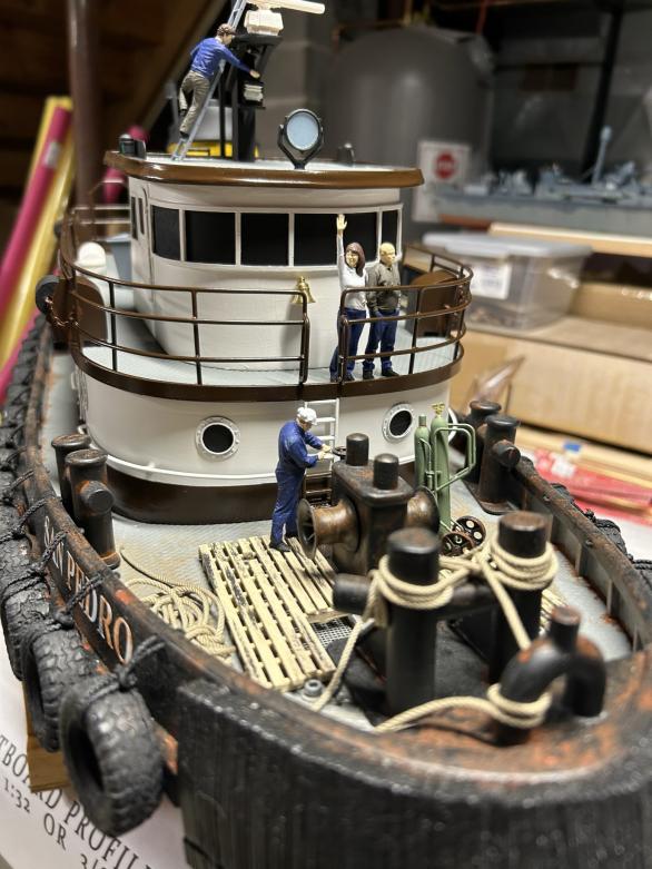

                        Although I’ll fabricate the masts, I won’t aspire to the level of detail and quality so masterfully demonstrated by David ;-) For one thing, I don’t have the skill set - but I also lack a lathe. My saving grace is that I normally aspire to a level of detail that 1) is durable and 2) is viewable / realistic at a minimum distance of perhaps 6’ from water’s edge. I’m not a rivet counter and I don’t like things to break. I like to operate. Just food for thought.

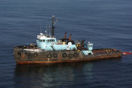

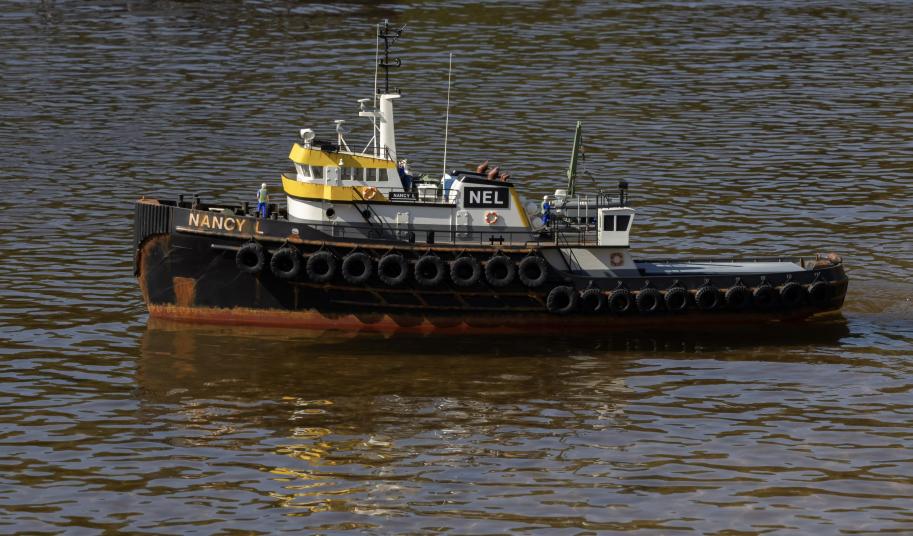

                        For example, here are photos of my San Pedro and Nancy L tugs plus a the real tug that inspired the heavy rusting on Nancy L. The detail on the tugs have two things in common. First, The detail is not designed to be examined from 12 inches - It’s created to have a realistic look at several feet from the water’s edge. Second, There are some things that I enjoy or have fun with that are not necessarily on the real vessel. Rather, it might be just something fun that I like to see on a vessel (ie creative license). I tend to agree with Frank’s approach: it’s my boat and I’ll do what I want LOL.
                        My Virginia class, as another example, Well on the surface will be able to play a variety of Music: Ranging from Navy versions of anchors away to The Andrews Sisters. Does that have anything to do with realism? Nope - But it’s an aspect of modeling that I just happened to love!
                        The San Pedro
                        Click image for larger version  Name:	IMG_3834-compressed.jpg Views:	1 Size:	77.4 KB ID:	195270
                        The model Nancy L
                        Click image for larger version  Name:	0u1a0152-compressed.jpg Views:	1 Size:	91.8 KB ID:	195271
                        The real tug.
                        Click image for larger version  Name:	IMG_0472.jpg Views:	1 Size:	36.3 KB ID:	195274

                          Love the rusting.
                          All figures need to be finished with a flat, flat, flat clear-coat. Unless it's wet leather or a sequined dress, figure flesh and clothing are presented as non-reflected FLAT!

                              I agree 100% - they actually are flat - but the photo conditions made a bit of a gloss look. Nothing more ridiculous than glossy figures!
