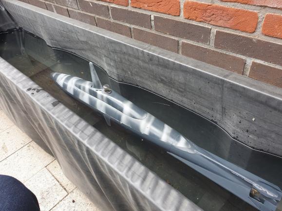

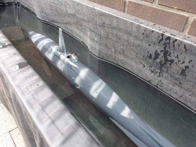

                              As promised some pics i took today, had to test the XVIIb anyways, this was not a succes, have to shift back some lead inside the ballasttank, she's now listing to the other side, so back to the cave with her.

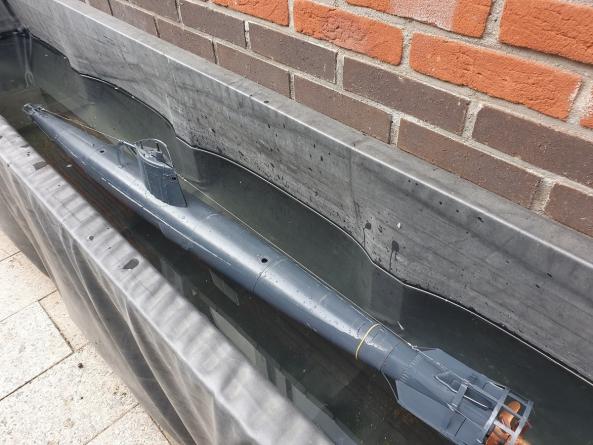

                              Pics from the trimmed Ko Hyoteki type B, using the same SD as with the V60
                              Same story with the V60, she is trimmed with the hatch open, you have to take in account that airbubble inside, if by accident the hatch will open she won't take the trip to the bottom, due to David's SD configuration you can trim both boats without using the transmittor, simply turn the boat around to fill up the ballasttank and shake her to get all airbubbles out.
