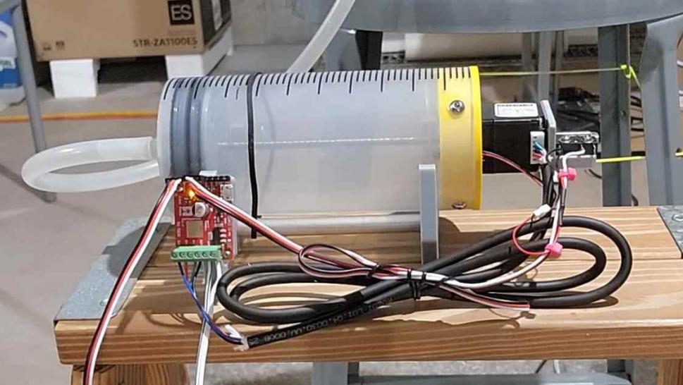

    This is a feasibility study and not a finished Product. I am trying to balance power requirements with acceptable dive times. I am testing a NEMA11 stepper motor with the POLOLU controller, Tic T500.
    Advantages of an open loop stepper motor over a brushed or brushless DC motor:
    Programmable parameters:
    Acceleration Rate (ramp up, down)
    Start velocity (torque is inversely proportional to speed)
    Maximum velocity
    As a result, these values can be fine-tuned resulting in no jerk on startup and piston “stiction” is more easily overcome.
  • TuptubBuilder
    • 153
    Final Specs:
    375 mL Capacity
    <300 mA, 12 VDC, 3.2 Watts
    <45 seconds to Fill / Empty
    Failsafe Limit Switches
    Two Rx Inputs required: one to Fill/Empty, one KILL switch (eliminates holding Torque)
    BOM:
    (1) YEJMK Non-Captive Linear Actuator, NMA11 Stepper -Amazon
    (1) POLOLU Tic T500 Controller
    (1) 500ML Syringe - Amazon
    (2) E61 micro switches - Amazon
    (5) 3D Printed Parts, (1) 3D Printed Hole Template
    Misc: double face tape & hardware
    Listed Items less 3D Prints & Misc = 75 USD

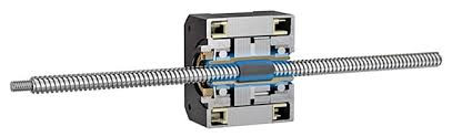

        Thanks to the boom in 3D Printers, these non-captive linear actuators are dirt cheap.
        The center of the stepper motor contains a lead screw nut. This NEMA 11 stepper motor can produce around 24# of thrust. The only caveat of using a stepper is the possibility of "ringing" This is when the Stepper motor loses steps. To prevent this, I limit the Acceleration rate to 100 pps/sec. So this 27 dollar stepper eliminates the gear box that a DC motor needs. The POLOLU Controller provides the RC interface and limit switches for the end stops. All in all, it's a clean cheap setup. The difference in running wet vs dry is 50 mA. I haven't determined max operating depth but am confident that it's good for 1.5 meters.

              At the risk of sounding a little too geeky I have been giving this some thought and maybe a soft start is the problem given the overall stiffness of the system. In other words, maybe it initially needs to be hit with a hammer instead of a gentle pull. I hate to take this approach due to the subsequent wear and tear and current draw. The only difference between this system and the German's is the instantaneous acceleration of the Engel Piston Tank. I think the Engel system calls for a silicon grease for maintenance.
              if anyone has any authority on this subject, please share it.

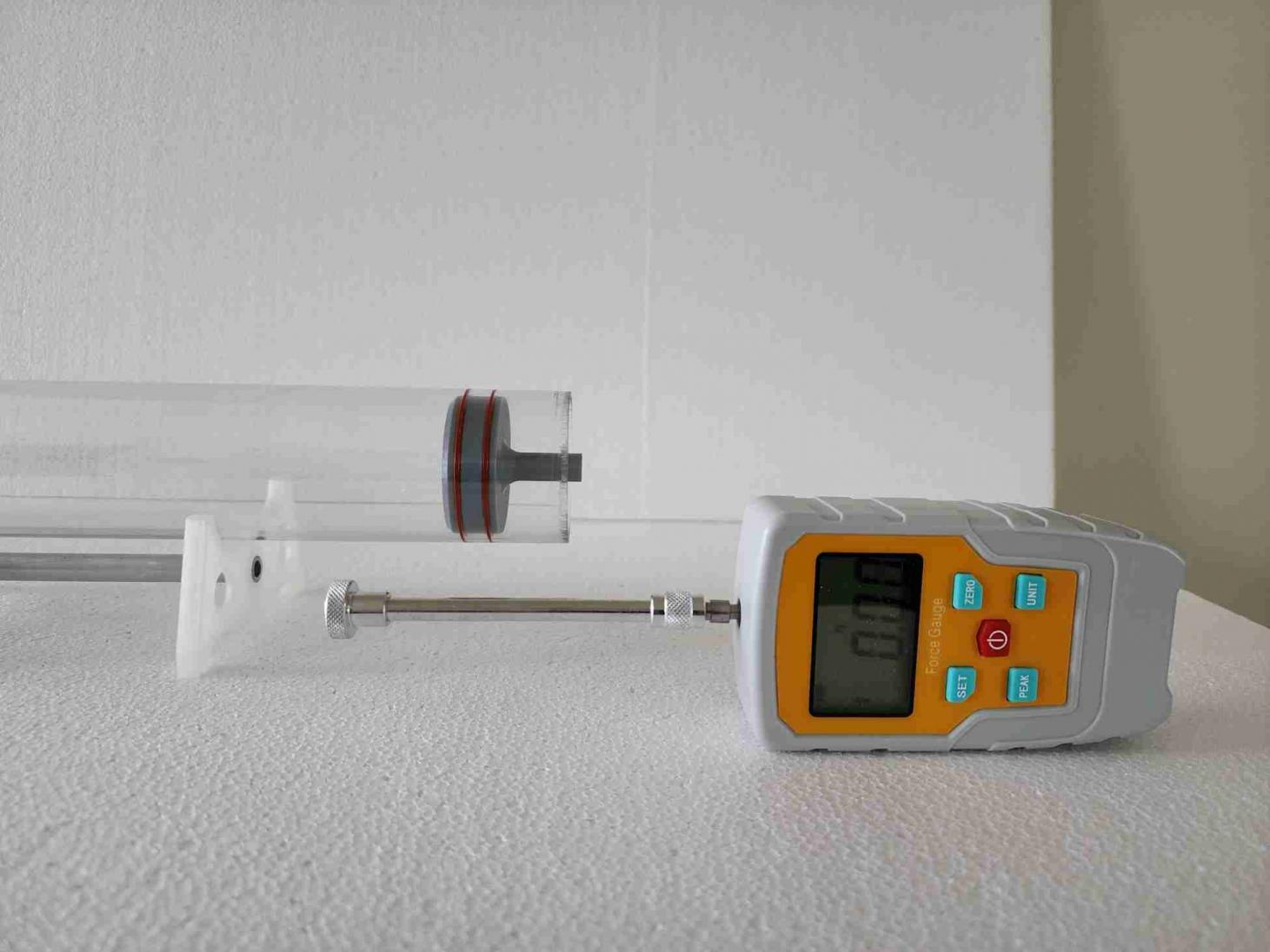

                  Measured static friction up to 10 pounds and dynamic friction was less than 3.5 pounds.
                  The problem I’m trying to address is the “sitting overnight” stiction.
                  I couldn’t measure it because my force meter maxes out at 15 lbf.

                        The sealing rings in a syringe have much higher pressures than necessary for sealing against water. Have you thought about making the piston with standard o-ring seals to lower the force needed for movement?
                        • TuptubBuilder
                          • 153
                          Yes. I did and commented on it. It's buried in the PDF. I used an acrylic tube as the cylinder and found it to vary too much dimensionally.
