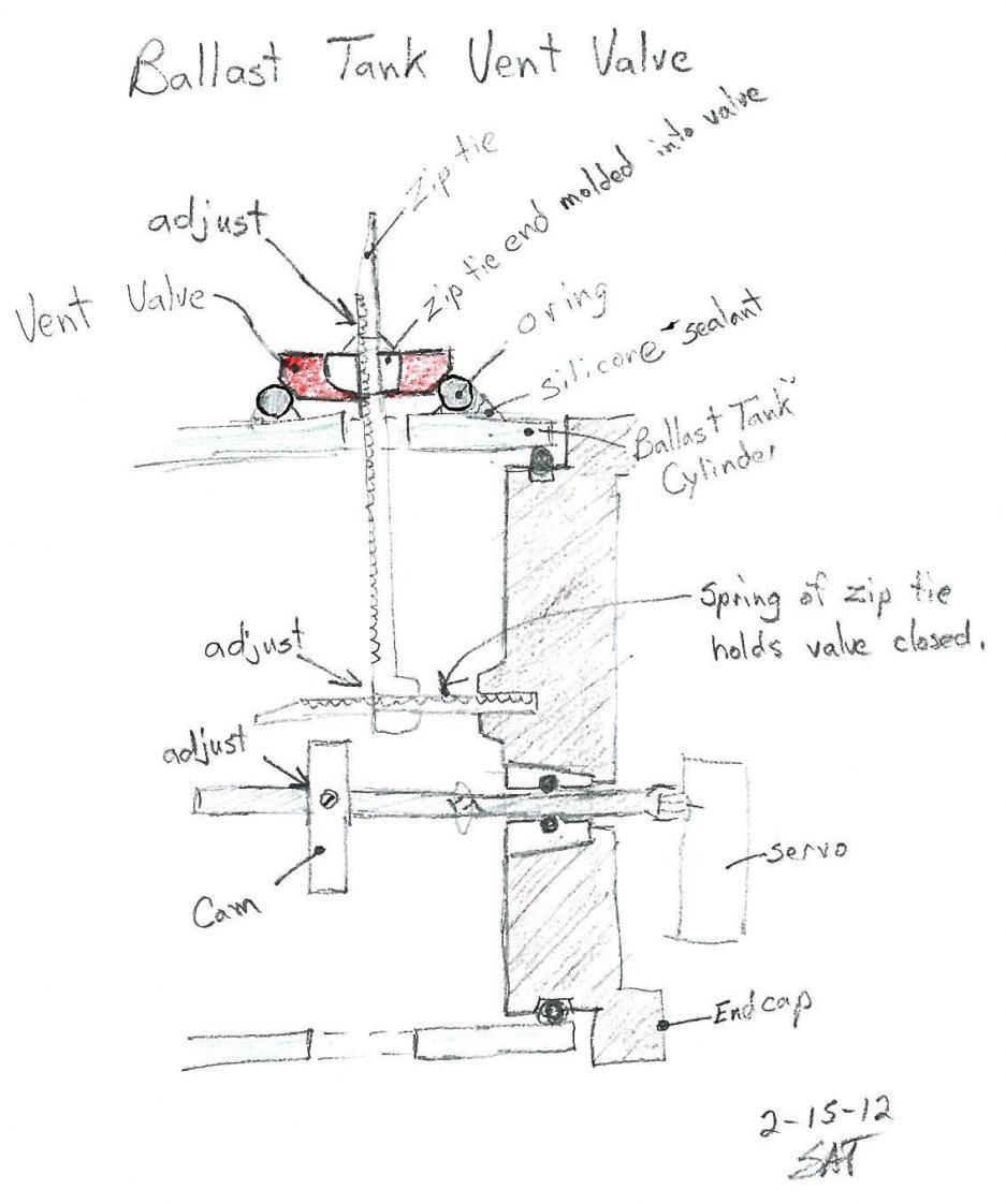

        Here is another experiment someone might try on a vent valve.
        It has always bothered me that in pictures I have seen the ballast
        vent valve hangs outside the ballast tank. I'm not sure if the arrangement
        in the attached picture will seal well so thats why this concept is
        still a experiment.
        1) Start with one of the ballast end caps that has the rotating acuator for a gas ballast system.
        2) Make hole in top of chamber and glue and seal a o-ring centered on the hole for valve seat.
        3) Make a valve with a zip tie end molded into it.
        4) Attach a partial zip tie (spring-tie) into the ballast end cap at proper position for acuation and seal pressure.
        Length from end cap should affect spring-tie pressure for sealing.
        5) Make attachement of valve and spring-tie with a full zip tie using the zip action for adjustments.
        Seal zip tie end in valve after adjusting with silicone seal to make air/water tight.
        6) Make a Cam on rotating acuator shaft that will press upward on spring tie to open vent valve.

        Call me crazy but I needed to share the idea. You may ask why doesn't he try this himself.
        My best excuse is I ran out of peanut butter. My other excuse is I have a mental block
        about spending money as you can see the idea calls for things that don't cost alot except
        for the endcaps.
        Also there is a liquid clothes soap dispensers that has a nicely shaped valve that might be
        usable with some disasembley and modifications.
        Scott T

          #64
          Nice illustration. I believe we already tackled this in another thread here. The problem with using a vent valve that's seated outside the ballast tank and goes up is that during a vigorous blow the impluse from gas would lift it off it's seat leaking gas and you get going up is bubbles not the sub. BUT, But this could work well with a snort/LPB.
            #65
            The vent valve on Dave's cylinders are designed to seal tighter as pressure increases in the ballast tank. I guess this is to prevent pressure from the gas causing the valve to creep open when blowing the tank.

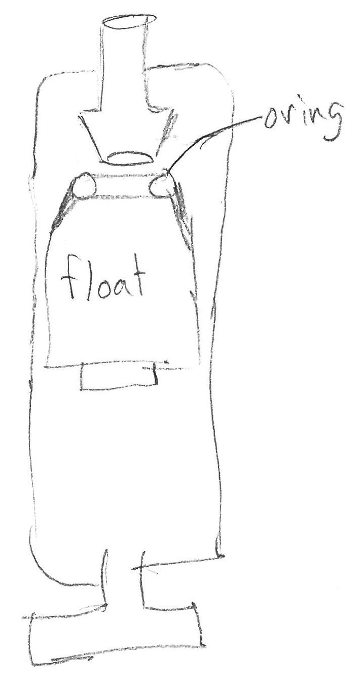

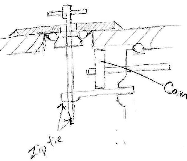

              OK flip the vent valve to the underside.
              Do you think a 0-ring would make a good sealing surface?
              They are cheap and easily replaced. Rip it off and seal
              another on.
              Would a o-ring work in the float valves Mr. M is perfecting?
              I guess I haven't seen the latest revision of the sub driver vent valve.

                #67
                If you flip it round it will stick outside of the tank. o-rings can seal a valve like this, yes. Probably best to use a silicone o-ring, they tend to be softer than nitrile.
