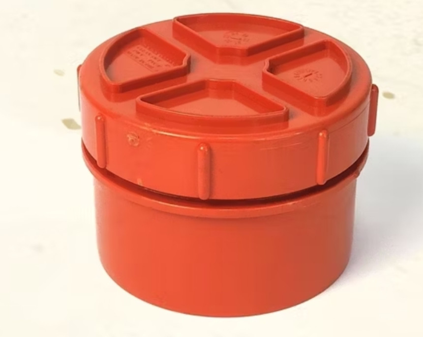

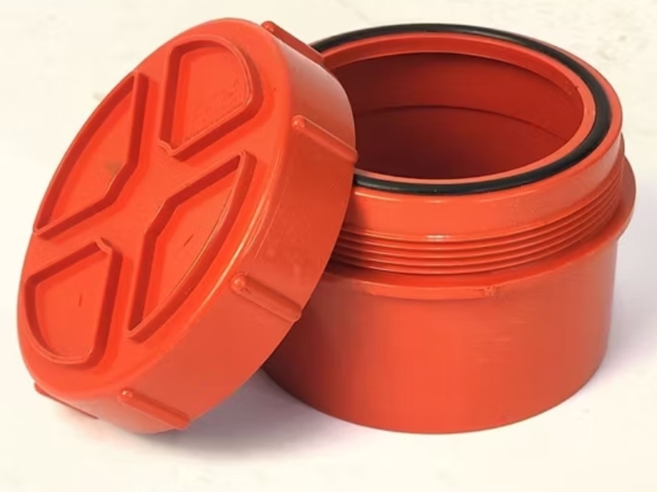

        Was pondering the other day about a simple wtc that didn't require a 3D printer or lathe to make the endcaps and be readily available.
        Using PVC pipes was at the top. Cheap and easy to procure. For the endcaps one could use those cleanout plugs. Click image for larger version
ID:	188802 Click image for larger version
ID:	188803 These come with screw threads and are sealed with o-rings.
        To get around the inability to see inside a clear window can be glued to one side.
        There's this idea that I'm considering, would it be possible to combine the clean out plugs with the clear tubing? Epoxy or RTV the clean out plugs to the end of acrylic/lexan tube.

          I experimented with the Valterra bayonet endcap that's used in their RV plumbing system many years ago and the results were mixed. I had leaking due to manufacturing defects or poor tolerances. Really depends on the brand and the quality off the shelf. Gluing commercially available plumbing endcaps to clear cylinders will work, provided that you can find matching diameters of cylinders.
