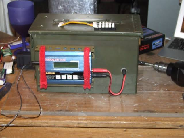

ID:	185177 Surplus ammo box li-po charging and storage

                            I store 'em outside the house. Each ammo-box is outfitted with a 'blow-out plug'.

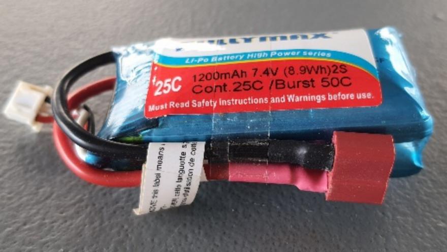

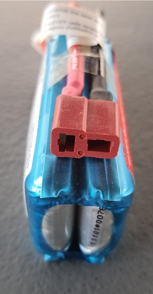

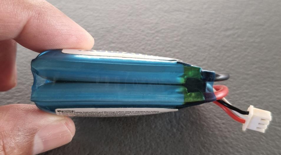

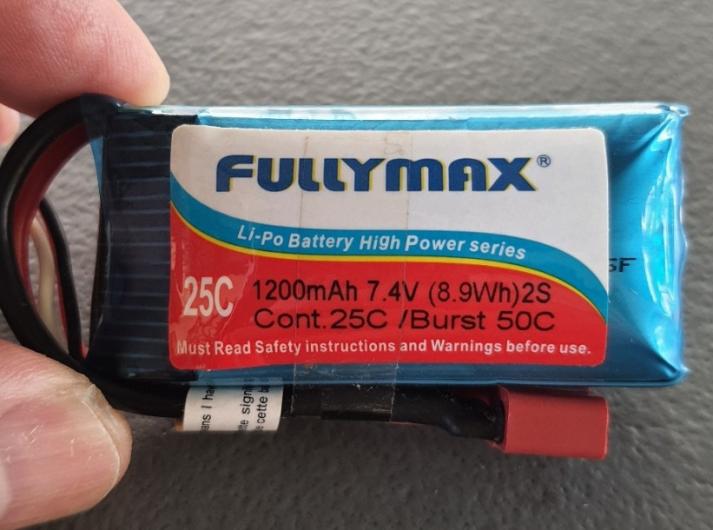

                              So it's no longer advisable to charge/use this despite the good readings I get with the lipo tester?
