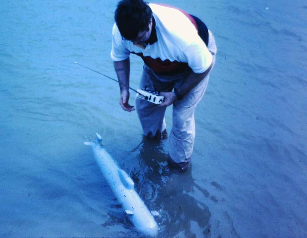

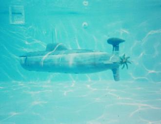

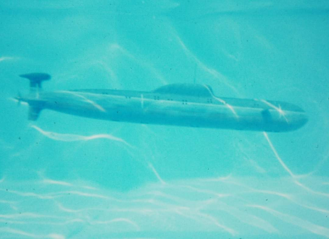

            David's first RC sub. Click image for larger version
ID:	183118 Click image for larger version
ID:	183119 Click image for larger version
ID:	183120 Looks like lower half of the ventral rudder is all-flying

              Nice Akula!

                  Good catch, Romel. Yes, my first 'working' r/c submarine. A 1/96 AKULA. This hull derived from tooling Ellie and I made in support of an industrial display we were commissioned to build for the Librascope company in the late 80's. Here are some pictures of the work we did for the display piece and my r/c version which was assembled shortly on the heels of the commissioned model.
                  Point of interest: I originated the acronym, WTC. The 'WTC' originally stood for Water Tight Container, not Water Tight Cylinder. The renaming occurring after I switched from custom formed the AKULA's GRP water tight boxes to water tight lengths of Lexan cylinder. The acronym soon become the world standard as to how to describe any removable cylinder used to contain r/c submarines internals.
                  Second point of interest: Nick Berge, unknown to me at the time, originated the use of removable plastic cylinders to contain a model submarines internals. Not me. Look this guy up -- he was the UK's Skip Asay.

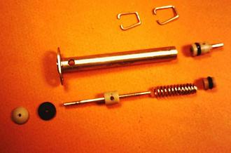

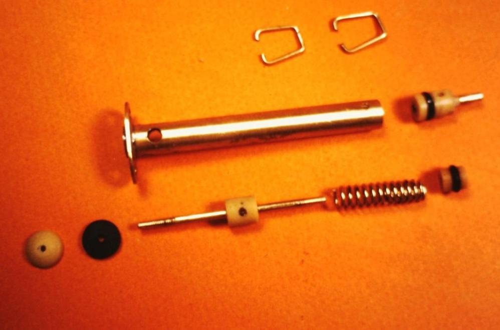

                      can you describe how this works?
ID:	183128 I initially took this for a mast elevation/retraction mechanism for the Akula

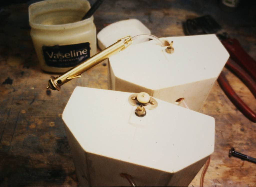

ID:	183126 until I noticed it mounted horizontally inside the ballast tank

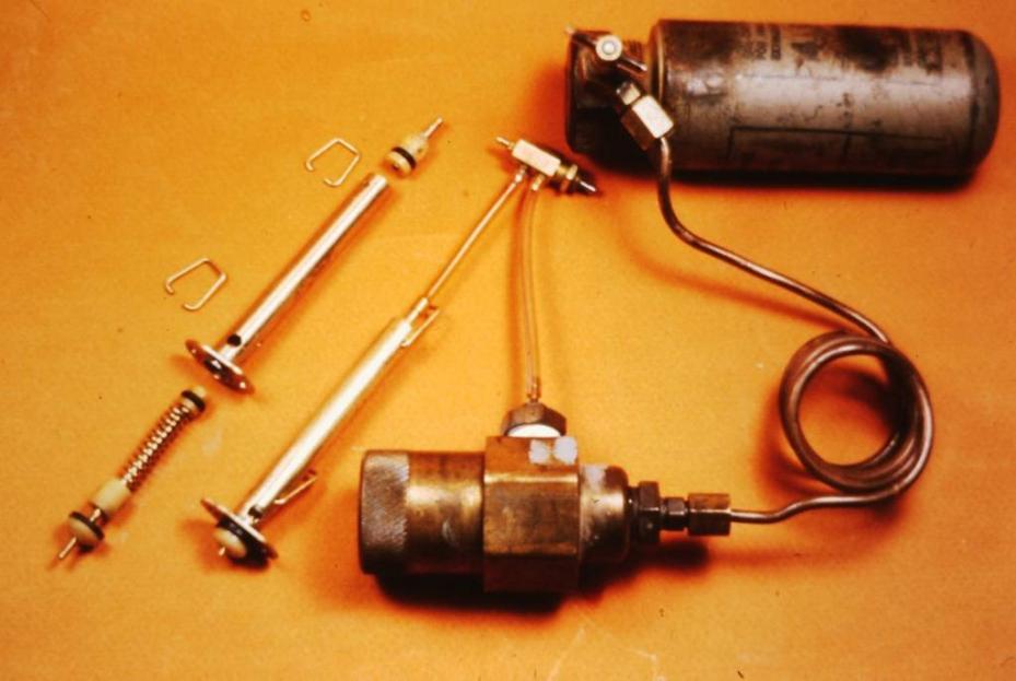

ID:	183127 vent/blow valve?
                          Click image for larger version  Name:	1L5jkC.jpg Views:	0 Size:	53.1 KB ID:	183128 I initially took this for a mast elevation/retraction mechanism for the Akula
                          Click image for larger version  Name:	vWorzw.jpg Views:	0 Size:	96.2 KB ID:	183126 until I noticed it mounted horizontally inside the ballast tank
                          Click image for larger version  Name:	mFn4B1.jpg Views:	0 Size:	56.4 KB ID:	183127 vent/blow valve?
                          Pneumatically actuated ballast tank poppet vent valve. Actuation and blow gas coming from a reduced CO2 supply.
