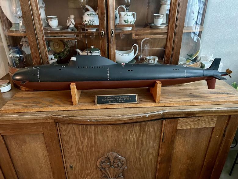

    I have had the pleasure of getting a Matt Thor Alfa. I love Matt's fiberglass work. Truly well done. I heard from two people (Matt Thor and Tom Spettel) that indeed there were two versions, one the original was accurate for the day, but then as more info came out, updated his sub. This one is an older version. David, am I right in saying you had your hand in the updating? If so will you share info for those of us that may want to update theirs?
    Here is a photo of the sub I got:
    Click image for larger version  Name:	IMG_1510.jpg Views:	66 Size:	83.8 KB ID:	183056
    This sub the owner used the whole rudder to improve turning. I think I would like to make it more scale.
    David, I look forward to your download of knowledge!

      Hey, Steve,
      Yeah. "In the good old days" I contributed my time and resources to produce an 'upgrade' fittings kit for the 1/72 ALFA that was being marketed by Mat Thor. I was in a strong position to employ some of my long-standing documentation as well as findings that were uncovered during my work for the effects guys on The Hunt for Red October movie. The kits stern -- which had the coke-bottle shaped stern (Hogner stem), an error I decided to just live with. However, the vertical and horizontal stabilizers had to be replaced, as well as the bow planes, main condenser ram-scoops, and inclusion of cast resin mast antennas, marker buoy, propeller vortex attenuator, and some other detail items. Also produced were cast metal control surface yokes and horns as well as a proper left-hand propeller.
      After all the research, working drawings, pattern making, tool construction, and part production we only sold a few -- most people complaining about the high price of the product.
      **** 'em!
      Anyway.
      E-mail me, Steve. I'll fix you up, pal.

        That’s a fantastic looking Alfa, David. Do you still have it? That model was worth every penny of its asking price. The various masts on it are awesome.
          • 13998
          Still got it. A torpedo shooter too.

                This is a gold mine of information! Thank you David. Let me pour over this for a moment or two. I see you did an extension on the lower rudder. Is it a turning pig without it?
                Peace,
                Tom
                  • 13998
                  Peace,
                  Tom
                  It's a turning pig without it. Those big ass fixed vertical stabilizers dynamically over-stabilize the boat about the yaw axis. Good bumpers to protect the rudders against ice, deadheads, Japanese fishing boats and groundings, but reduce maneuverability and increase drag and add to the boats acoustic and radar cross-section. Bad ju-ju! The reasons why we good-guys stick with full flying rudders
