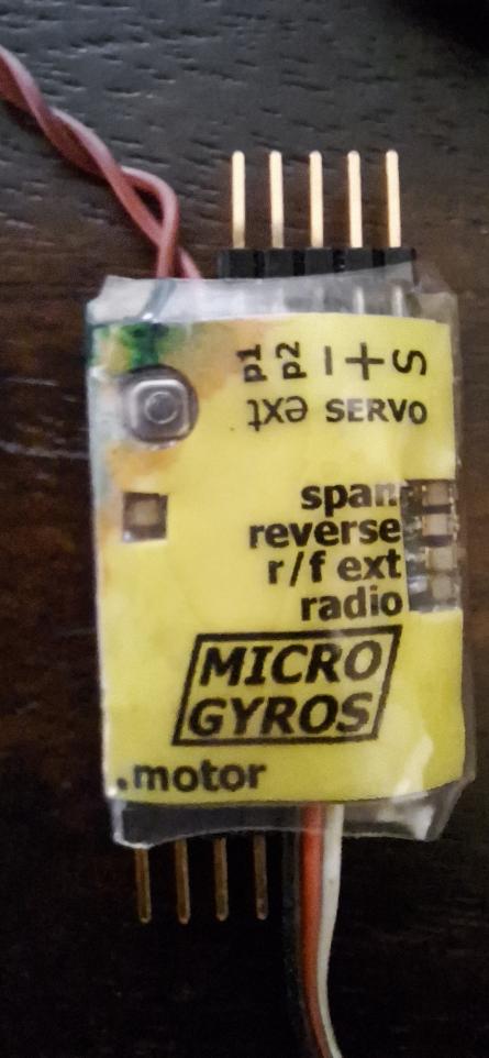

    Noted some greenish discoloration on my Microgyro pitch controller.
    What could have caused it?
    Unit was in cabinet but never been in the water. Unit works just fine when tested. Click image for larger version  Name:	20241002_161738.jpg Views:	0 Size:	48.0 KB ID:	182947

    Copper oxide is green....corroded contact?

      High humidity has allowed build-up of copper oxide (verdigris) on the wire at the solder joint. Careful application of isopropyl alcohol with a cotton swab will remove it.
