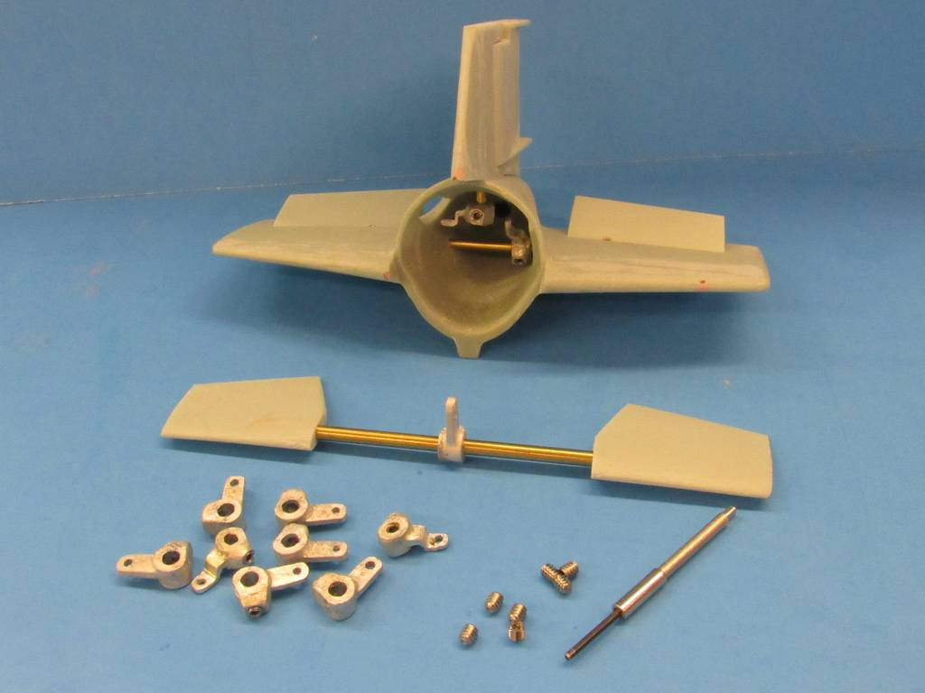

            • 3528
ID:	179505those tiny white metal control horns are perfect for cramped spaces.
