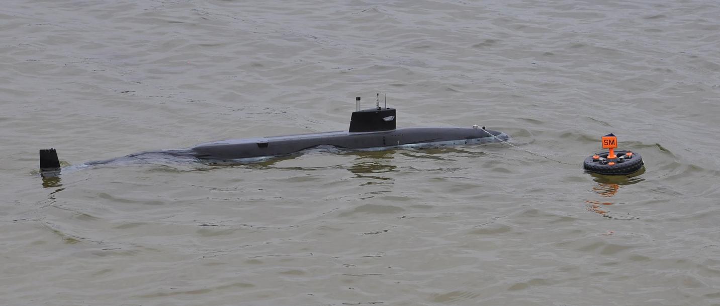

                    So I leave my boats on a mooring. I can have up to three sitting there, already rigged for sea, ready to get underway by just removing the bow magnet, and flipping on the FOB.
                    Here's the 631 sitting in lake Ronkonkoma demonstrating "SM" (Submarine Mooring Buoy ID, it's a QM thing.). She has three SS Mooring chains to RE Magnets. Each boat I build now gets a magnet on the inside of the hull fwd to "ride the mooring".

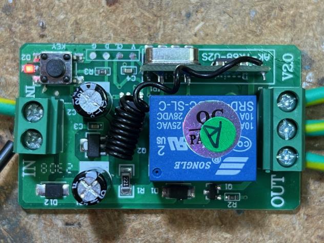

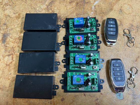

                        Here is a review of the item from Amazon I posted in the first post. After some frustration deciphering the chinese-english instructions I have it working how I want it to work and it is what I was looking for.

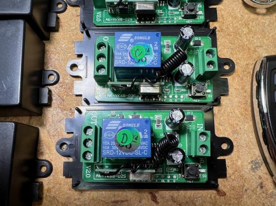

                        It comes with four receivers, receiver cases, two keyfob transmitters and transmitter clips. The keyfob's did not come with the typical plastic sheet inserted so the batteries were in use from the time they were inserted and stored wherever. But both worked when any of the buttons were pressed. Each receiver has been labeled to the corresponding letter on the keyfob, nice touch.
                        Click image for larger version  Name:	IMG_2875.jpg Views:	3 Size:	51.5 KB ID:	177666
                        Closeup of two of the receivers. The two inputs on the right are power inputs. The triple connector on the left is output. In the lower right is the learn button to change the mode the units operate in. In the corner by the learn button is a led indicator. It lights when power is applied or when the learn button is pressed. The relay is rate for 10 amps which is enough for my purpose. The coiled wire is the antennae. The circuit board appears well built and labeled. The silkscreen is done nicely.
                        Click image for larger version  Name:	IMG_2876.jpg Views:	3 Size:	58.0 KB ID:	177667

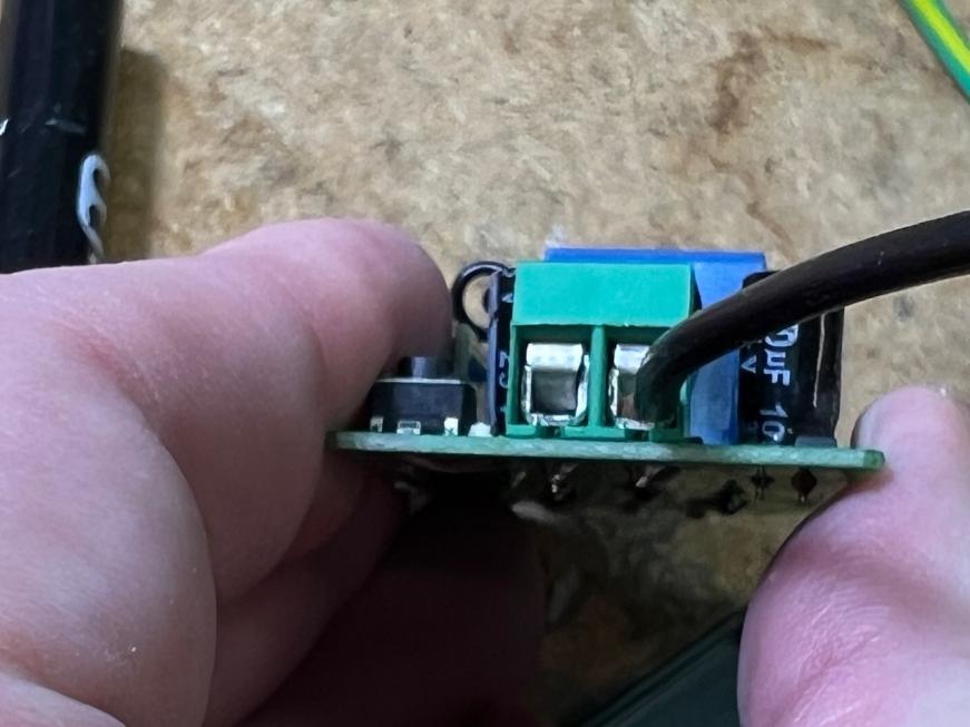

                        One thing I did not like are the connectors. They have a spring thingy where you insert the wire. When inserting stranded wire it might tend to separate the twisted wire and cause some to stick out. I prefer the blue connectors if you are familiar with those.
                        Click image for larger version  Name:	IMG_2878.jpg Views:	3 Size:	56.0 KB ID:	177661

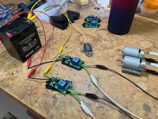

                        This is my test setup, to test two units at a time. A 12v SLA battery, a few wires and two Mabuchi 555 motors. Directly connect to a battery these motors draw 225ma no load. Out of the box these units were setup as momentary. So when the button was pushed the motors would turn on, let go of the button they turn off. Not the setup that I want, not useful. Reading the instructions, you need to press the learn button twice, then press the desired letter, A or B or C or D. So I did that. But according to the instructions you need to do some uncommon wiring to get it to work somewhat.
                        Click image for larger version  Name:	IMG_2879.jpg Views:	3 Size:	54.1 KB ID:	177668
                        The bottom of the receiver. Looks nicely made.
                        Click image for larger version  Name:	IMG_2880a.jpg Views:	3 Size:	58.8 KB ID:	177663

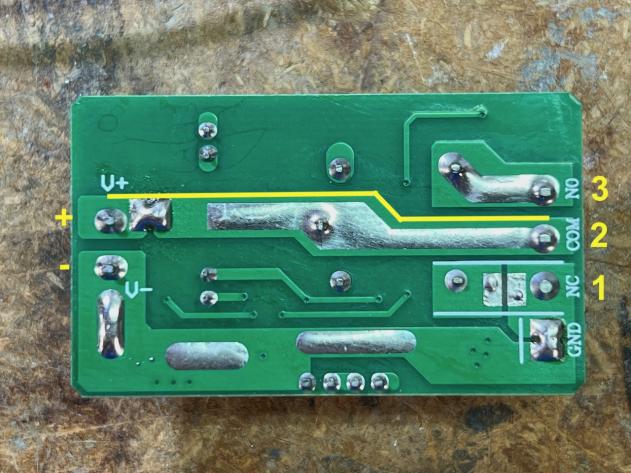

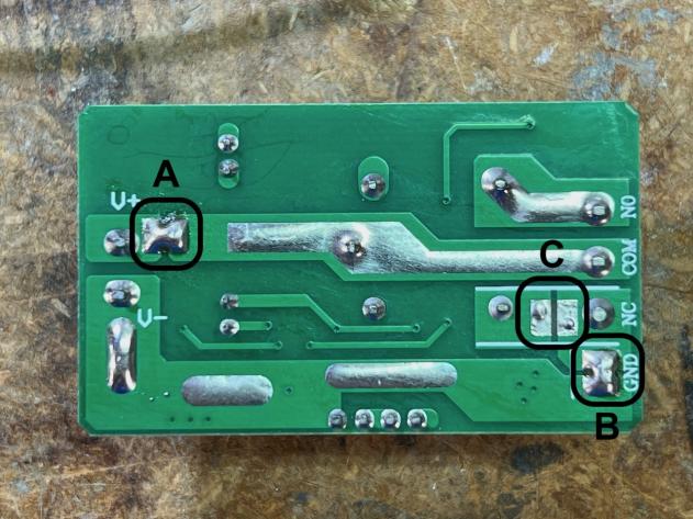

                        Notice these three solder jumpers. Out of the box, C was soldered, A and B were not. After some trail and testing, you need to remove the solder from C. And you need to solder across A and B.
                        Click image for larger version  Name:	IMG_2880b.jpg Views:	3 Size:	58.4 KB ID:	177664
                        When you solder A, it connects positive to the center position of the output. So whatever input voltage you are using, you will get that output pin 2. That pin on the silkscreen is labeled Common. I would think common would be negative-ground. But it is probably labeled that way for one of the other configurations. Soldering B makes output pin 1 negative or ground. Output pin 3 appears to be connected to a relay pin. So pin 3 would be positive, or in my case 12v.
                        Click image for larger version  Name:	IMG_2880c.jpg Views:	3 Size:	58.0 KB ID:	177665

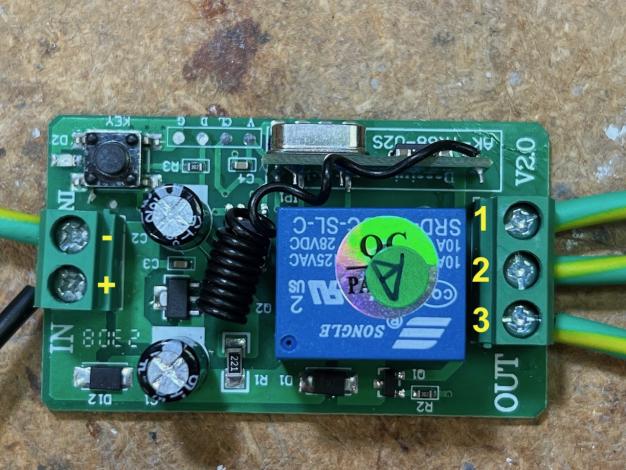

                        The component side.
                        Click image for larger version  Name:	IMG_2886a.jpg Views:	3 Size:	62.2 KB ID:	177662
                        You can see the input on the left and output on the right. Pin 1 is ground. Pin 2 is your input voltage and is always hot. So if you connect something to Pin 1 (ground) and Pin 2 you will always have power. Pin 3 activates when you press the proper button on the keyfob.
                        Click image for larger version  Name:	IMG_2886b.jpg Views:	3 Size:	61.7 KB ID:	177669

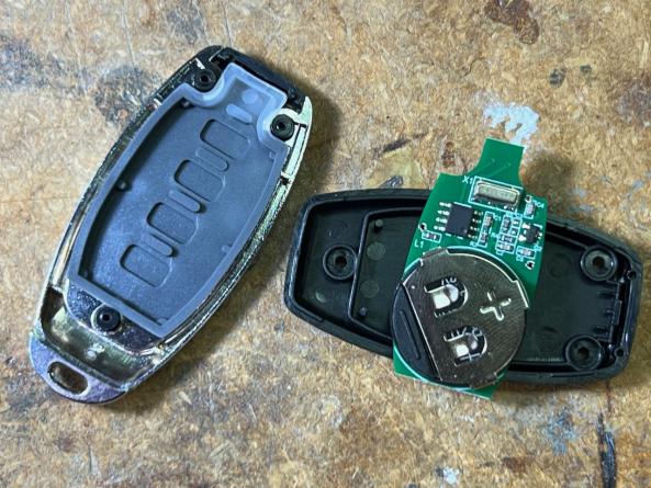

                        The keyfob. Well built. Three screws and the bottom is off.
                        Click image for larger version  Name:	IMG_2888.jpg Views:	3 Size:	61.8 KB ID:	177670
                        The battery side. I did not want to remove the battery for fear of having to relearn the buttons. Since I already disassembled the test setup. The Amazon page specifies a CR2 battery. Probably a CR2032. Nothing is said about the battery in the instructions.

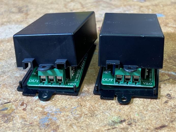

                        The Amazon page shows the instructions, same that came with the unit. It took a bit to figure I had to unsolder C. Once the soldering was taken care of everything worked like charm. So for now I'm happy with this and look forward to getting it in the party boat I'm working on. I did not test for any other configuration as I have it working like I want it to.
                        Something to note. No matter which way you put the board in the case, assuming the wires would exit the case directly in front of the connector, the exit point in the case does not line up with where the wires would be. Maybe if you used a small gauge wire that would work, but I'll be using 18 gauge which will not be flexible enough. Guess I'll be drilling holes where they need to be for the wire exit points.

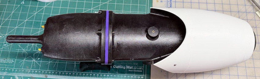

                          Done trying the wireless route, two for two only getting a few uses before they die - board lights up but no power out.
                          Has anyone used a mechanical sealed switch? Care to share link ? any lessons learned sealing relative to the WTC
                          FYI takes me a bit longer to get into the WTC - 6 screws after the three
                          holding the front half of the body off.

                          WTC has six bolts around holding halves together and squeezing the seals - takes a minute to open/close. Ideally would like a pushbutton could mount in the back of the WTC reach in push on/off.
