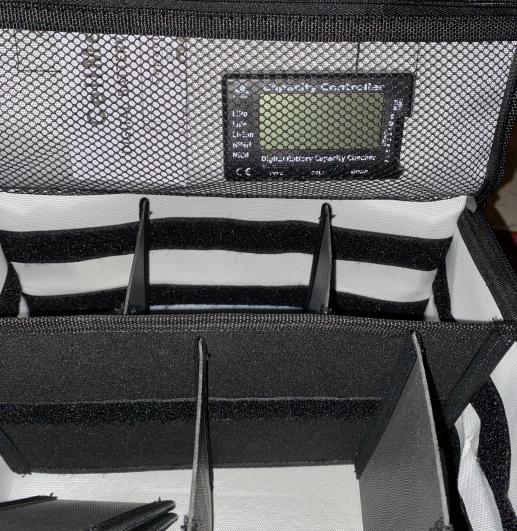

    After the battery fires in Georgia, I purchased a fire case. I’ll keep the batteries in it while charging. Made a believer out of me. Click image for larger version

    I just bought a metal ammo case for the same purpose, again... after the Georgia fires.
    I haven't had any issues with LiPos in probably a decade, ever since I started using a proper intelligent charger. My one and only fire was caused by those cheap Chinese chargers that Caswell used to sell with their batteries. f
    That said, $35 is a small investment in case that "once in a blue moon" thing happens....

        Ammo boxes and charging bags I'm sure are a big help but not a guarantee of safety. There are tons of test videos on youtube but here is a particularly scientific one:

            Two. Flames shout out of those batteries like a blue flame contest at a fraternity house party. I have no idea how mine blew. It was set for LiPo 3S and the correct voltage. It’s possible the “smart” charger didn’t shut down as it was supposed to. However, I charged several other batteries without incident. I do think that before the next sub regatta, some rules for charging should be in place. By the way, if you use any containers, be sure to keep the lid cracked, so it doesn’t create a bomb. Those metal ammo cans are air tight.

                I use ammo cans but remove the gasket in the lid.
