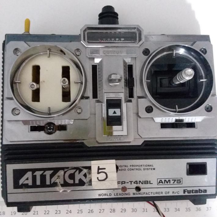

                Grab an old AM Nautical Commander, gut it, and put the boards from an FM, 75mHz transmitter in there. Wa-la, two throttle sticks.
                Not worth the effort in my opinion.

                  For some reason ACE transmitter is about $300 each.
                  Cutting up a old transmitter. Click image for larger version

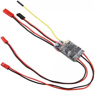

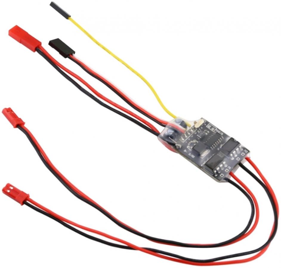

                      How about a dual motor ESC?Click image for larger version
                          I don't think that would work as that would make both motors go at the same speed.
                            Learn how to solder, Damnit! You can't solder, you got no business in this game of ours.
                            The goal is not to end up with two throttle sticks as that would be too difficult to run the boat (I only got two hands).
