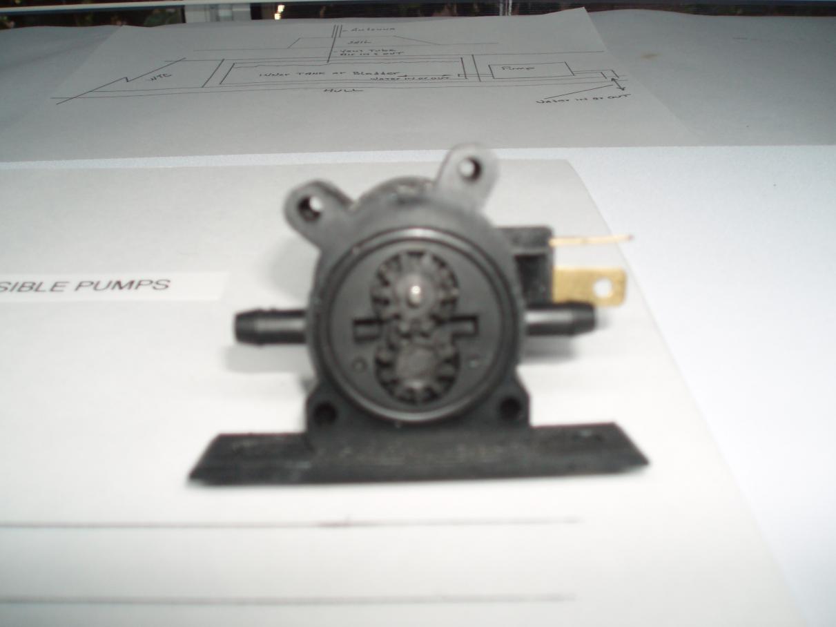

    Yes sir! Two 390-sized motors in parallel on one ESC. The motors are one size longer than the standard 380s, the ones I have are commonly used on 1/16 scale RC tanks, very torquey and plenty of power. The Sub10 ESCs are rated at 40A current I believe, so they should be able to handle the motors that you have. When in doubt, I always connect the pump motor terminals directly to the main battery with a multimeter. I then pump water into the sink and measure the current just be sure.

      The geared pump (Pumping water) was pulling 1.33 current amps at 7.2V power.

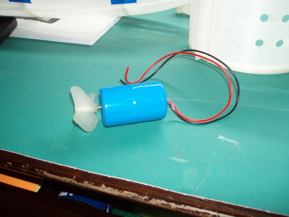

      The drive motor (not under load) was pulling 0.30 current amps at 7.2V power

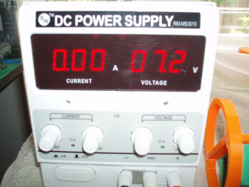

      This is the power supply unit that I used for the 7.2 Volts and to check the current amp draws on pump, drive motor, and the servos!
