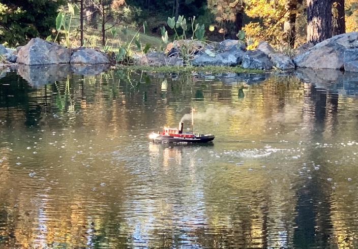

            After probably 20+ years of sitting on the shelf with it’s running gear removed and waiting for a upgraded refit, the harbor tug finally sails again. The 1400kv 1806 brushless motor coupled to the 22mm 4.75:1 planetary gear reduction runs very well with the 8000mah 7.4 2s LiPo pack. Lots of fine rpm adjustment down low and not overly too much top speed at full throttle when needed for emergency maneuvers.

              Looks good Nick. What are you using to produce the smoke?

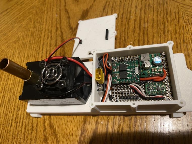

                Thanks Steve. It’s a small 6 volt commercially available smoke unit from Harbor Models out of Southern California.

                The black box unit on the left is the smoke generator. The electronic components on the right provide power and control of the smoke generator.

                    My experience with this particular unit has been very similar to yours. The reason the smoke is more visible in this photo is due to the way the sun light is illuminating it. The smoke is barely visible most of the time. This may be a result of the type of “smoke juice” that is recommended to be used with these units.

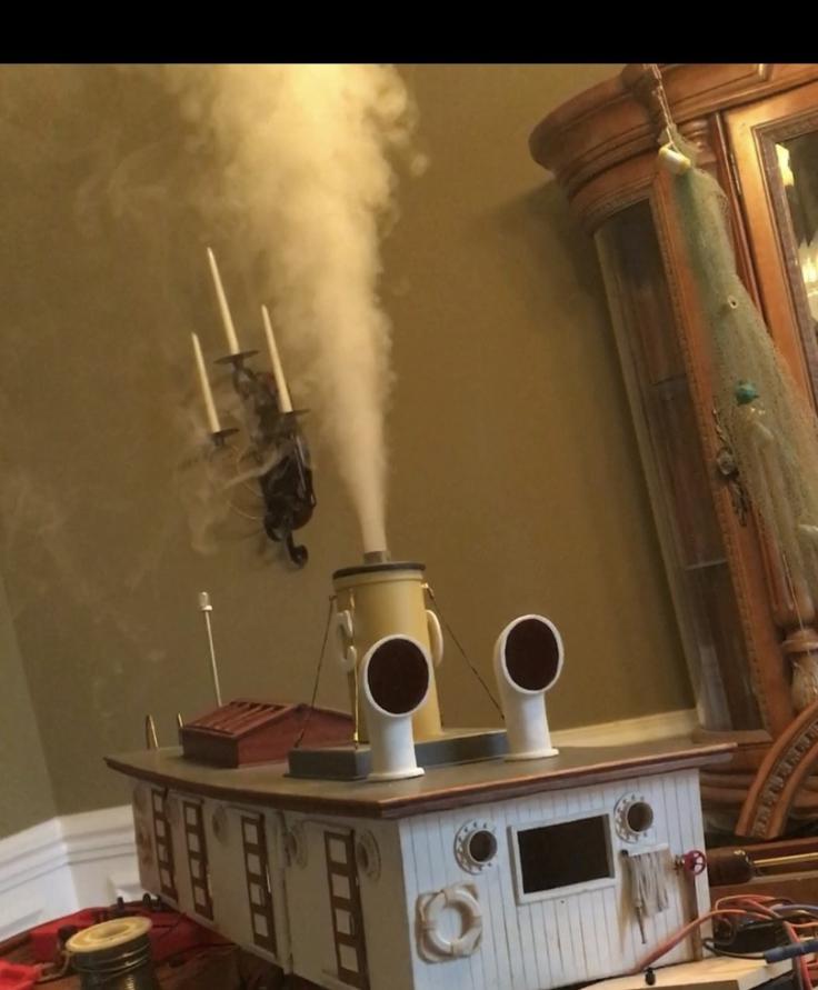

ID:	156025 Here is a still of my HM smoke unit. Works well.

                          Looks good Casey! Spill the beans. How did you make it?

                            Nice bunker boat cabin. Yeah spill the beans
