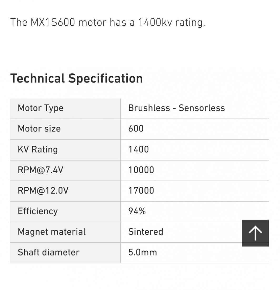

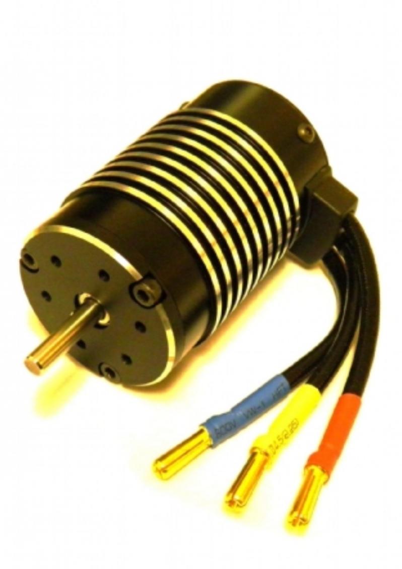

              Mtronicks.
ID:	155640Click image for larger version

                That's a whopper! What's that earmarked for?
                • SubDude
                  • 825
                  #38
                  Yeah, they are powerful but I run the Mtronicks G2 Hydra 50's in my 66" Nautilus, 1/72nd Columbia and soon to be completed 1/48th USS THRESHER. I like how they perform and run them in the wet. Dialing down the end points helps but it would be better if they had gear reduction of some kind even if I had to custom make something.
