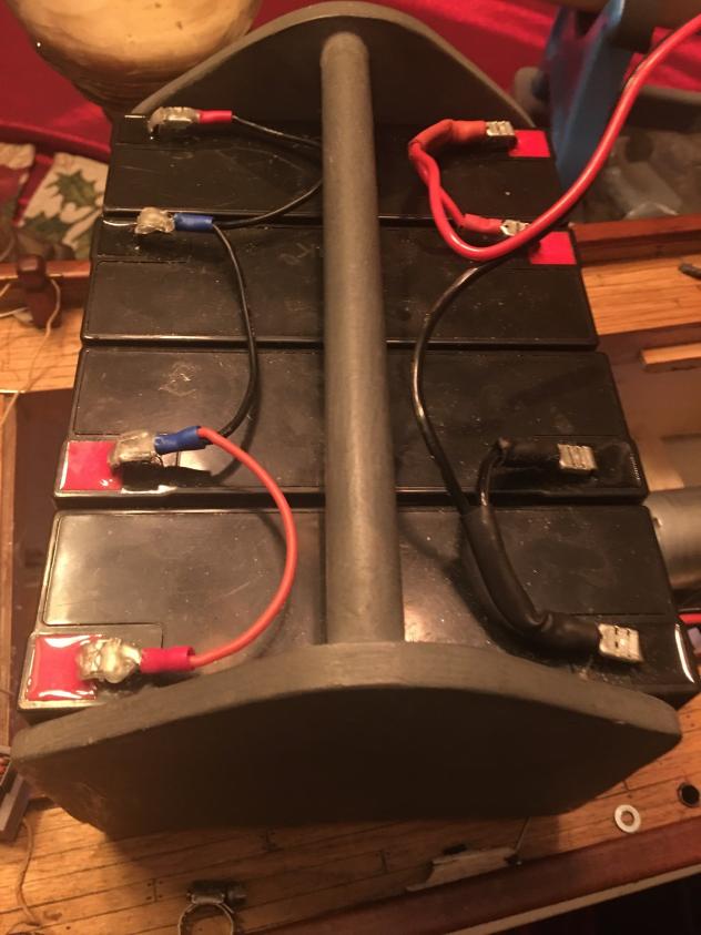

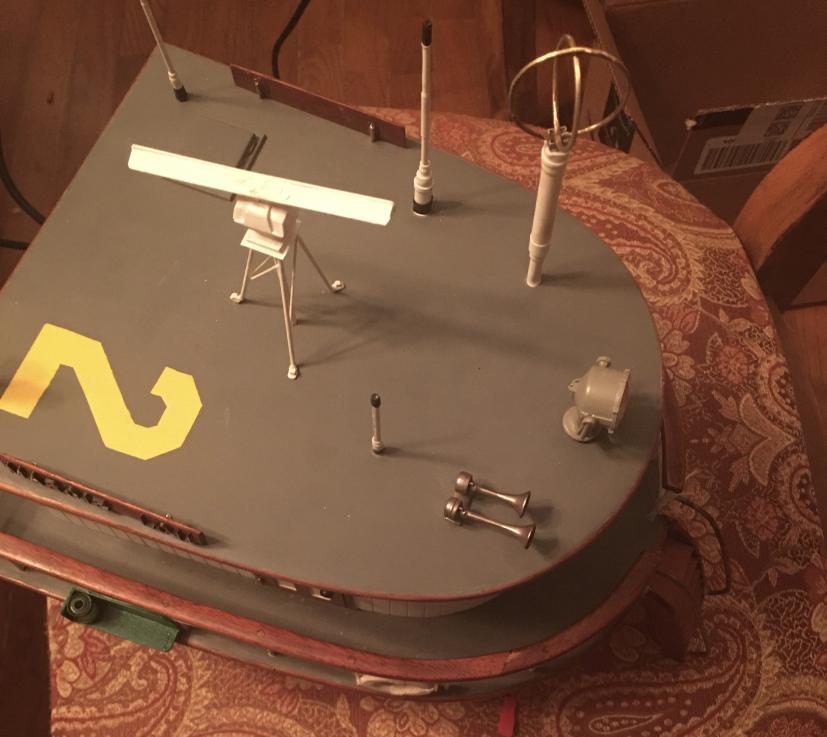

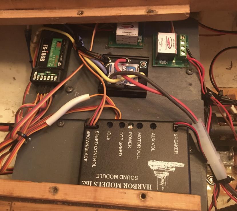

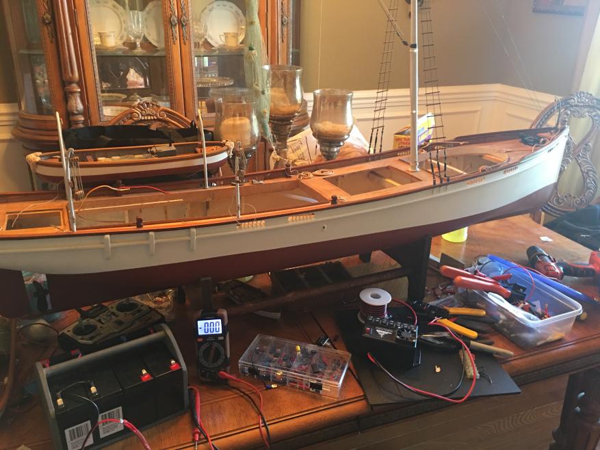

                        12v. I just replaced the batteries as one of them blew a cover. I got 4 Duracell 6 v to give it plenty of amps. I also made up a DF and VHF/UHF antennas. I took over the dining room table when I gutted her. My wife then made me take over an empty bedroom for my work area.
