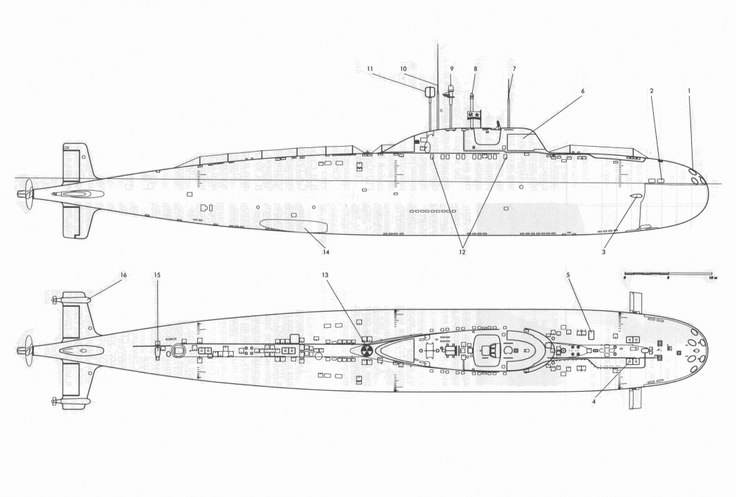

          Originally posted by rwtdiver
          I am still not understanding this!
          What is this waterline you are referring to? What are the waterline structures?
          Click image for larger version  Name:	ALFA Drawing.jpg Views:	0 Size:	56.6 KB ID:	152936
          Why can't someone build the boat, put in enough weight to get it to deck a wash, fill the ballast tank by pumping water in to get the boat to just the sail being above water line and move out? when you want to rise up you pump the water out and the boat rises to the deck a wash level again?
          Sorry David! It just seems you can just add an subtract weight to get a boat to a certain level in the water, and by pumping water in and out ballast tank you can fine tune that adjustment!
          "Crazy old man at work"

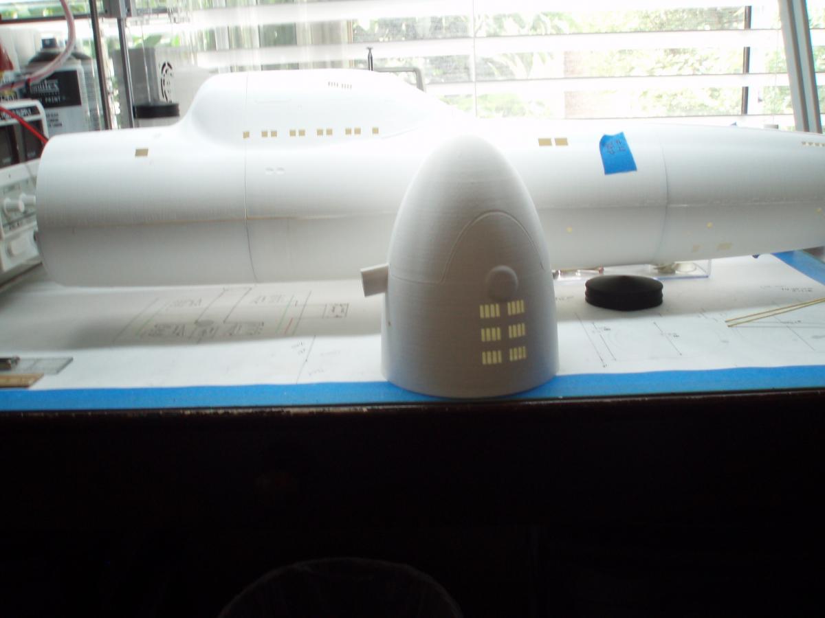

          WOW!
          I think everybody has just miss understood my complete question! That photo I put up of the 3D file printed Alfa came from the 3D file section of the Nautilus Drydocks! That line on the 3D file photo was the break point between the bottom hull and the top hull! I know the waterline on the Alfa is higher, I also have actual photos of the full scale boat!
          My actual question was: When you are weighing the boat to determine the size of the ballast system required, what are the items required inside the boat to determine that weight? WTC, motors, servos, electronics? That was my original question?

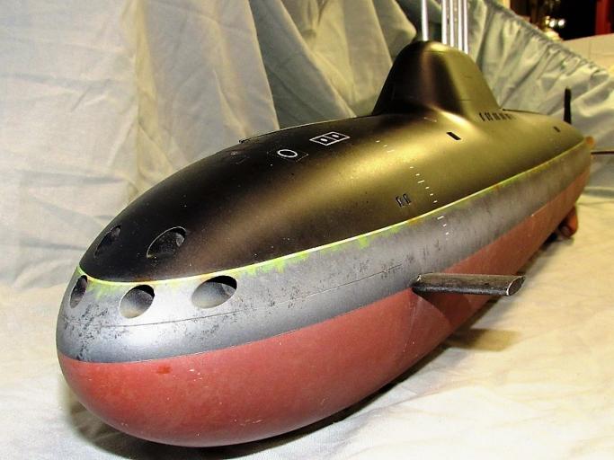

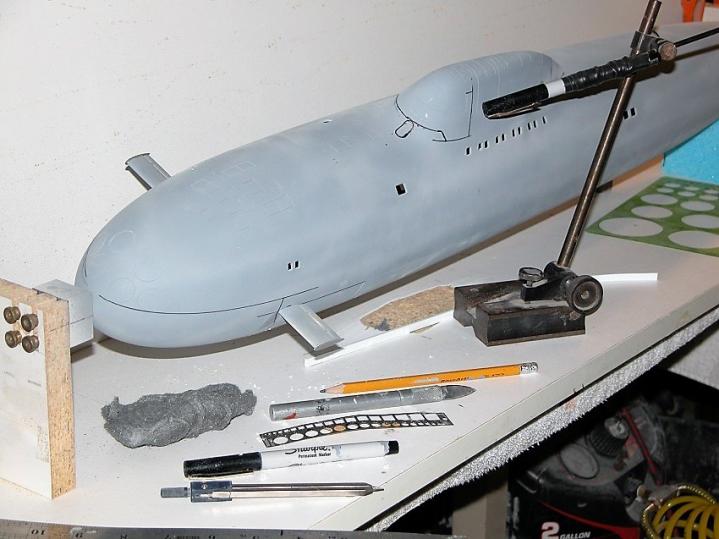

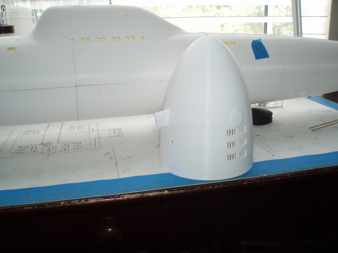

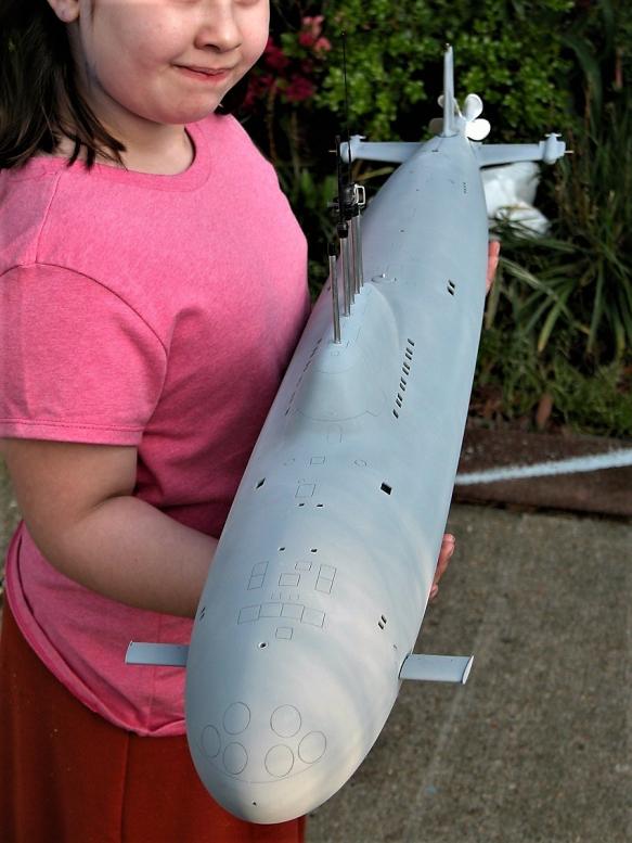

                They make a difference. A positive one, Rob. Once my ALFA is in proper submerged trim and the stern plane trimmed just right the only depth control I fiddle with is the bow planes.
                Click image for larger version  Name:	IMG_1641.JPG Views:	0 Size:	45.2 KB ID:	152964Click image for larger version  Name:	DSCN0022 (2).JPG Views:	0 Size:	51.1 KB ID:	152965Click image for larger version  Name:	DSCN0135 (2).JPG Views:	0 Size:	54.8 KB ID:	152966Click image for larger version  Name:	DSCN0165.JPG Views:	0 Size:	56.4 KB ID:	152967
                      Looking at your bow planes, they look a lot bigger! OK! What I will do is scale the file up and make them a little bigger and make them operational!
                      Thanks for your input and above all photos that show the size!
                      Also David! Are the bow planes tied into stern planes? Or on there own control servo and stick?

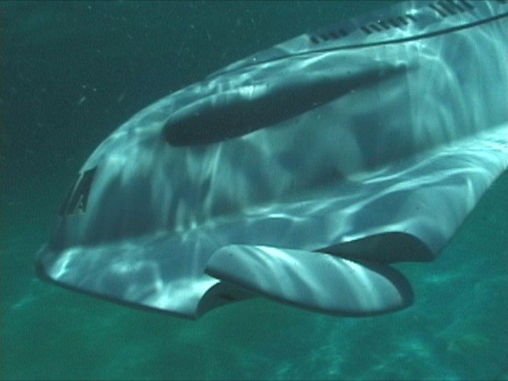

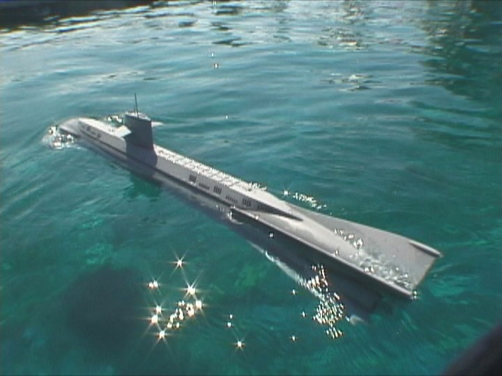

                        Don't know if they're out of scale, I worked the masters up according to the Greg Sharpe drawing.
                        Never gang the stern and bow planes together! (Well... one exception: the SEAVIEW, owing to the exceedingly long moment arm from bow planes to center-of-gravity).
