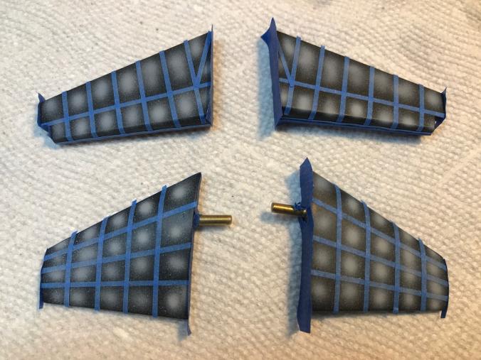

    First. Painted the lower sonar dome and gave both dome's a light over spray to soften the lines.
    Click image for larger version  Name:	IMG_4067.jpeg Views:	0 Size:	56.8 KB ID:	159796

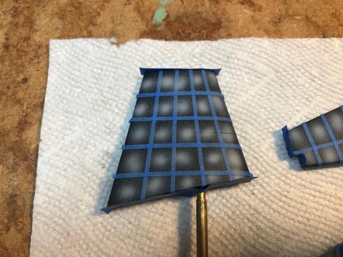

    Following the pattern I drew on paper, placed 1/16th strips of low tack tape in position.
    Click image for larger version  Name:	IMG_4051.jpeg Views:	0 Size:	58.5 KB ID:	159797
    Using the same paint I sprayed on the sonar domes, I gave a shot to the center of each squared off area. At first it was difficult to get the center with the airbrush, but after a few tries I got into the groove. I lowered the compressor pressure down to 10-15 psi as per David's procedure.
    Click image for larger version  Name:	IMG_4055.jpeg Views:	0 Size:	60.1 KB ID:	159800
    Click image for larger version  Name:	IMG_4056.jpeg Views:	0 Size:	57.8 KB ID:	159801
    Click image for larger version  Name:	IMG_4057.jpeg Views:	0 Size:	59.9 KB ID:	159799
    Click image for larger version  Name:	IMG_4058.jpeg Views:	0 Size:	57.1 KB ID:	159798
    I then sprayed the base color over the works to soften the effect. I started this over spray with the tape still in place, then removed the tape and gave it another over spray of the base color.
    Click image for larger version  Name:	IMG_4059.jpeg Views:	0 Size:	60.2 KB ID:	159802
    Click image for larger version  Name:	IMG_4060.jpeg Views:	0 Size:	57.8 KB ID:	159805
    Click image for larger version  Name:	IMG_4063.jpeg Views:	0 Size:	56.3 KB ID:	159804
    The following is the final appearance after the tape was removed and the final base coat over spray. I'll be spraying a light coat of flat clear to protect it all before I remove the rest of the masking.
    Click image for larger version  Name:	IMG_4065.jpeg Views:	0 Size:	53.4 KB ID:	159803
    Click image for larger version  Name:	IMG_4066.jpeg Views:	0 Size:	54.3 KB ID:	159806
    Click image for larger version  Name:	IMG_4069.jpeg Views:	0 Size:	56.8 KB ID:	159807
    Once the clear is applied, tomorrow, I'll tackle doing the lower rudder and underside of the aft dive planes, both red.
    I hope this looks right, as I do not want to have to do anything over!

      Your first real weathering effort. I make this observation: you, sir, are a quick study. Well done, Ken!
      Each new projects will see refinements of method, tools, mediums, and an ever more critical eye as to what our environment bestows on Man's creations over time; each new model will be better than the last. You are transitioning from toy-maker to model-maker.
      You are on a new path now. You no longer just stick things together. No. You are starting to emulate 'reality'. I too was an understudy and immersed myself in the work of my betters -- those men who took the time to teach and pass on the Craft. As I do today. Now, Ken, I deem you qualified to take the mantle of, 'teacher'.
      Go get 'em, Tiger! Fellow servant of the, Craft.
