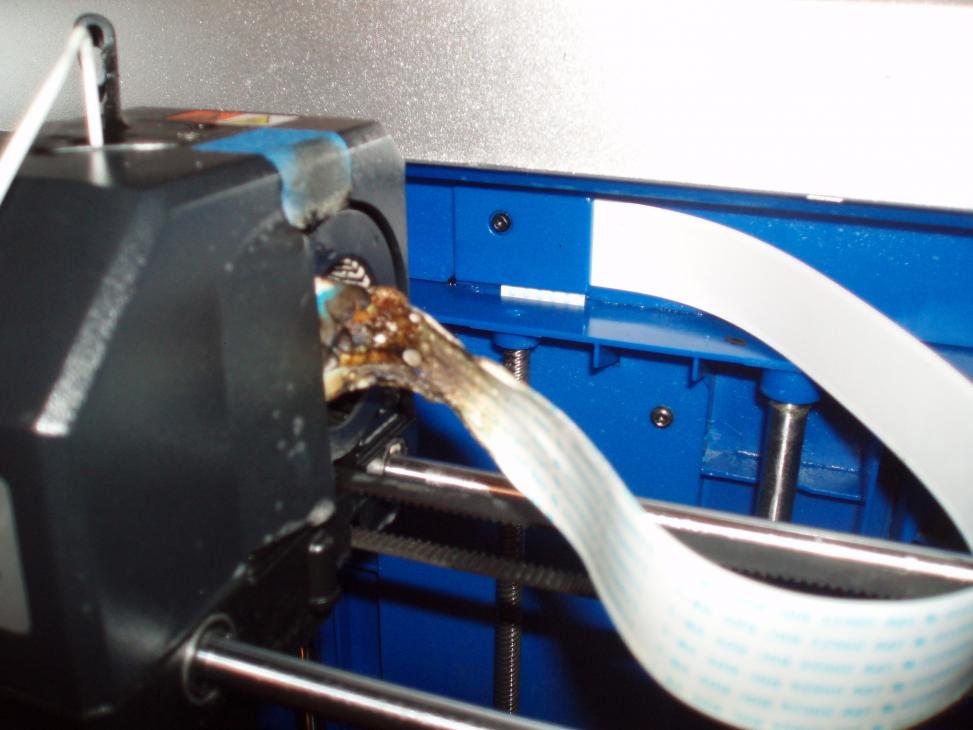

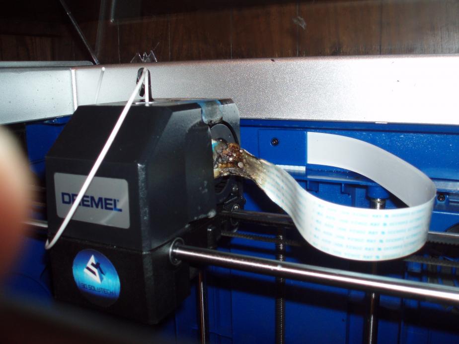

        I got my moneys worth on this Dremel 7 years and thousand of hours of printing!

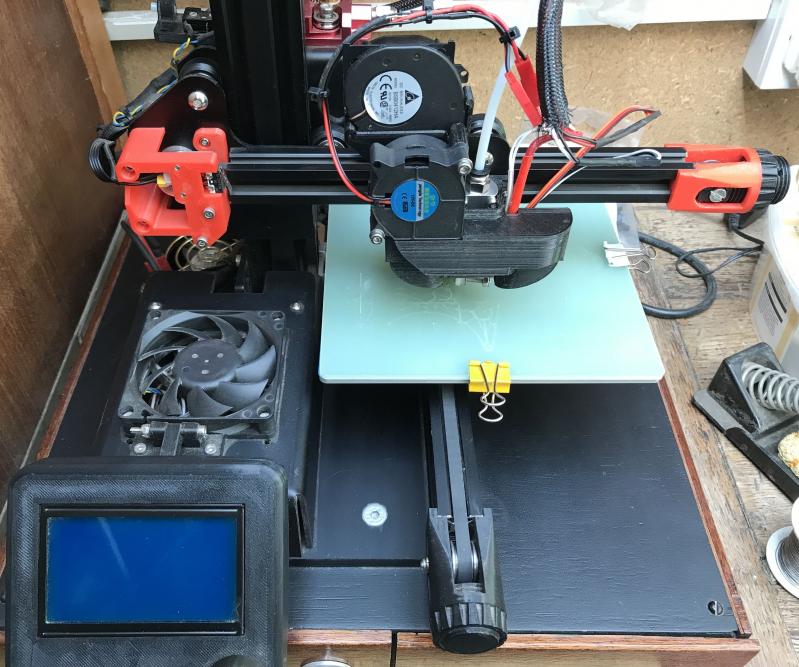

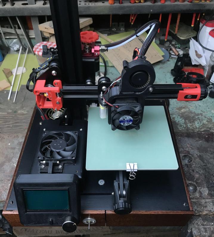

                      Very little mechanical work in any of that. it's mainly swapping out boards and tweaking the firmware. Most of mechanical bits were printed by the printer itself. This is how it's looked until the last couple of days-
                      However I've started experimenting with printing hotter filaments like ABS Petg and ASA, so made some adjustments to the cooling fans and fitted an all metal hot end. This design keeps drafts away from the hot end, and substituting the axial fan for a centrifugal version gives much better flow through the hot end heatsink. It also gives unrestricted access to the bowden tube at the hotend. Still have to make a bracket for the 3d touch sensor and tidy up the wiring.

                      • tifosi12
                        • Jul 2020
                        • 418
                        WOW. Very impressive.

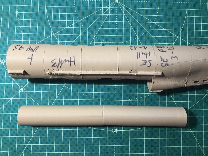

                              Here is a picture of my 1/24th model of the Seehund: The small tube below is the 2.5" SD. Above is the central and frontal section of the sub. So there is plenty of space for the SD.
                              Now I can edit the STL files to the point that they craddle the SD and also allow for an easy opening from above. I love doing this in this small scale, which brings down 3d print times (and materials) four times.
