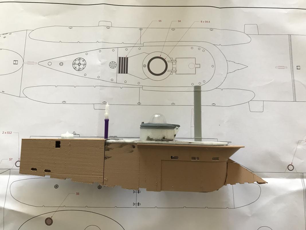

                I figured it was time to give an update on this project. The picture shows the 1/24 model I printed to figure out the dimensions to take off on the top to place the SD. The printing of the 1/12 segments is coming along, although with the usual hickups. I'm using every role of PLA I have, hence the Italian Tricolore. By the time I'll be done there will be more colors, might be more like the flag of South Africa.
                I'm sure Dave recognizes the SD. It was supposed to go into the XXIII but I abandoned that project. Hopefully this will be luckier.

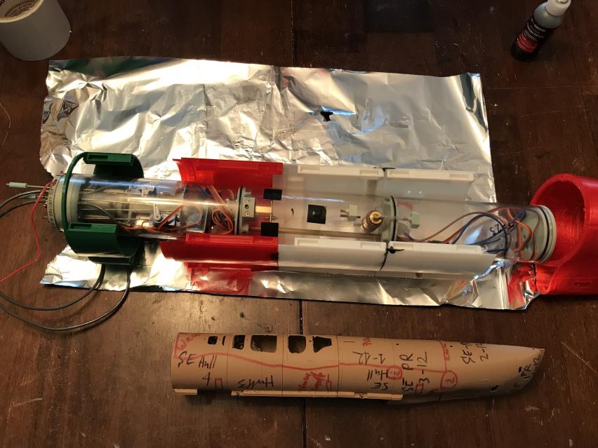

ID:	151015At the risk of shouting some more into an echo chamber, here is a further update:
                  Got now almost all parts of the boat printed. Started to glue together the hull and it's starting to look good. Conning tower assembled and painted. Next up will be the critical bits of engineering some solution to access the business end of the boat. I don't like Oto's approach with tiny screws and nuts. I'm not a brain surgeon and my hands don't fit into any of those nooks and crannies to tighten those bolts. So CA it is instead. Which then leaves me figuring out a way to service the boat. My only redeeming quality is that I'm fairly good at the 3D CAD design and printing by now so I'm hopeful to come up with a tangible solution.
                  Below a picture of the conning tower before painting. Meanwhile I also replaced those "snorkels" with something more elegant and to scale.
