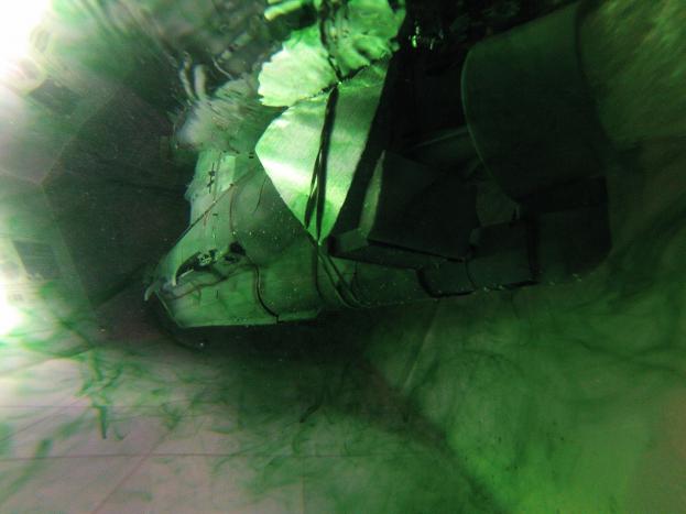

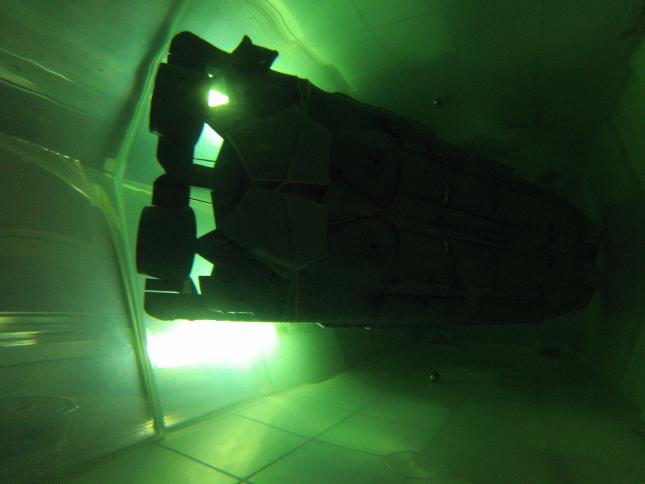

                Finally it was time for some tank trial. Had a leak in the SD and an electrical loss to fight recently, but finally it was all ready for some buoyancy tests. Went fairly well. The "rudder" of this thing is phenomenal, it looks like the book could turn on a dime, it is so effective. Forward speed is also decent, well, at least without the torpedoes. Dives nicely, as far I can tell from such a limited experience as this.
                  Haven't quite figured out the picture thing on this forum. So here another shot of the sub just floating in the tank. The green color is food color for Easter eggs. I like to add it to the tank for some effect. :)
                  Obviously where the image is mirrored is the water level.

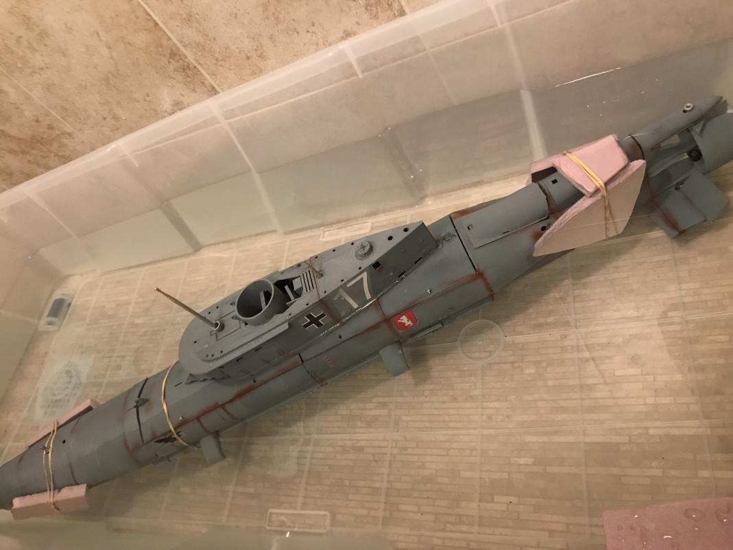

                          #42
                          I think I am being thrown off by the tiles visible on the bottom of it.
                          No tiles. Those are the plastic stripes at the bottom of the container to give it strength. It becomes more obvious in this shot, which clearly lacks Hollywood magic :)Click image for larger version

                                #45
                                Nice looking boat by the way. I like the paint job.
