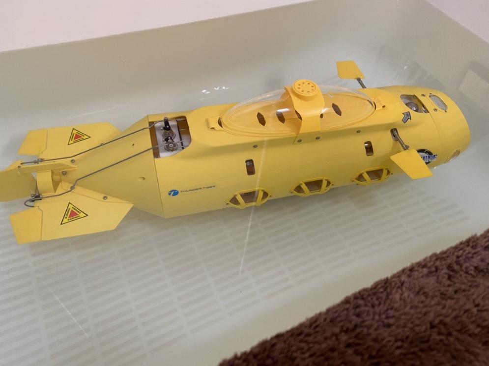

          Just dunked mine for the first time. Does this look correct for the Neptune?
            So, on mine, the bag is almost completely empty and it sinks. I want a lot of buoyant force if I need it.
            • Monahan Steam Models
              • Apr 2020
              • 755
              Did you mean with the bag is almost completely full it sinks? The photo I took is with a empty bag.
              • Sinksalot
                • Mar 2020
                • 365
                Bob took one of the heavy weights off the sub that are on the bottom of the sub. That is why his rides higher out of the water
                  Sorry, yes.

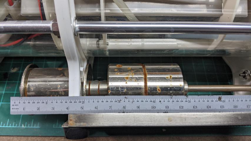

                          Would it be a problem for you to take a photo of the weights and where they are located on your Neptune, and post them up! Thanks Ed!
                          "Firemen can stand the heat"
                          Sorry it took so long, WAY to many irons in the fire!
                          FORWARD (Bow) is to the left.
                          v/r "Sub" Ed
                            Ed,
                            Thank you very much for the great photo of your Neptune ballast weights! This will help give me a starting point to work from, and most likely it will be the same as yours!
                            Thanks again Ed, for taking the time to do the photo for me!

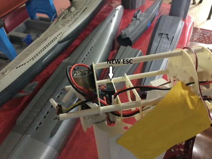

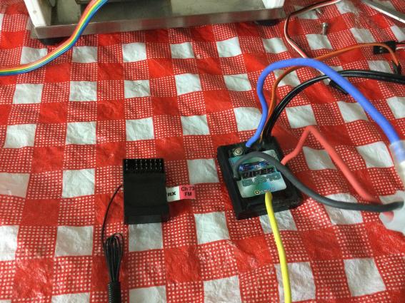

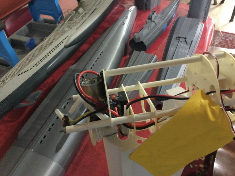

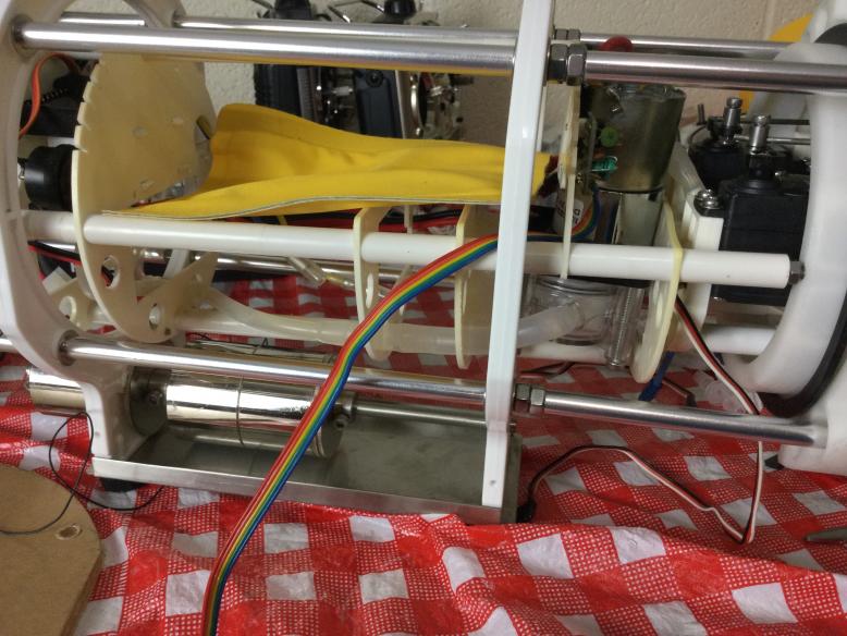

                                I had a problem with the Ballast controller that came with Neptune. It wasn't working, so I took it off and looked at it closely. I saw one of the solder points had no solder, it must have dropped off. So I solder the pin back on and remelted all the solder on the other spots to make sure the rest were on good. I retried the ballast controller again, this time it worked perfectly. I also replace the 40mhz receiver with a new micro 6 channel 75mhz receiver and I replace the old ESC with a SUB10 ESC.
                                Click image for larger version  Name:	IMG_0833a.jpg Views:	0 Size:	64.0 KB ID:	150342
