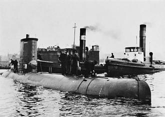

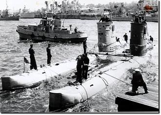

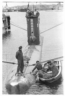

      No wooden deck?
        • 1651
        #948
        Nope, is only used when in harbour during mantenance or loading, probably stored in harbour to be used on different boats, as it has standard measures queal to each type XXIII.

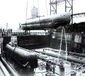

                                Even comes in singles (limber hole).
