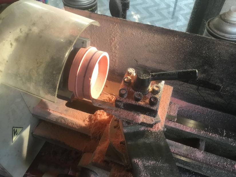

                Hello David,
                I have machined up some renshape endcaps. I am currently thinking about how tight the fit should be for the section ( with the o-rings) that fits inside the tube. Do you machine the diameter such that it is a tight friction fit or do you have a tiny gap / difference with the O- rings making up the difference and providing the press fit.
                I suppose another way of asking is how much depth do you create for the O-ring groove? Is the depth of the groove about equal to the radius of the O-ring? As I have mentioned to you, I intend on making my endcaps the way you do. What shrinkage factors if any should I consider? Would there be any with the urethane moulds. I haven’t encountered it with my appendage parts moulds...yet.
                I hope this makes sense..

                      I machine my endcaps from sheet stock plastic (PVC, polycarbonate and acrylic/pmma all work well), or use aluminium for bayonet rings. I rarely make more than one of anything, so there is little logic in casting unless I need extra features within the endcap.
                      However if I went this route I wouldn't cast a groove into endcaps. I would just make a simple blank without the groove, and machine that in later, also leave enough meat on the part to allow for inconsistencies in the inside tube diameter- which can vary greatly,-and machine the part down to fit. With regards to groove depth I tend to work between 10-15% of o-ring cross section, depending on how accurate the tube is. Technical literature will often specify up to 25% squish, well I personally find that is too much and you'll have a fine time trying to remove your caps. Bear in mind that o-rings can be used in systems running hundreds of pounds of pressure, whereas we might be dealing with half an atmosphere at most.
                      I tend to use 3mm (1/8") o-rings for most cylinders, but for sizes below say 50mm (2") I drop down to 2mm or less. I use nitrile and silicone o-rings, the latter tend to be a little bit softer, and don't degrade in the sunshine. I find nitrile works just fine, it's stronger and is a bit cheaper. Avoid exotics like Viton, EPDM etc. Overkill and much more expensive.
                      One thing worth noting, if you have the room to do it, making the outer edge of endcap a bit bigger than the cylinder diameter will provide a nice piece to grip when removing the cap. Adding a knurled finish on the same edge will further improve grip. I'd also keep the edge as thick as possible, as PU resin tends to be quite brittle unless reinforced with glass or carbon fibre. All quite easy to integrate into a rubber tool.

                          #162
                          Thanks everyone,
                          I did’nt know about those videos. Very good. I have made plenty of cylinders before and machined numerous endcaps. I just wasn’t sure about whether I needed to consider shrinkage of the polyurethane at all. I am casting these endcaps because I want to go into limited production to produce a cylinder that will integrate into my kits.
                          Thanks once again.

                            Polyurethane resin typically has very low shrinkage, unlike polyester resins which have very high shrinkage. I would estimate no more than 1-5% depending on thickness, cure time, and whether you add any filler in the resin e.g. glass, carbon fibre etc.

                              You cast your bulkhead radial flange over-size to the biggest diameter stock you can find (a stated diameter is one thing, the tolerance the manufacturer employs is another). And you don't cut it down to size and incorporate the O-ring grooves till you identify the specific cylinder the bulkhead is going into.
                              No getting around this, Lexan cylinder tolerances are so wide you just can't simply cast a one-size-fits-all complete bulkhead. Each bulkhead has to be lathe turned to fit.
