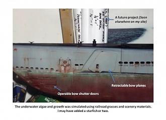

    Ever tried using static grass or flocking to simulate thick algal growth?
      • 13984
      #1772
      Yup. This Small World Models 1/96 TRENCHANT.

        These are all incredible! I may have missed it somewhere in the 119 pages, but how well does the flocking hold up on the “hula skirt”, or is the Trenchant a static model?
          • 13984
          #1774
          My TRENCHANT is an r/c model submarine. The only water-time so far is in the test tank, no underway time yet. But it will hold up. I learned this trick from the Master himself, Gene Berger, and his big GATO has been cruising around for decades with no apparent failure of the adhesive holding the 'grass' in place.

              I did not realize Gene used flocking as algae.
                #1777
