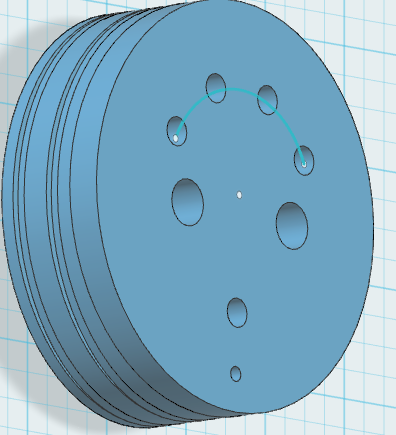

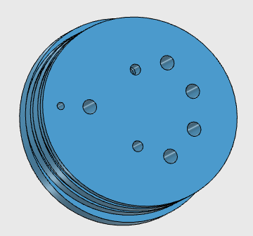

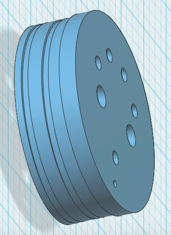

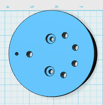

                I've been tinkering with Autodesk 123D Design CAD drawing program for a few days, and I decided to experiment with a D&E 3.5 twin Motor Bulkhead. I made several thin disks to replicate the slices through the endcap then 'glued them all together and finally punched the holes in. There are some internal parts not in this drawing that I omitted, mainly because I didn't want to tear the original apart. David is sending me some blanks and I'll upgrade these features later. The main concern with 3D printing these caps is that the Lexan tube varies in internal diameter, so David has to machine each one individually I think I can do that in the CAD drawing and then print the caps off to the exact dimension required.
                All I need now is a printer. Any suggestions? Click image for larger version

                  If you have enough of a channel to give the o-ring a good smoosh, I think that would cover any variations in inner diameter variances.
                    It’s a good Idea....but please keep in mind that when you scale your 3D design to the right diameter, you will scale every part of your 3d design, the holes to take the pushrods, the holes for the main shaft, the overall thickness of your design,.......you will have an offset of your entire design, smaller or larger.
                      When I've discussed this with HWSNBN, he was almost adamant that he has to machine each end cap to suit the Lexan, due to a wide variety of ID in the manufacture process. It seems they are concerned with OD dimensions not ID.
                      When I 'assemble' the disks in 123D, I can alter the ones where the O Ring sits quite easily, but the problem could be that the rest of the disks would be too tight in the cylinder.. I guess this is a project that needs some trials. Maybe an assortment of O rings could cure the variations? I like the idea of a thin ring that is glued into the end of the tube, and this standardizes the dimension, the slack taken up by silicone adhesive. All the end caps would then fit the ring.
                        Grtz,
                        Bart
                        I can scale the individual disks before I 'assemble' the components. Actually 'scale' is the wrong term, I 'alter' the dimension of the O ring disks. Finally, I 'punch' the holes in, so this won't be a problem. Easy to do!
