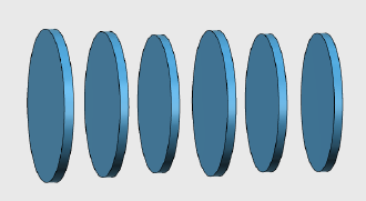

      Okay. Well if I was going to print an endcap, I would design it very differently to the one you've shown, as it makes very little use of the advantages of printing versus machining from sheet stock or casting. I would make the endcap hemispherical or ellipsoid, to thin it out and retain best strength, or if it has to be flat I would honeycomb the centre section. This will give the same strength as solid, but hugely reduce print time and material used, and should produce less shrinkage in the part as it cools off. I'd also look at integrating shaft seals in the printed cap as far as practicable.

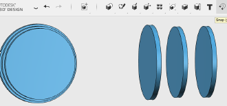

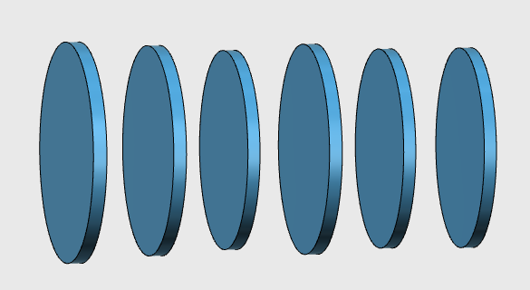

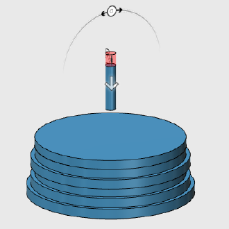

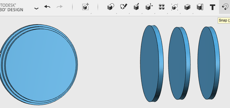

        The reason I used disks in the program, is that it seemed the simplest way to step the various dimensions. Using the SNAP tool, brings them all together.

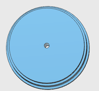

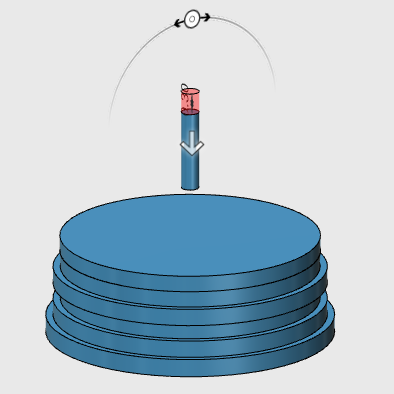

        I think folks are misconstruing my intent here. I am not doing this to produce endcaps for my use, or for anyone else. I have dozens of Mr. Merriman's molds and I can churn out any size endcap in a flash, if I wanted one. I also have plenty of seals, already made. As for building seals into the actual cap, I think that would be a folly, because if the seal failed, surely it would be impossible to replace it. With seals in their own housing, Merriman seals can easily be replaced, simply glued in place with silicone. Therefore, I only need to punch the holes using the EXTRUDE tool in negative to pull the hole through the solid.
        Here's the hole punch - I snapped it to the center of the disk.

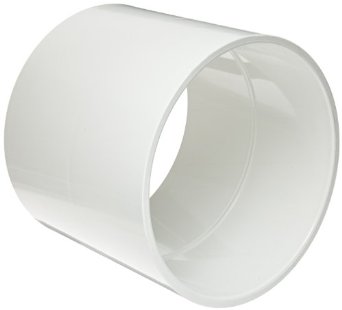

              Since it is said the outside dimension of the pipes is kept at close tolerance why not make a coupling type piece that silicone glues to the outside of tube.
              Then the inside of the coupling that accepts the end cap can be molded/machined to keep close tolerances.

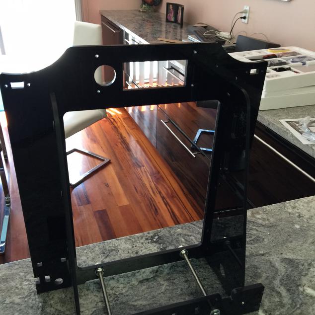

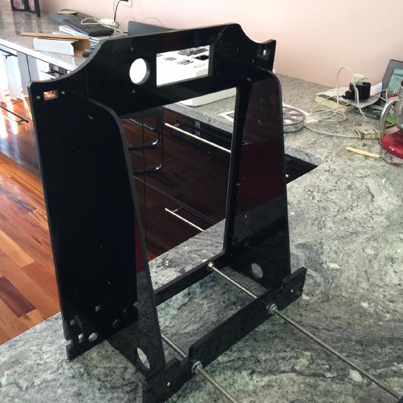

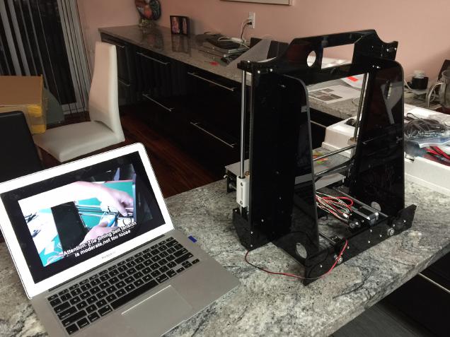

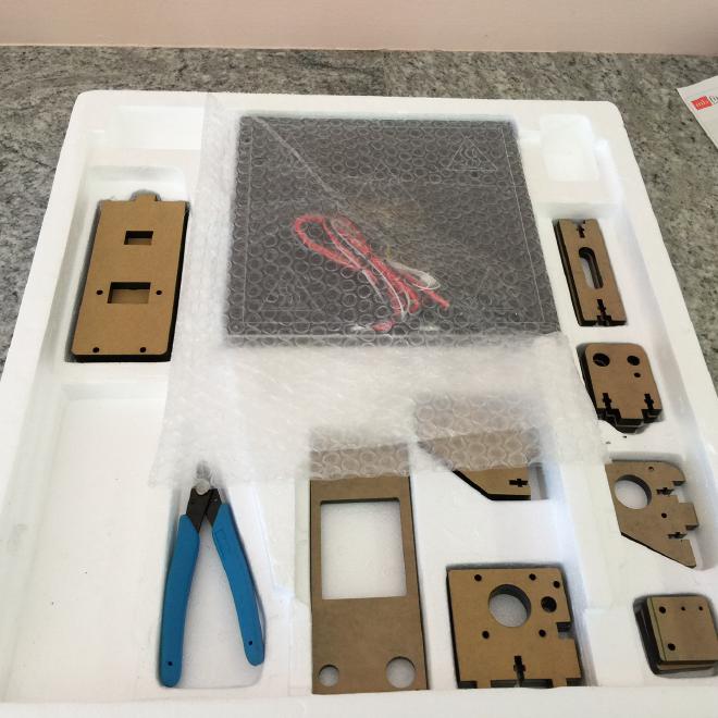

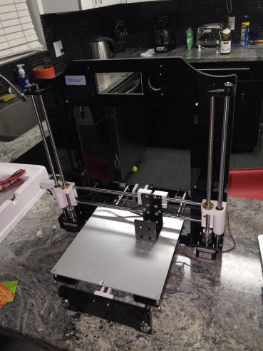

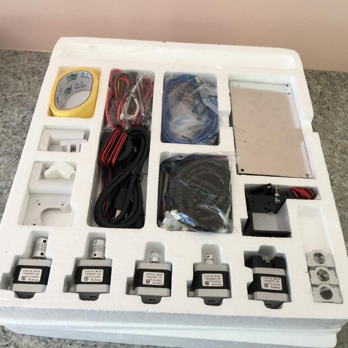

                    My 3D printer kit eventually turned up today. I think the hurricane on the east coast messed them up because my package was due last Friday, but turned up today. I was hoping I'd be able to spend the weekend setting it up.
                    Anyhow, it's here and today I started putting it together. Click image for larger version

                    The parts are all precision cut and fit perfectly. I was immediately impressed with the packaging, and all the black parts are 1/4" thick acrylic sheet, even coated in paper to protect the parts. Actually the most difficult part is removing the paper - so far.
                    The stepping motors look extremely well made and I'm confident I'll have the machine assembled in quick time. My worry is the wiring, but if the videos supplied show how that is done, then I should be fine. So far I'm impressed with the videos.
                    I've even got my wife excited about this gizmo. She usually rolls her eyes when I mention submarines and models, so there's hope yet! I've even been allowed to do this in the kitchen! (My workshop is a disaster lately)
                      AND -- this kit cost $215 including shipping from China. I think the Chinese don't care whether they make a profit or not as long as they extract money from our economy. No wonder we have such a deficit.

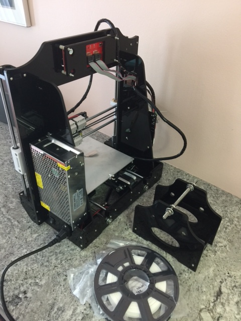

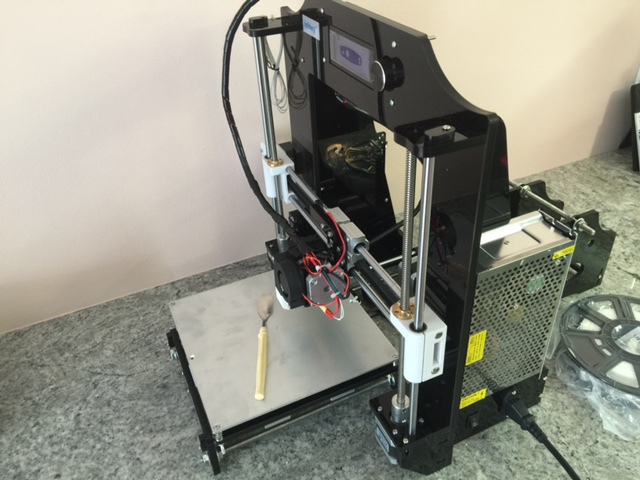

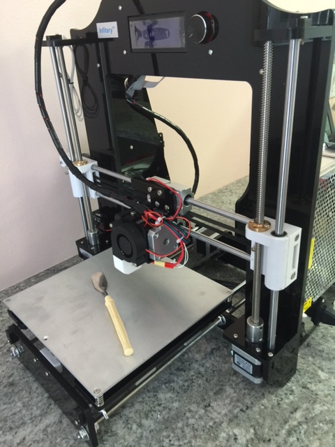

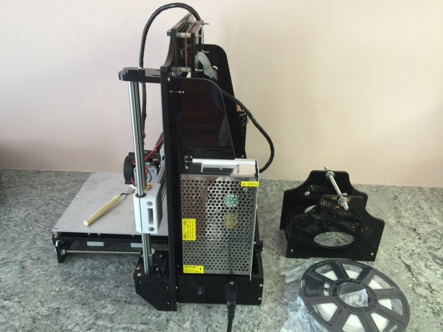

                        I've actually finished assembling the kit, and no shortages, everything fits and it was a fairly pleasant experience. The videos helped a lot and were on a small card. All the tools were also supplied. All I have to do now is read the flippin' manual and plug it in. Click image for larger version

                        I'm really impressed with the quality of the parts, and the precision everything went together. Maybe tomorrow I'll fire it up!
                          My first attempt at printing wasn't so good. I ended up with a load of vermicelli strings, not bonded to each other. It looked a little like a fishing net lattice. So, I've obviously got something wrong. Perhaps the extruder head isn't hot enough, or it is too far away from the bed. Maybe even a bit of both?
                            • 3767
                            Many 3D printers will want you to put something down to help stick those first few layers. Many people use Blue Painters masking tape. You are correct about not getting close enough to the bed can also create a mess. Did any of the base print? If so, I would lean to laying down a layer of tape.
                              The kit had tape, and I covered the platen with it, so it wasn't that. I'll give it another go tomorrow.
