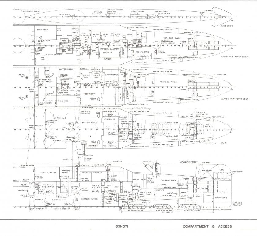

                      #70
                      Found something ... might be of general interest. Unfortunately couldn't find the stern section of this.
