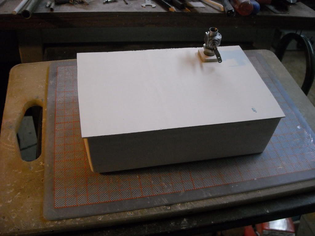

                    • oztruck
                      • May 2010
                      • 317
                      #40
                      • Slats
                        • 1776
                        #41
                        I like your thinking.
                        Could you not eliminate the T pieces by having two outlets atop the ballast tank - one for the venting pump / one for the air in pump?
                        J
                        sigpic
                        • oztruck
                          • May 2010
                          • 317
                          #42
                          I guess so John. I was thinking along the lines of less is more, the less holes we have to seal in the WTC the more reliable it is going to be. Because 99% of the time they will be pumping air a big failure at one of the "T"'s is not as bad as water getting in.
