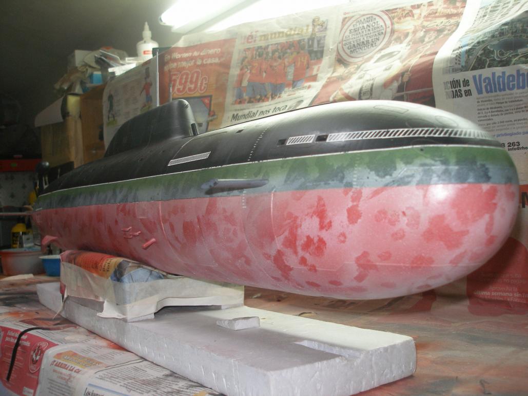

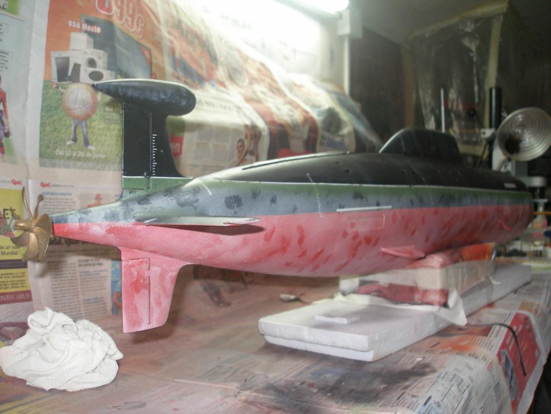

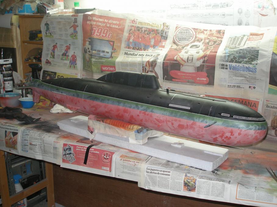

            I've finished an AKULA II. The hull is painted and with decals applied, and now I'm thinking about weathering it a bit, just enough to make her looking real. Some pictures I've examinated seems to offer a submarine which hull doesn't has much effects of weathering, at least as it seems at medium distance. The hull is also streamlined and with few protrudes. Any suggestion?

              A light mist of lightened base-color below the waterline, with a hint of green from waterline to about three feet below waterline.

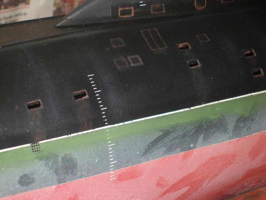

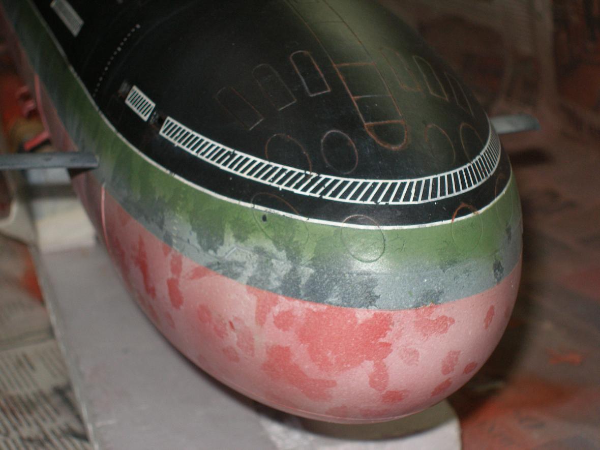

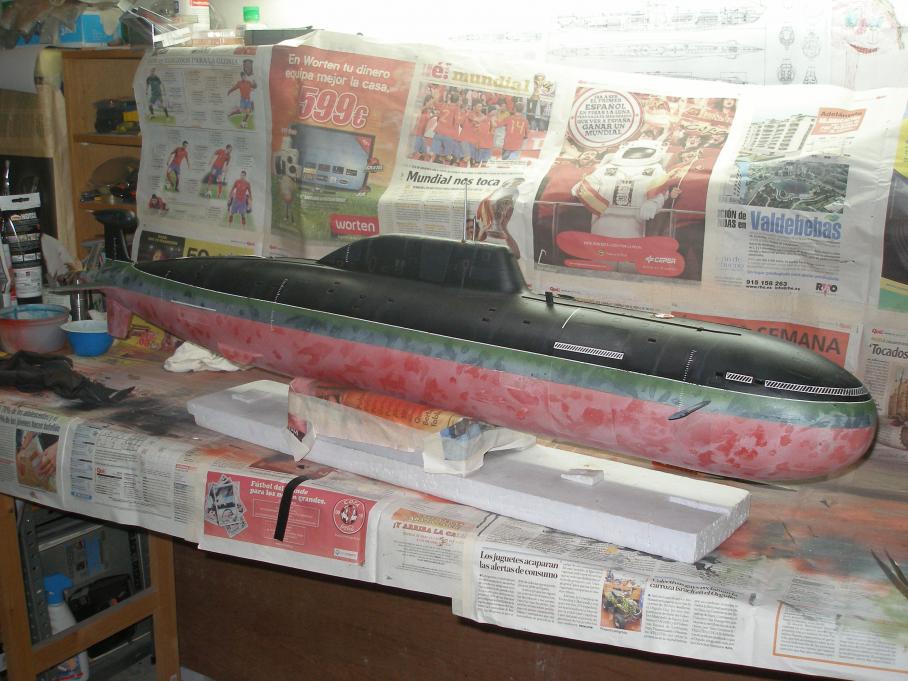

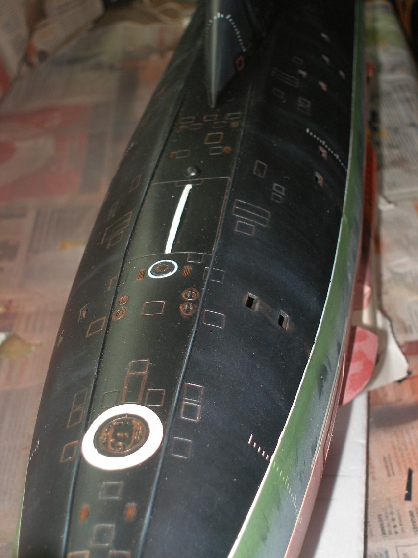

                Here's the result. Looks like needs an urgent dry docking. It's the first time I use tooth paste technique so, please, be indulgent.

                  The location of the rust is fine, but too much -- tone it down a bit with the base color.
                  The tooth-paste was not applied with a stippling action of a stiff brush, you literally painted it on. but the eventual degree of below-waterline bleaching is perfect.
                  Damned good attempt!

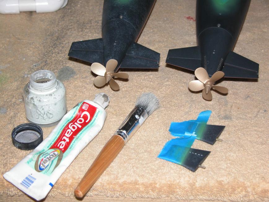

                    Roger on that and thank you very much. I'll improve the "bleaching" technique on my next hull (Rick's 1/72, when arrives). Any suggestion for stippling?
                    Juan Carlos.
                      • 14012
                      Juan,

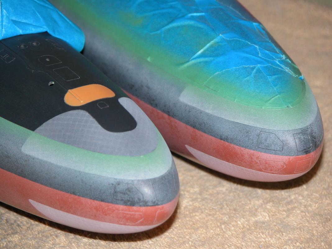

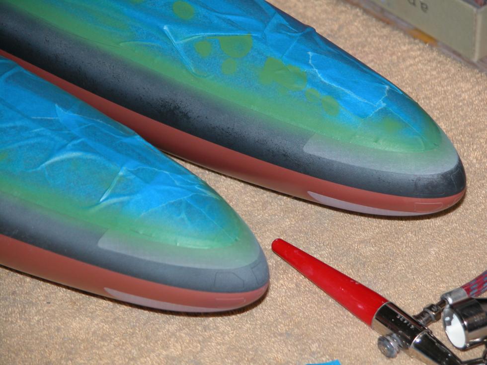

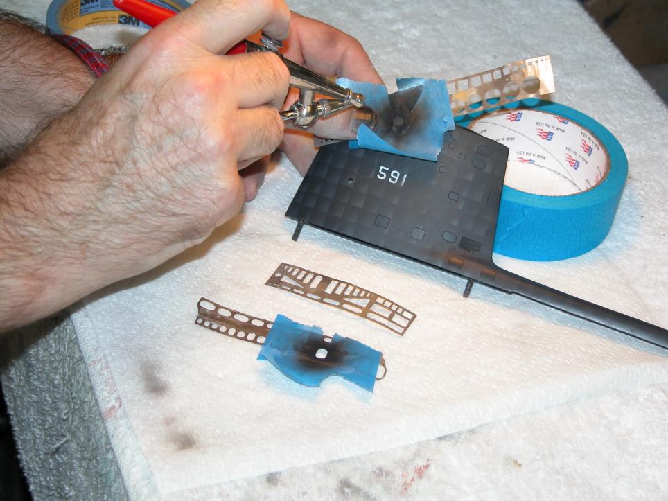

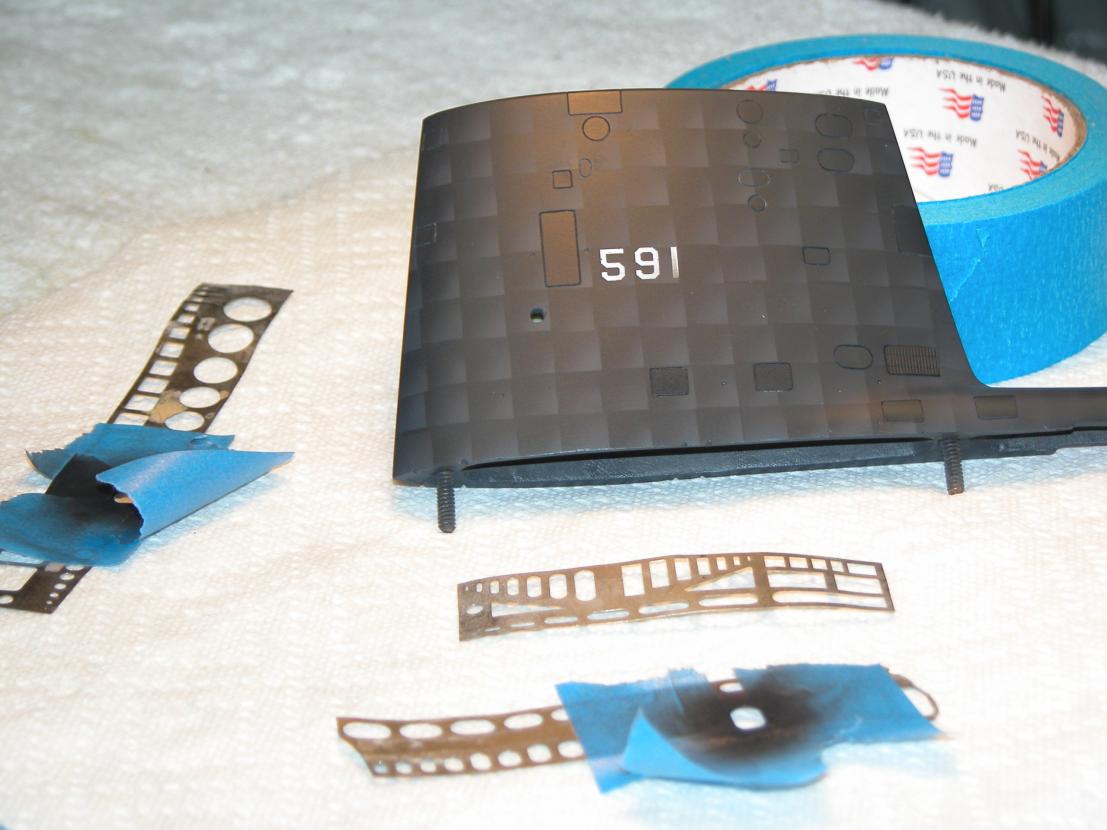

                      Stippling is the action of holding a stiff, semi-pointed brush at a right-angle to the work, and applying a quick up/down motion to transfer little uneven dots of medium to the work. In this case, laying down a masking agent: tooth-past, syrup, PVA, whatever can be easily removed later. The key is using a rather large, pointed, round, stiff brush and loading it with the minimum of medium -- and to practice the technique off-model -- only committing the operation to the model once you get it right!
                      Not to be a smart-ass here, but there really are 'stippling brushes', sometimes called 'stencil brushes'. Art supply and stationary stores carry 'em. Below is a shot of just such a stencil brush ready to dab on little flecks of wet tooth-paste onto the below waterlines portions of these two 1/96 SKIPJACK kits, and what the desired 'speckled' appearance should be after you lay down the bleaching and rub off the water-soluble tooth-paste with a damp cloth.

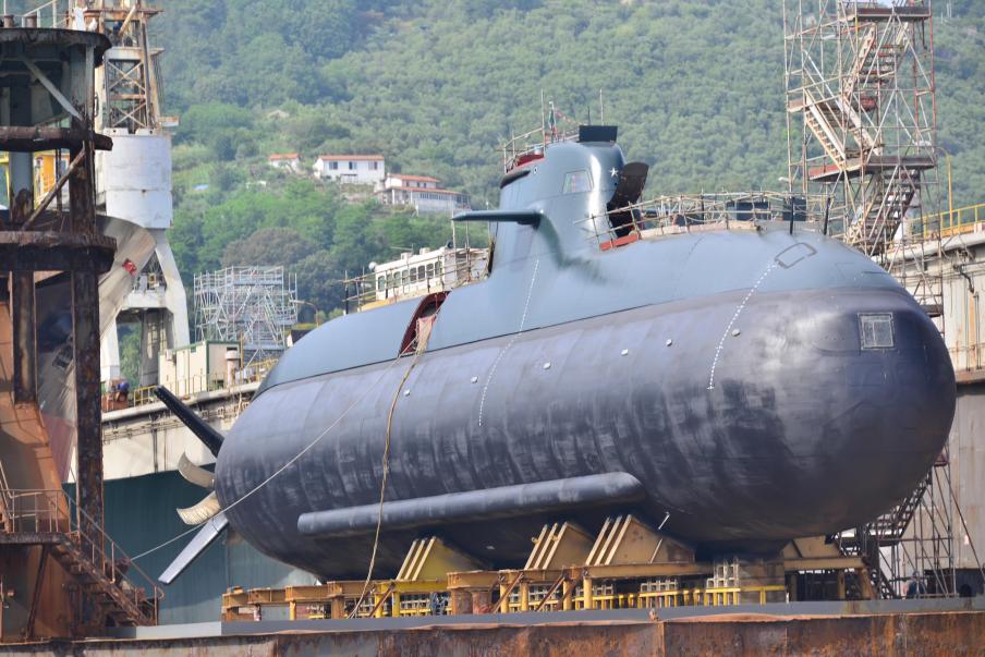

                              An excellent and unusual photo which may interest those following David’s invaluable thread (thank you David).
