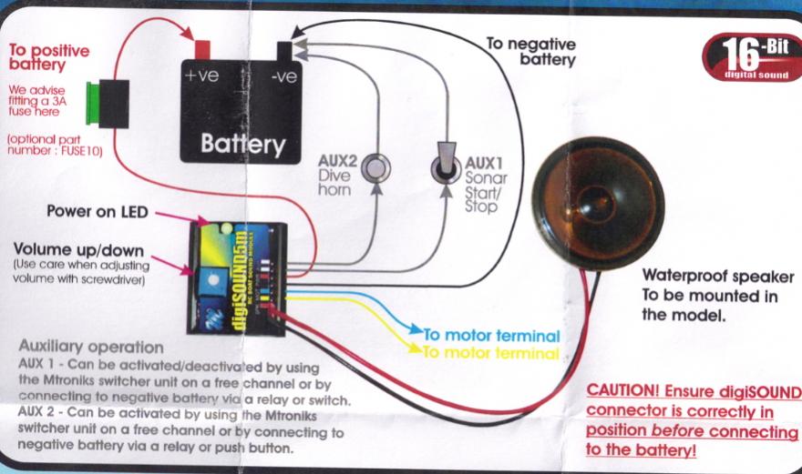

    I've just received a sampling of the Mtroniks sound module for submarines. Although I haven't completely rigged it up in a boat and run it underwater, I have done a bench test (dining room table actually -another bollocking for that too!)
    I placed the speaker in a jar of water and ran the dive, sequence, and it worked just fine. Of course, the sound was very muffled underwater, but as soon as it surfaced, it was loud and clear. Try doing that with an ordinary speaker and the paper middle would fall out in no time.
    I have a call in to Steve at Mtroniks for a little help with the pinger, but aside from that, this looks like a winner.
    The speaker is about 2" diameter, so this puppy won't fit in the smaller boats. The electronics box is about the size of an Mtroniks Speed Controller.
    Here are the instructions.

    I see wires going to the motor terminals. Does this thing make diesel sound too?

        So, you want 'dive,dive,dive', 'ping, ping' AND klunky diesel noises too?
        I can also arrange for flushing head noises if you like! Good grief- they're never satisfied! Seriously, I don't know why those leads go to the motors. I'm inquiring as we speak!

              It seems that I need to wire up the motors to the unit. Then we will have the sound of engines revving up as we speed up the motors.
              Damn! This could be good! Tomorrow, I'll hook it to a sub-driver!

                  So ive found this old thread that david had asked the same question that i am now with the diesel engines. Did anyone ever figure out if this module has the engine sounds?

                        @kazzer: i believe you were the last to experiment with this sound module. Did you ever find out if engine sounds are part of this package?

                            Ok, now i haven't received an official answer from anyone on either of the sites (www.sub-driver.com nor www.mtroniks.net); but from my trials this is what I know. There isn't any engine sound only dive and ping. When one attaches the motor terminals and applies throttle (and if the ping is turned on) one will here the ping becoming more higher in pitch. When the throttle is reduced the ping returns back to normal. Same happens when going in reverse. So, long story short; if you're hoping for diesel sounds this isn't your module; but the ping and dive sounds are very cool.
                            Furthermore, if you pre-wire/rig up your model with the harness included you can always purchase both modules and just change them out on days you wish to have that diesel sound instead of the pinging as the harnesses are identical. In the end i guess this makes sense as some of the newer subs you probably couldn't hear any noise due to the nuclear powering ... just us WW boats running diesel will have less of an experience.
