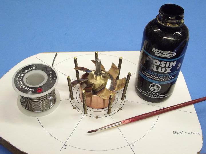

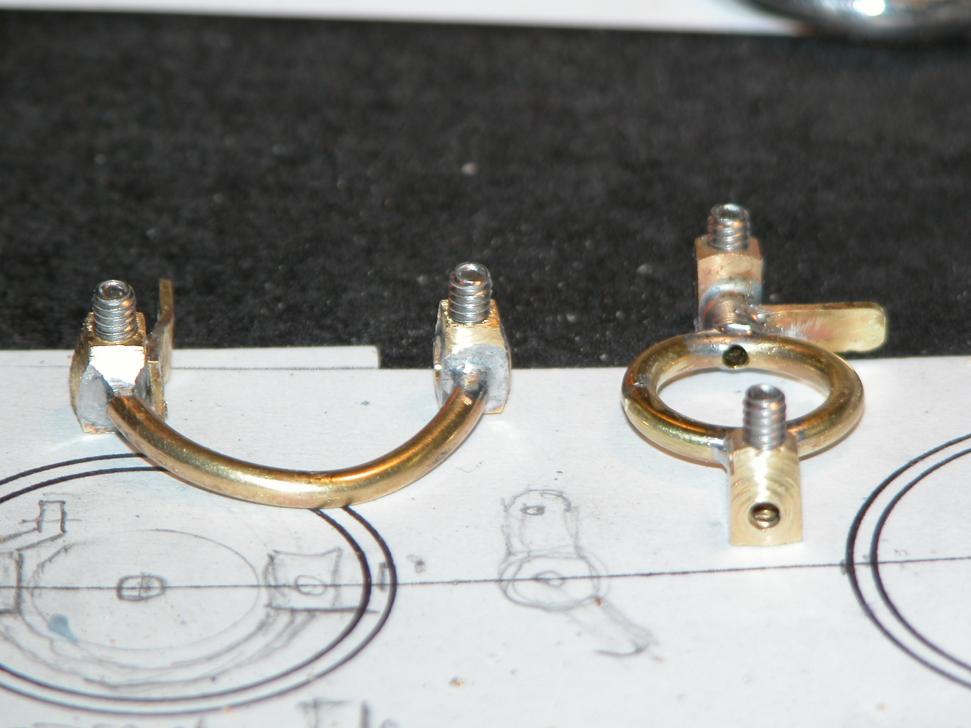

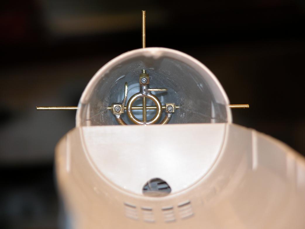

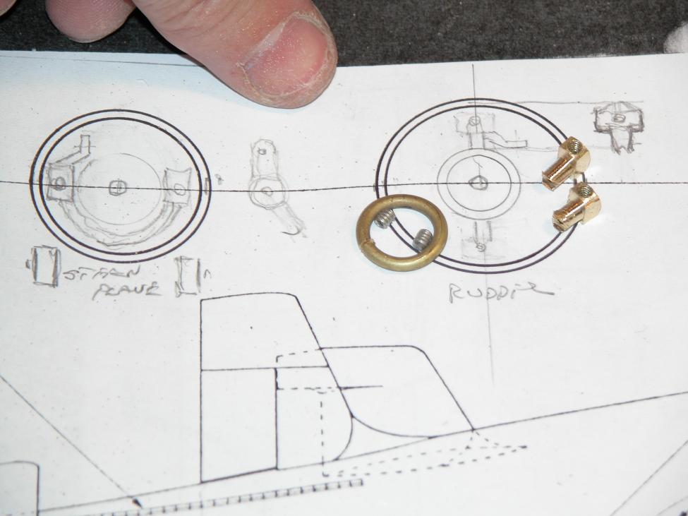

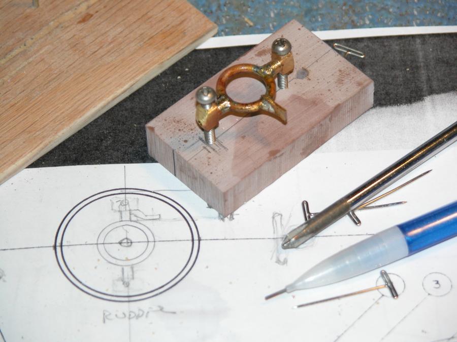

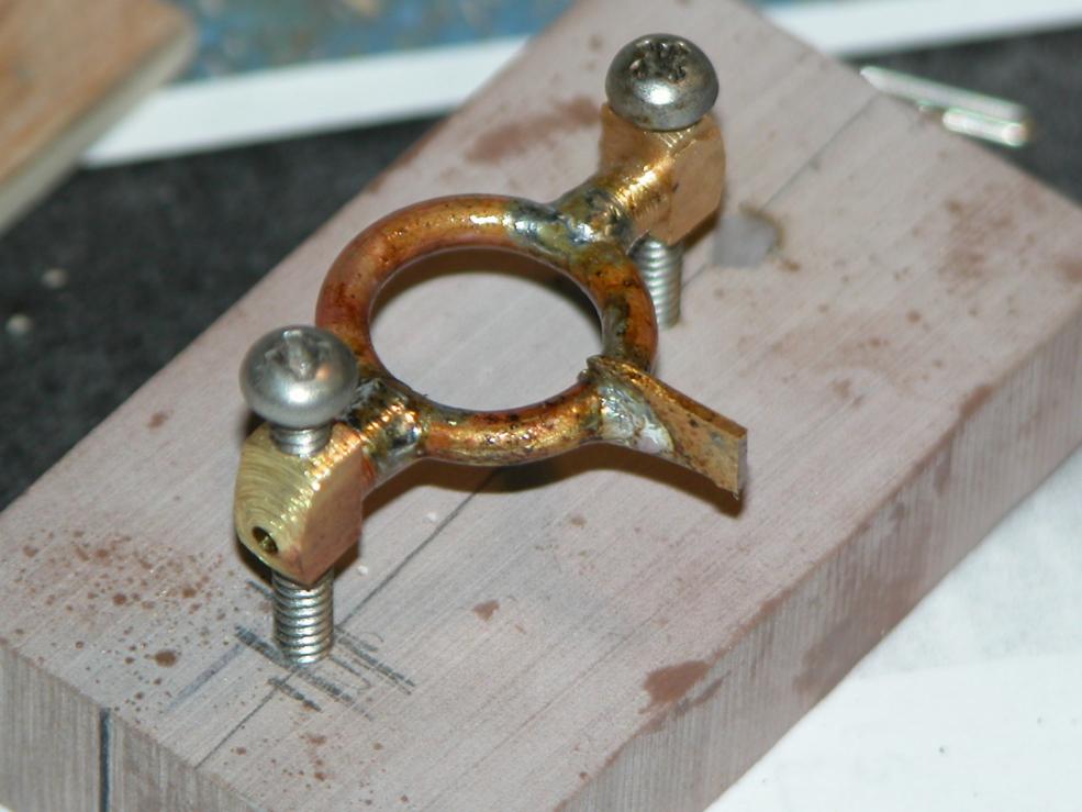

          I have a question that may lend itself well to this blog?"Fabricating your own yokes" When soldering the brass rod to the collars, what solder and flux do most of you like to use, and are you using a very hot iron or the small butane torch?

            60/40 solid solder, acid flux, butane torch.

              Gotcha! Thank you very much for you response David! Your sure do nice work!!
