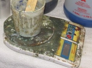

            Dave even puts a scumline on his weighing scales!
