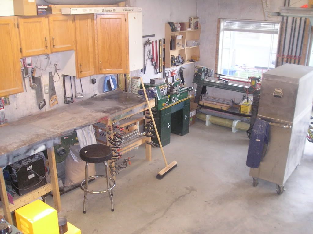

              In the spring it was decided that the shop/garage had to be cleaned and organized as it was to the point where no kind of work could be completed in any sort of manner in which frustration was not involved. It took a long time, but what a nice feeling to have that job accomplished!

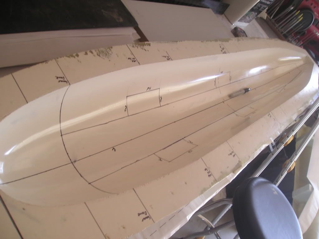

              I am going to represent the anacoatic bevelling shown on the hull where the coating stops and pressure hull begins, just as a way to show as much detail for this boat as I can. To show this detail it has to be done on the negative intermediate moulds I have made, a far easier alternative than removing material from a positive plug.

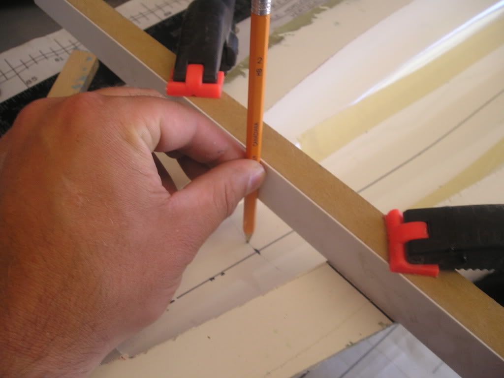

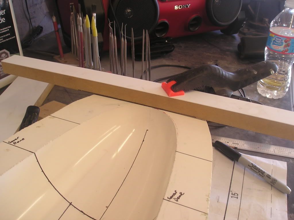

              To start, the mould must first be marked out...not such an easy task for a rounded with compounded shapes. Perpendicular lines in relation to my length-long center line are needed at my forward and aft reference points. This simply done using a long square using the straight long part of the hull as the reference
              Straightedges are placed on these lines and then measurement can be transferred from print to mould. To mark the lines a straightedge is clamped to the hull minus the thickness of my pencil. Measurements are checked over, referred back to the prints and confirmed. Mistakes are found and corrected or a plan to correct them can be developed. In my case I have found that the hull will need to be extended exactly 13/16” to make it more accurate. This will mean making the positive hull halves in two pieces just like I did with the extended USS Jack. No big deal, I’m getting damn good at that!
