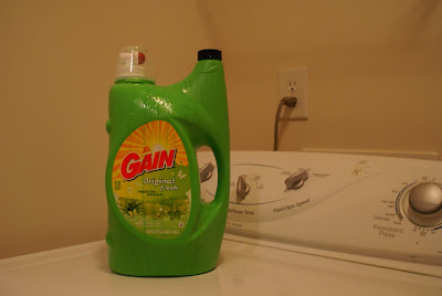

                  Check out the valve on a large detergent bottle for a possible ballast tank drain valve. Parts of it might work for a
                  valve under low pressure.

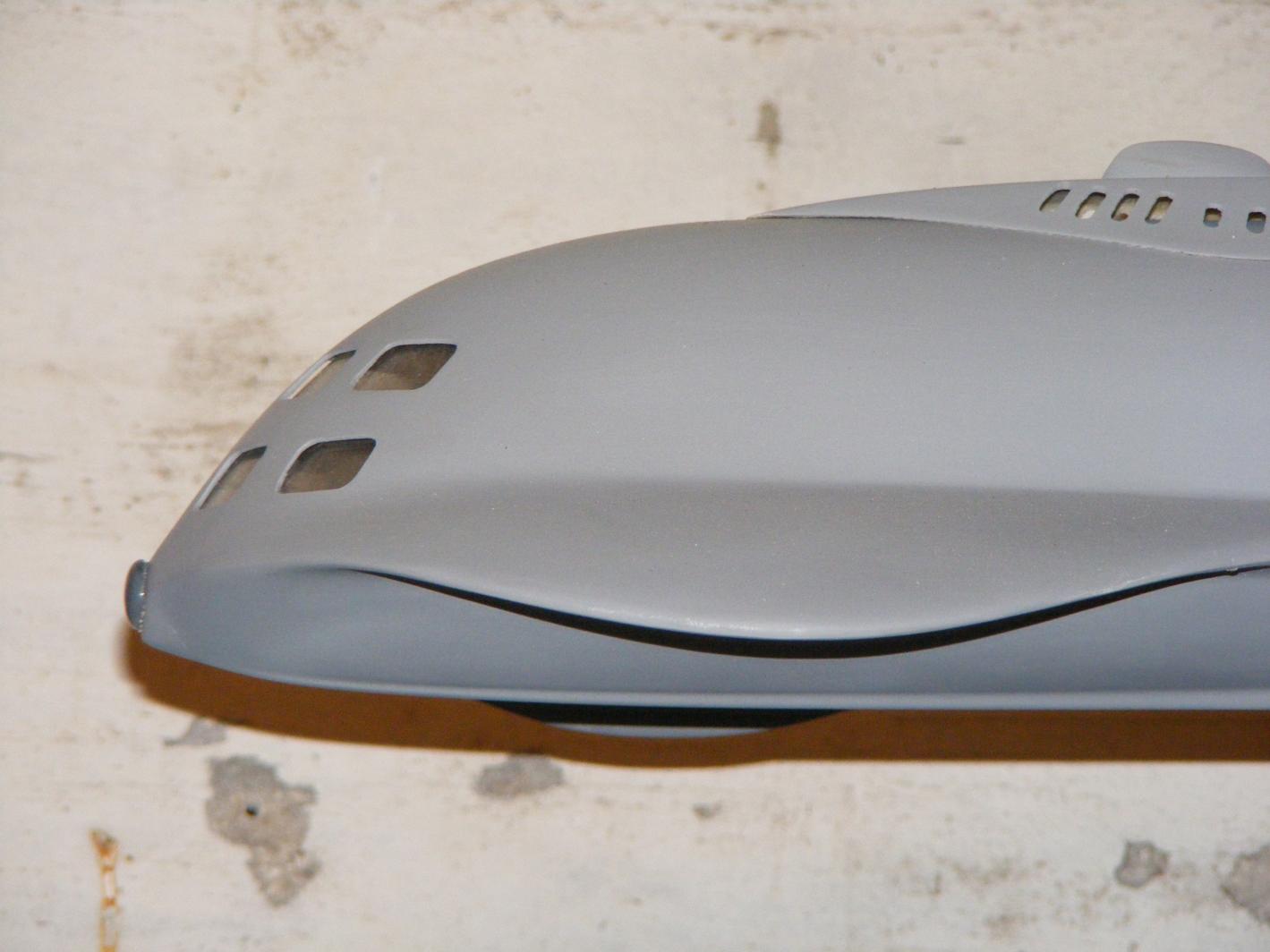

                            Kerry, I dont want to get off of the present subject but in the past you have talked about some Seaviews tendancy to dive when underway. I just stumbled across this picture of my Seaview taken a couple of years ago. Perhaps you can tell something by the shape of the manta fins where they join the nose.Click image for larger version

                              Mark,
                              As I have no practical experience with this hull form,
                              any comment I have made about any Seaview running tendencies are purely paraphrasing of commentary by builders/runners like yourself.
                              Not sure what you mean about the fin/nose. Elaborate? I'm missing the obvious as usual!
                                #90
                                You earlier had mentioned to me that an aquaintance had viewed your Seaview and remarked that the way the bottom of the hull meets the top at the nose would determine its tendency to dive on its own or not. That is why early in your posts you showed a picture of the nose of your Seaview to illustrate the point, if memory serves.
