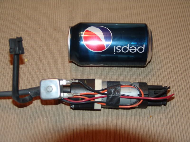

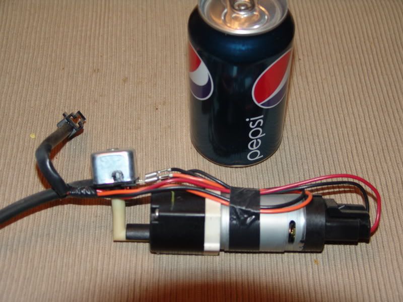

            Lumbar pump from a chevrolet truck. Push -pull pump it can inflate a large ballast tank and pull it back down to a vacum . I been playing with these for awhile and they work great just have to use them in a large sub.

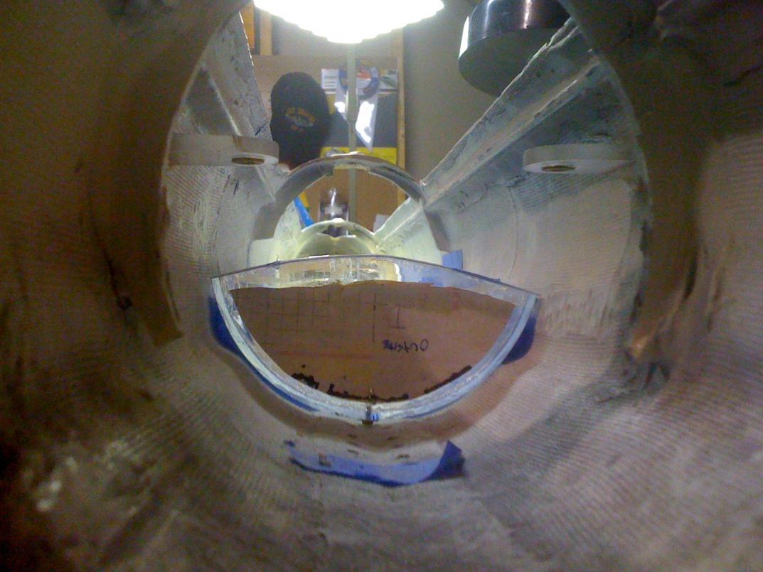

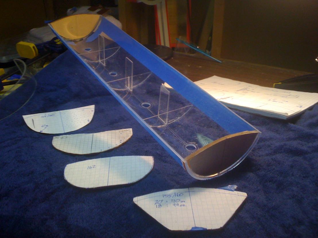

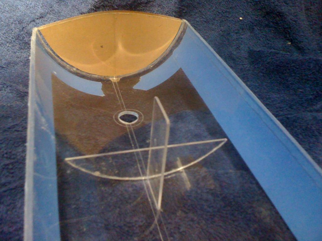

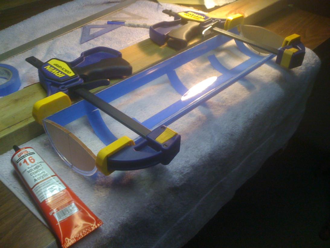

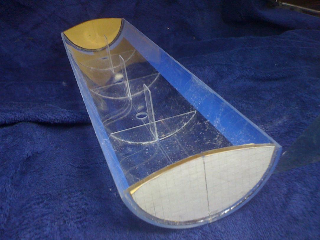

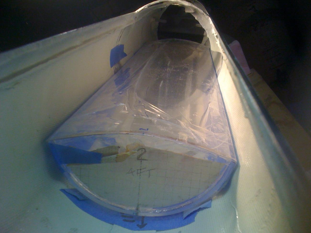

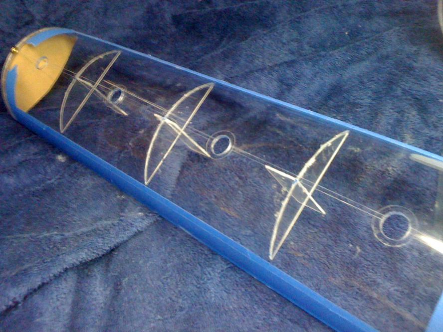

              Submitted for your approval, my holiday build of a ballast tank for the 80:
              Numerous variations of graph paper templates went thru mockup and layout trials to determine a size and shape for a tank that would provide optimal capacity,the ability to insert and remove, and.. keep virtually all of the floodable volume below the desired surfaced waterline.
              The main body is a section cut from 6" O.D. acrylic tube with 1/8" wall thickness. This was clamped at the ends to conform for adhesion to endplates of 1/4" acrylic sheet. The shape of the endplates was determined by the graph paper templates.
              The three internal baffle plates and vertical supports were made from .040 polycarbonate sheet.
              The "roof" or lid of the tank is .020 sheet.(protective shrink wrap remains on shots below)
              All adhesion was done with Weld-On #16, a syrupy solvent that bonds for keeps and when properly applied results in a waterproof seal
              Length= 22"
              Width= 5 7/16"
              Height= 2 3/4"
              Capacity= 120 ounces / 3.3 liters
              Obviously I have no idea yet as to what kind of job this tank will do in the water. I do know from a previous tank build that the seemingly shallow arc of the lid is plenty sufficient to direct escaping air for complete venting.
              I solicit all comment and advice about vent valve configuration, use of jimh's pumps or any other theories of optimum ballast system setup.
              As the holidays had our cameras in use, please pardon the iphone photo quality.
              -Kerry

                A very good job there, can't fault the design or fabrication technique. Keep the liquefied gas away from this tank or you'll shatter it.

                  Thank you for posting photos of your tank design for the big Seaview.The tank you have designed should do the job well.I see that you have fitted baffles into the tank to slow down water movment when moving .The only problem I can forsee is the type of water tight arangement you intend to fit your beast with,do you intend to build some of the the water tight compartment over this tank?

                    I take it the tank will work unpressurised and either full or empty, else that design could cause problems.

                        Thanks for the feedback. Yes, this is old-school with no added pressure to the tank.
                        Gas venting directly against acrylic a definite no-no.
                        I think decisions about trim tanks, etc. can, for me, only come after I see how things sit in the water.
                        While many proven ballast system designs could be viable for raising this hull to a surfaced waterline equivalent to say, a WWII fleet boat,the iconic surfaced trim beauty shot of Seaview is a much higher freeboard.
                        As a resource, you really can't beat the VBOTS DVD 'Season Two-Volume One,' which includes a special features chapter with tons of raw FX footage. Worth the price alone are the Lydecker overcranked shots of the 17-footer shot at low angle. One of the clips is some 70 seconds in length and shows a waterline that hits right around the bottom of the 4 bow windows. I would love to achieve a waterline where at least the top 80% of the windows are exposed.
                        This desired waterline dictated the height, profile and functional displacement of my tank.
                        One of the surfaced drive-by clips shows the model trimmed a bit heavier in the stern to get the windows clear of the bow wake/wash.
                        It prompted me to think that if my main tank achieved enough freeboard, perhaps a "sliding keel" could be biased a bit aft to kick the nose up for surface running only.
                        Another obvious design consideration for the profile/cross-section of this tank was how it would affect the overall layout of internal components. As you can see in the shots from my last post, there is some 3" of space in the hull above the tank.
                        So yes, my intention is for any ballast pumps or other associated mechanisms to be located above the tank. Since longitudinal space in any aft WTC/SubDriver would be precious, I might need the option of using the space above the tank for any components that do not absolutely have to be in the aft watertight compartment, including any half-ass sliding keel mechanism. The space foward of the tank I would imagine will be occupied by a sizeable battery, but we want to preserve some real estate here for the future, just in case one of you guys figures out how to launch an Aurora FS-1 from this mother.
