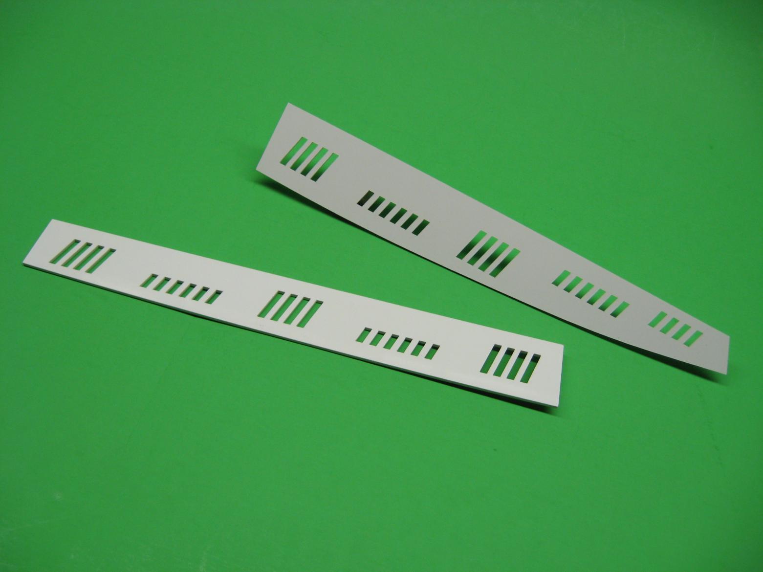

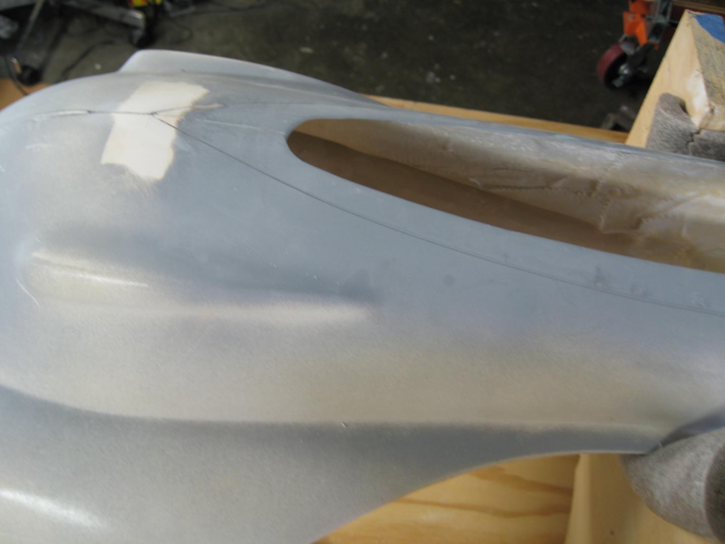

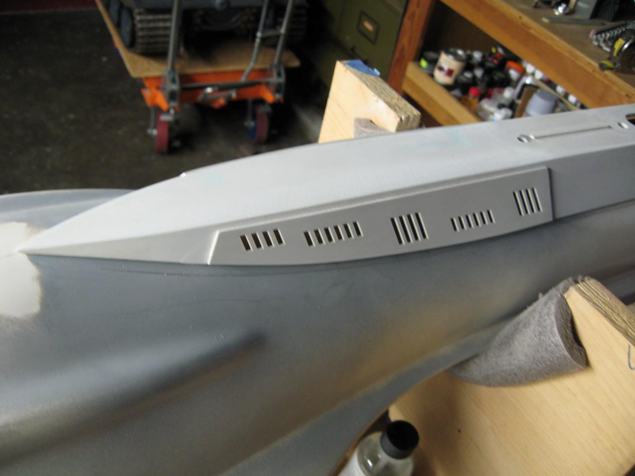

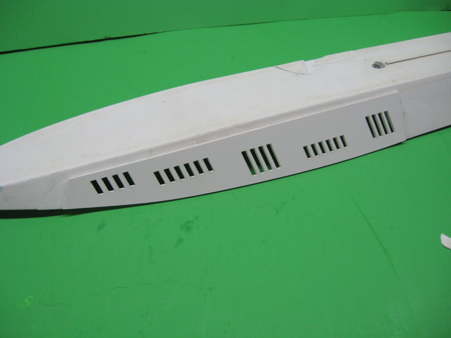

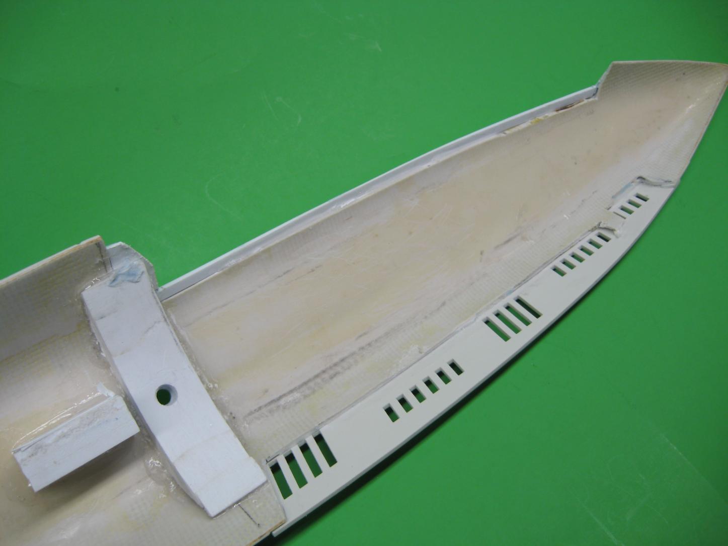

      .....continued.....Pics left to right:
      1 & 2 further repair, reinforcing, praying etc...use of styrene strips & industrial AC, Everecoat...
      3- Don't get mad, get even--I drew up a whole set of Limberhole plates on my CAD program & took them down to my friendly neighborhood laser cutter dude, & VIOLA! perfect, precision Limberholes!
      4- Looks great!
      5- NOt bad, & what a relief. I have a lot of these sets of Limberhole plates, if anyone needs them.

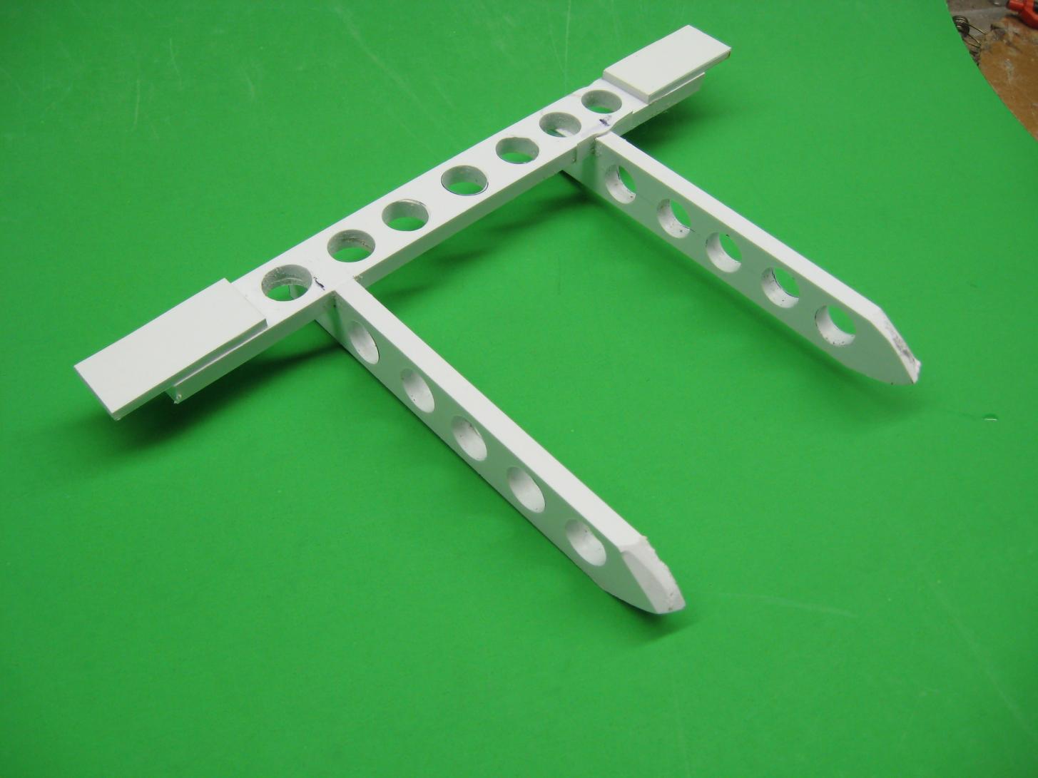

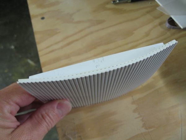

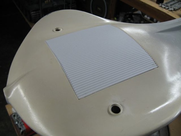

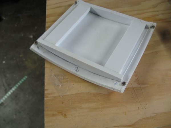

          57" Build Part 5

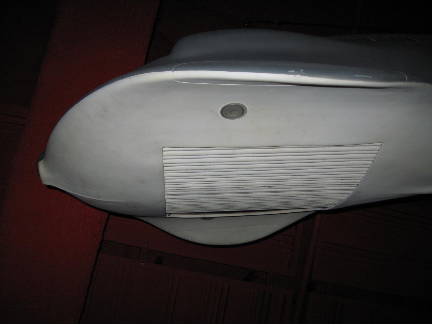

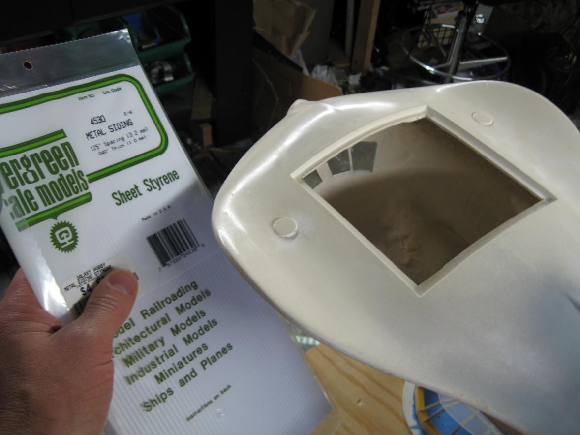

          .......continued......From left to right:
          1- The Flying Sub hatch doors supplied were totally inadequate & out of scale....So, out with some "Evergreen Plastics' styrene serrated roofing. (you can see the size on the package for those wishing to do the same)
          2 & 3 after much fiddling about to get the exact contour of the opening, contracted a framework & attached high strength magnets to the four corners.
          4- Fits like a glove, & strong too. To release, simply push on framework from atop though hull.
          5- here is the goofy support structure for Merrimans awesome observation room kit.
          "I don't like mysteries, they give me a belly ache & right now I've got a beaut!"

            Good fix on the limber holes topside. Now, for the bad news: you have at least seven different substrates involved here (GRP, gel-coat, various adhesives, the limber hole blank material itself, two-part polyester filler, putty, and primer/paint), each with its own expansion/compression rate as a consequence of temperature change.
            Cracking!
            So, don't let this completed model of yours suffer under the rays of the afternoon sun only to have it unceremoniously plopped into the nice cool water when you're ready to play. Do all you can to minimize extreme and quick temperature changes to the model.

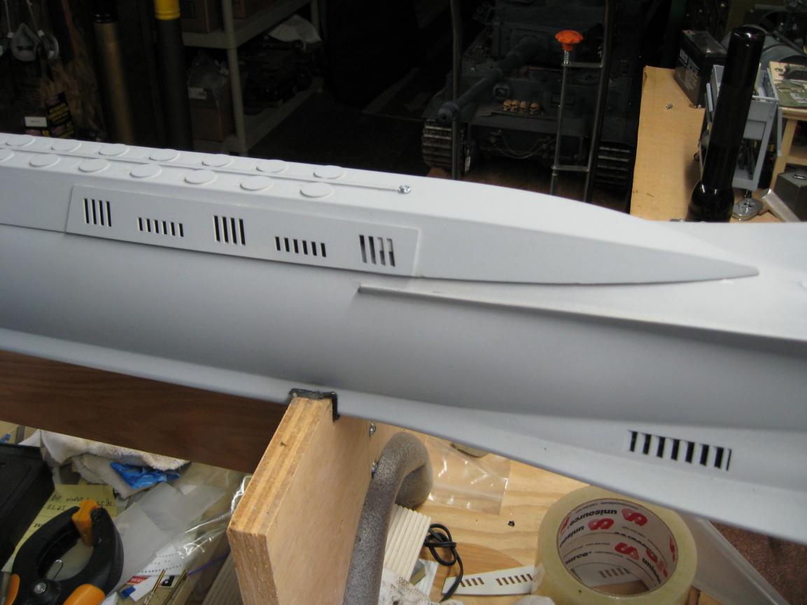

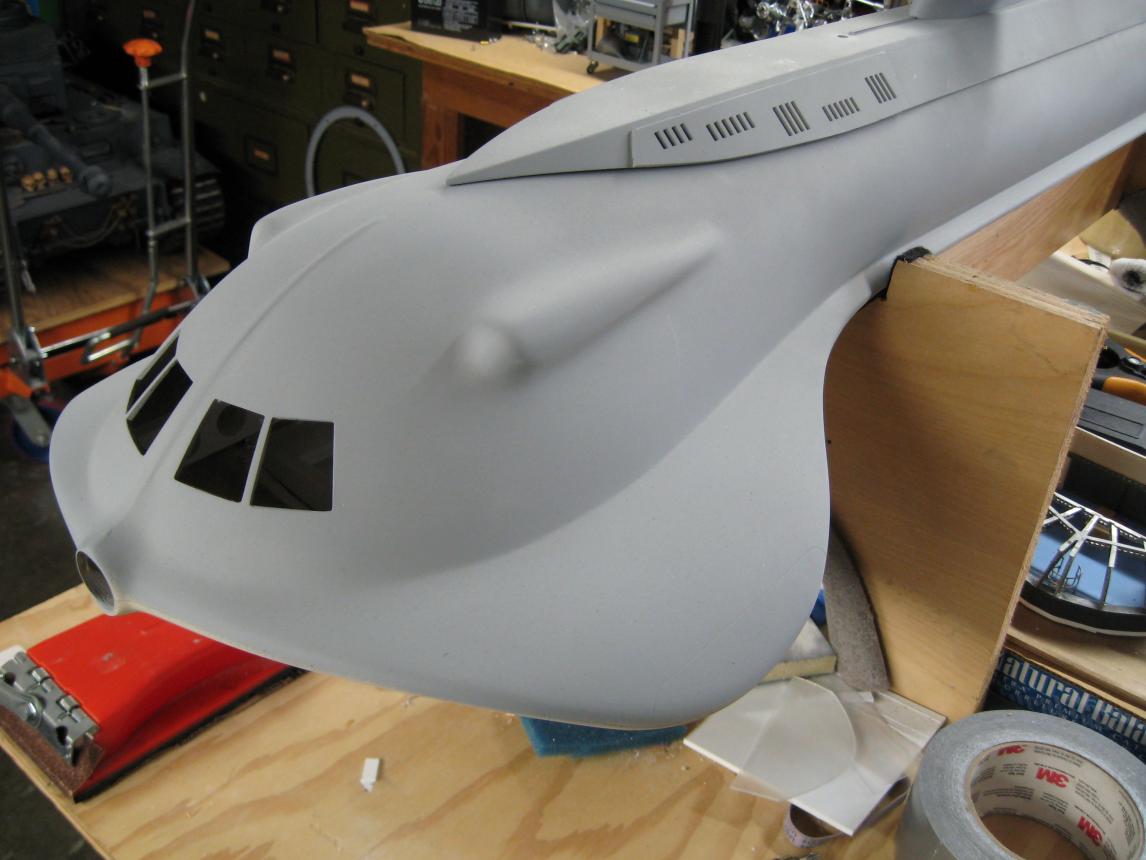

              57" Build Part 6

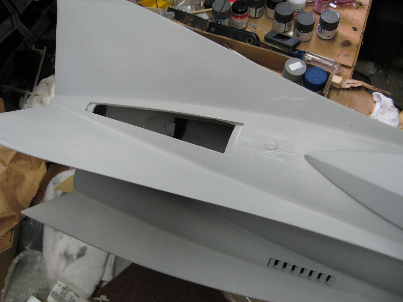

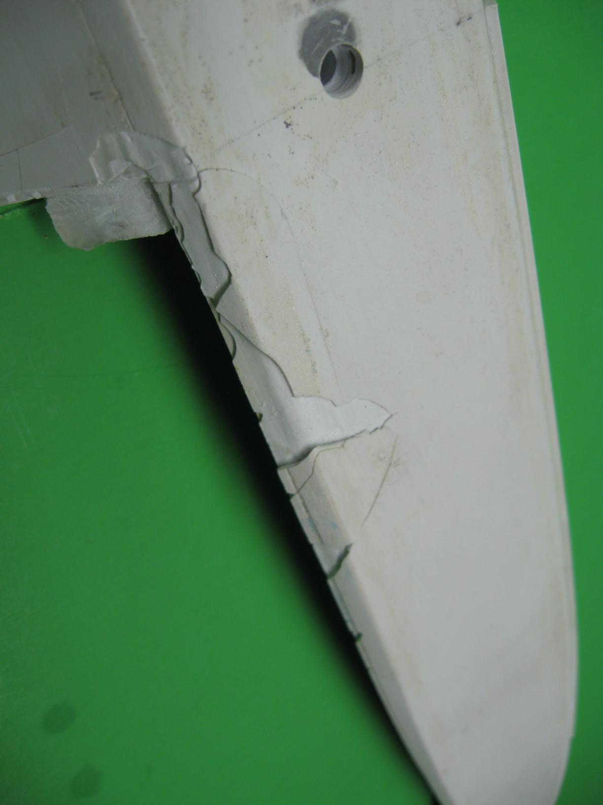

              .....continues.....Pics left to right:
              1- shows the top access hatch for the "rudder room"
              2- perfect limberholes (if there is such a thing) & the forward facing engine tube intake grates.
              3- Limberholes fore, looks fine!
              4- forgot this one, & although I neglected to take shots of it, had to add a significant amount of material to bring the opening at the top of hull IN, becaue it was cut too wide & the deck did NOT cover it adequately. It was a major job with West System & evercoat, but thankfully I learned while I was performing it AND luckily didn't screw up!

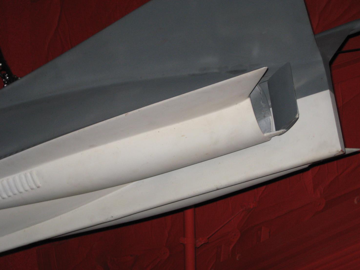

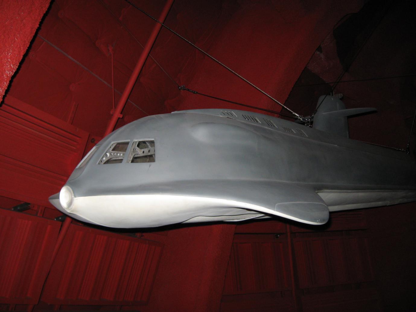

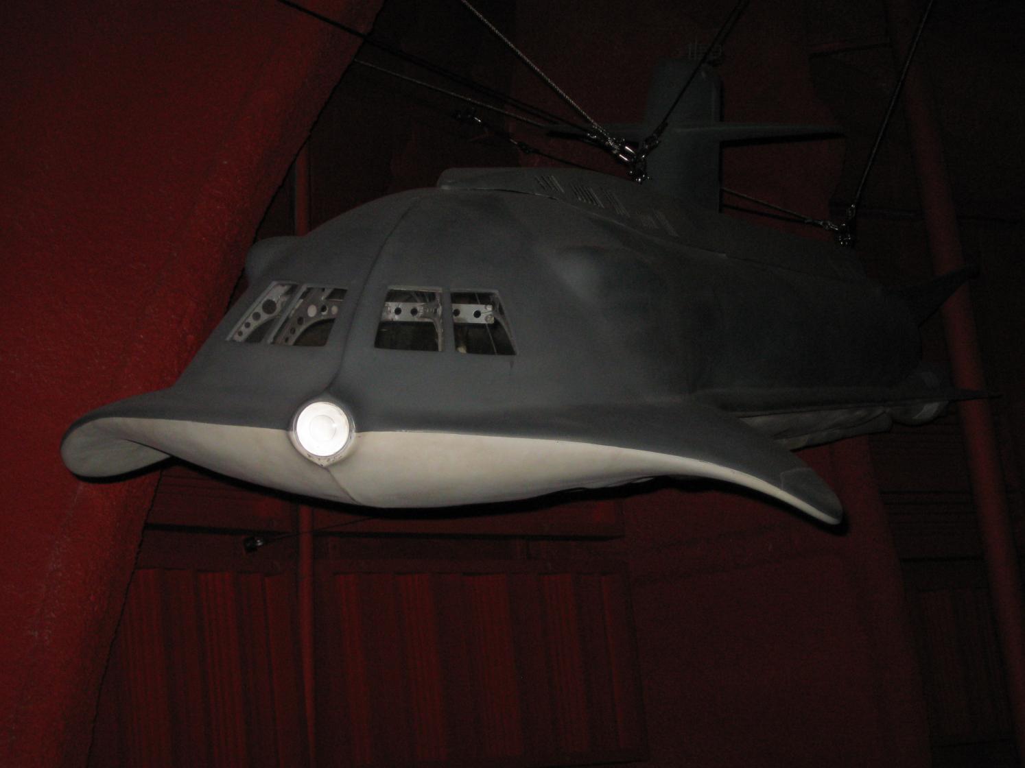

                The Mothership
                Last year I had the luck to find the curator of Paul Allen's Sci-Fi museum in Seattle (close to where I live) & was able to meet him & have some 'alone time' with the original 17 foot Seaview filming miniature, as restored by David. It is not on public display.
                They had it suspended in the air, (not sure I want to know what drilling & such they did to get it to hang). To make room for other exhibits, they were taking Seaview down & putting in a very expensive custom 'crate' to be stored. I hope they bring it out again some day. Rest assured, these experienced museum guys will take superb care of her for the foreseeable future, nice to know it will be preserved properly.
