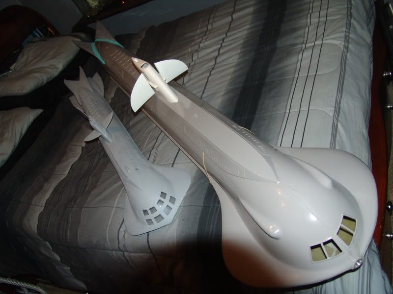

      Kerry ,I got the hull coming .
      Jim
      • jim h
        • 55
        #93
        Hull is here . Building time.

          Jim, the two Seaviews that you have pictured here, where did they come from, its kind of hard to tell from the pictures. Is that the 57" on the right and if so what is the one on the left? It has 8 windows and looks like a Teskey!

            I can only telll you the one on the right is the one and only 80.

              On the left is aTeskey hull and the other is a DeBoers hull.
                #97
                JimH , Im a little slow as you can tell. you got a Teskey did you? Did you get it from the man himself or did you get it second hand? Not my business but im just trying to keep up with the members of the fraternity.
