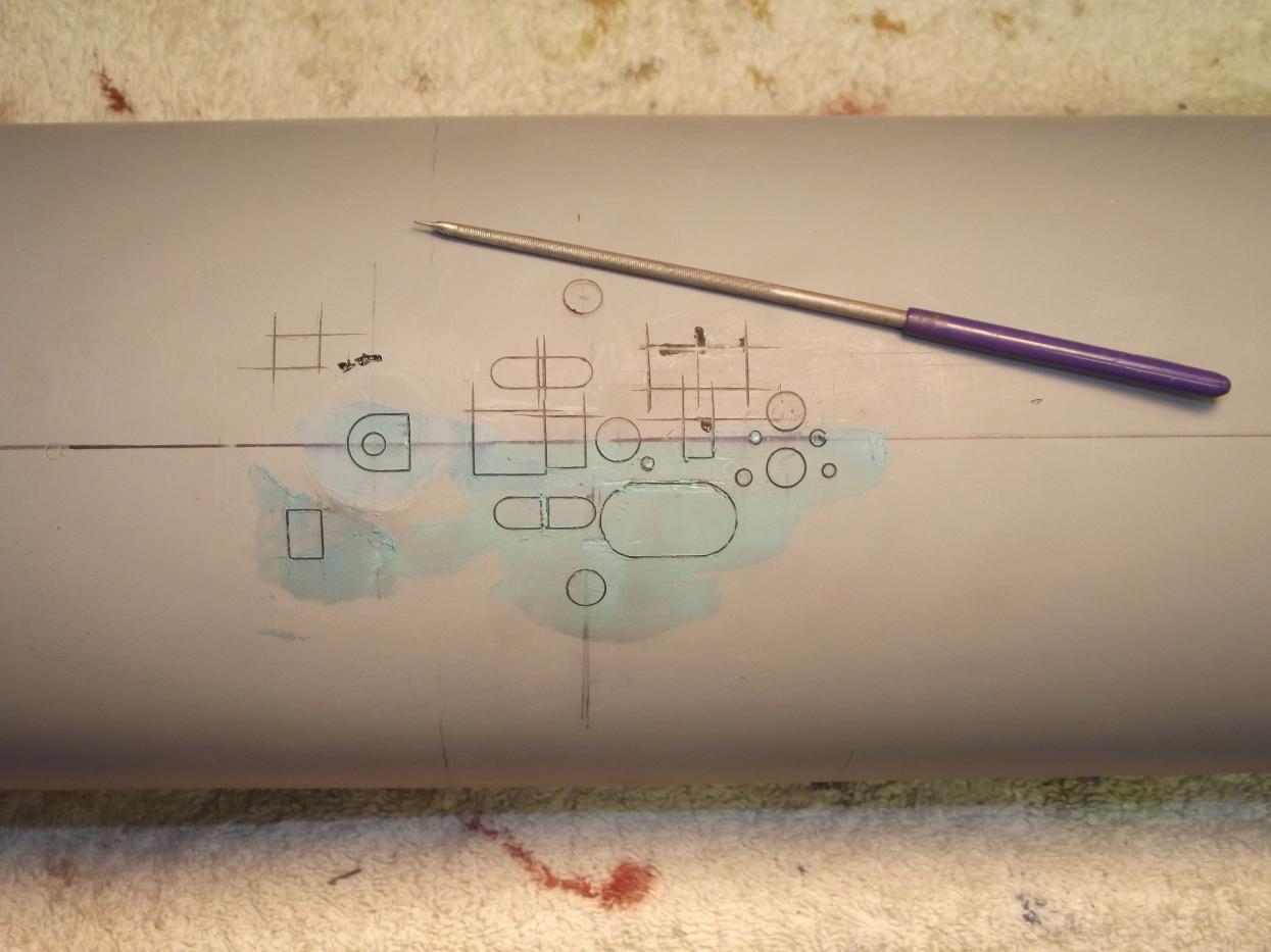

    Much better, Bart. What I do is simply wipe some medium-thick CA over the offending engraved work then hit it with some accelerator, File the hardened goo flush to the surface and scribe into this new substrate. Much easier than trying to keep the scratch-awl tip from wandering around as it encounters different materials with their associated properties of hardness a brittleness. You can still see the previous work through the semi-transparent goo so that will guide you without need of re-marking the work.

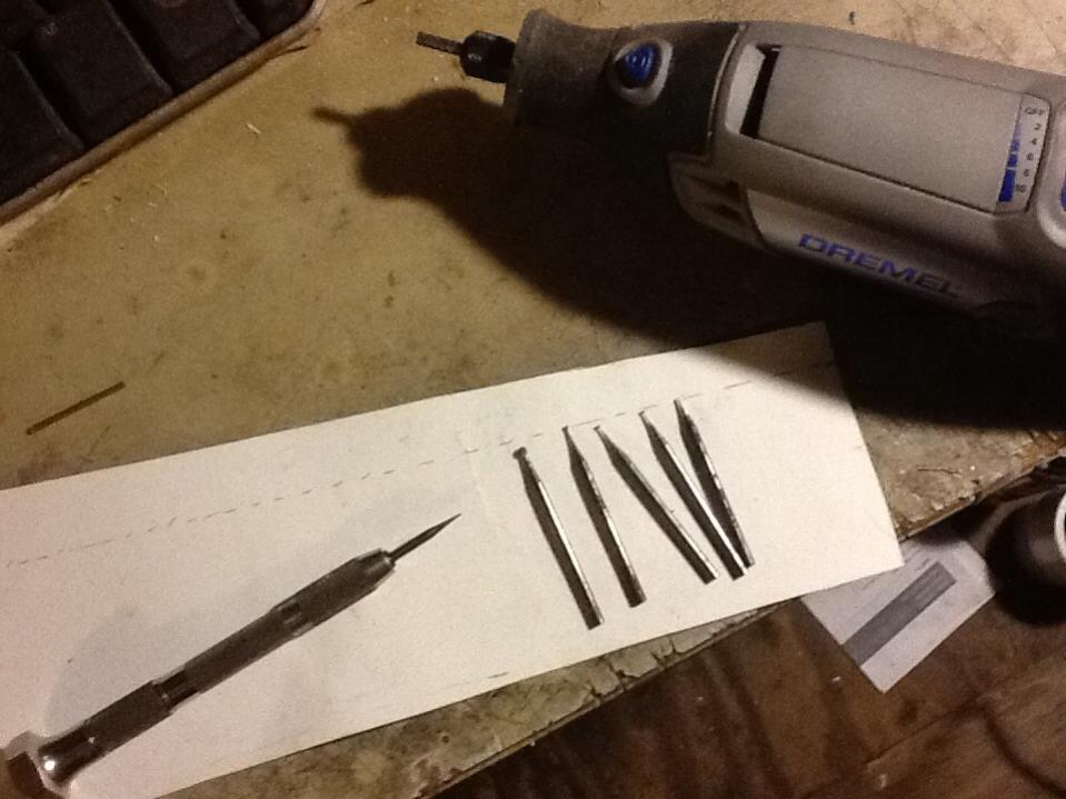

    I like your handle on the scribe in pic 11. Verry nice improvisation. What is the harpoon looking tool lower number 15? Dremel makes some fine engraving bits. I do a lot of metal work engraving, with the motor, but for plastics, just chuck up in the hand drill. Scribe your lines, then you can follow up with the various bits for width and depth. Like you say, practice practice, it takes some finesse. Once you can use a tattoo machine without too many mistakes, your ready for engraving. I learned how to tattoo on oranges. "if you got ink in the meat, you ain't ready" is what Goldie told me.Click image for larger version

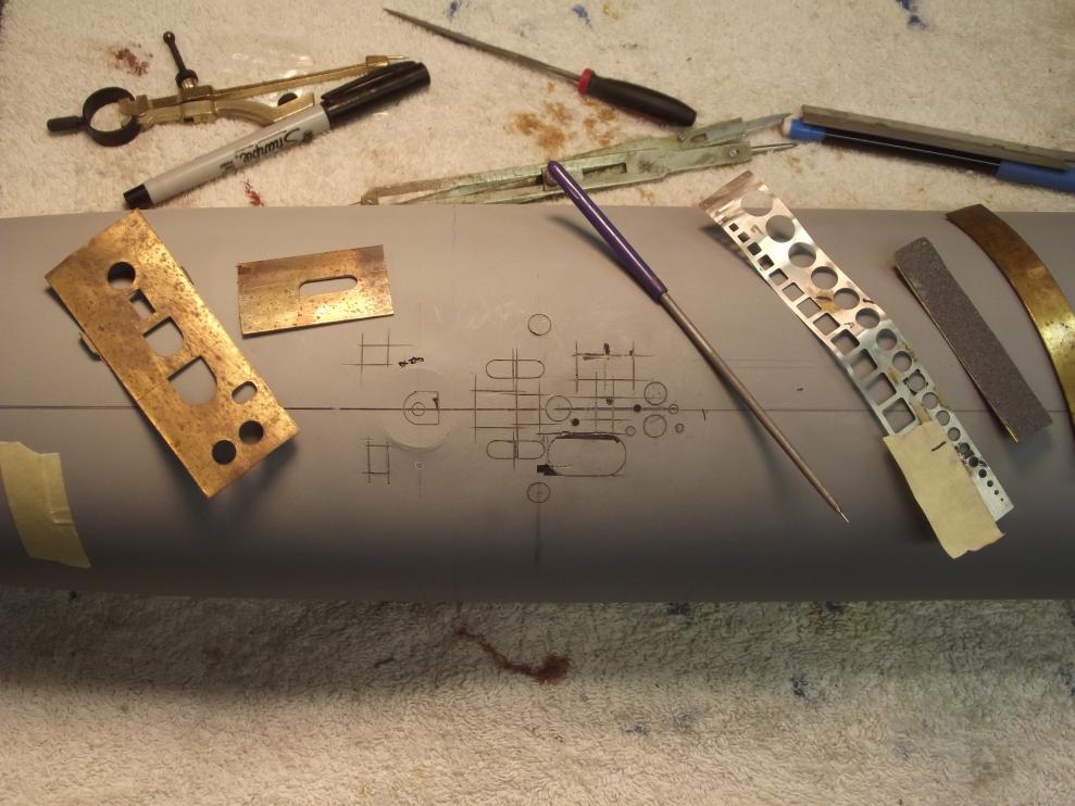

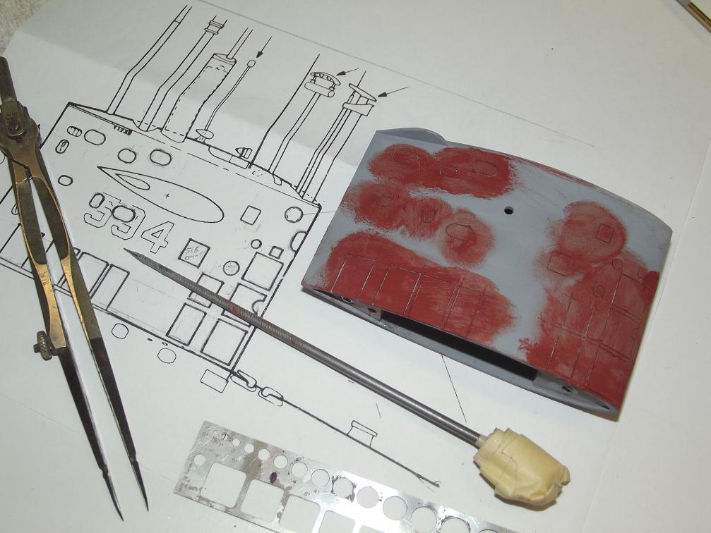

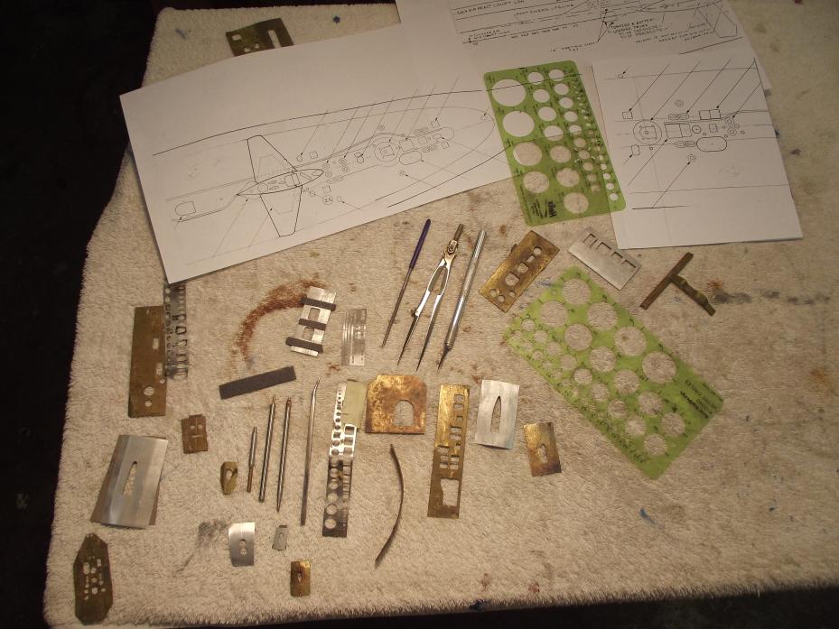

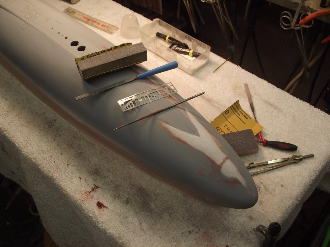

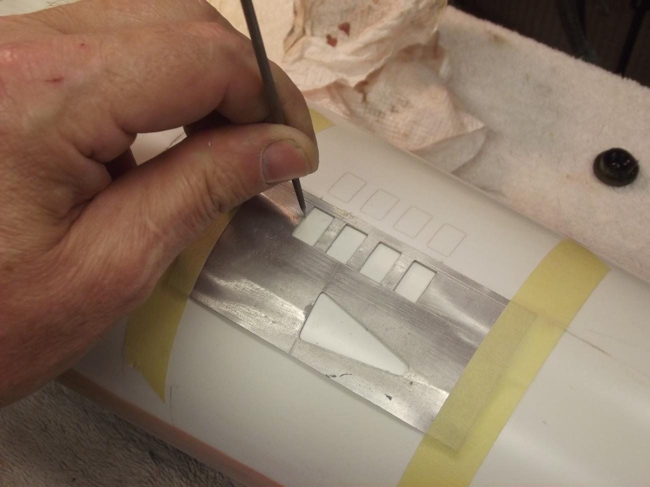

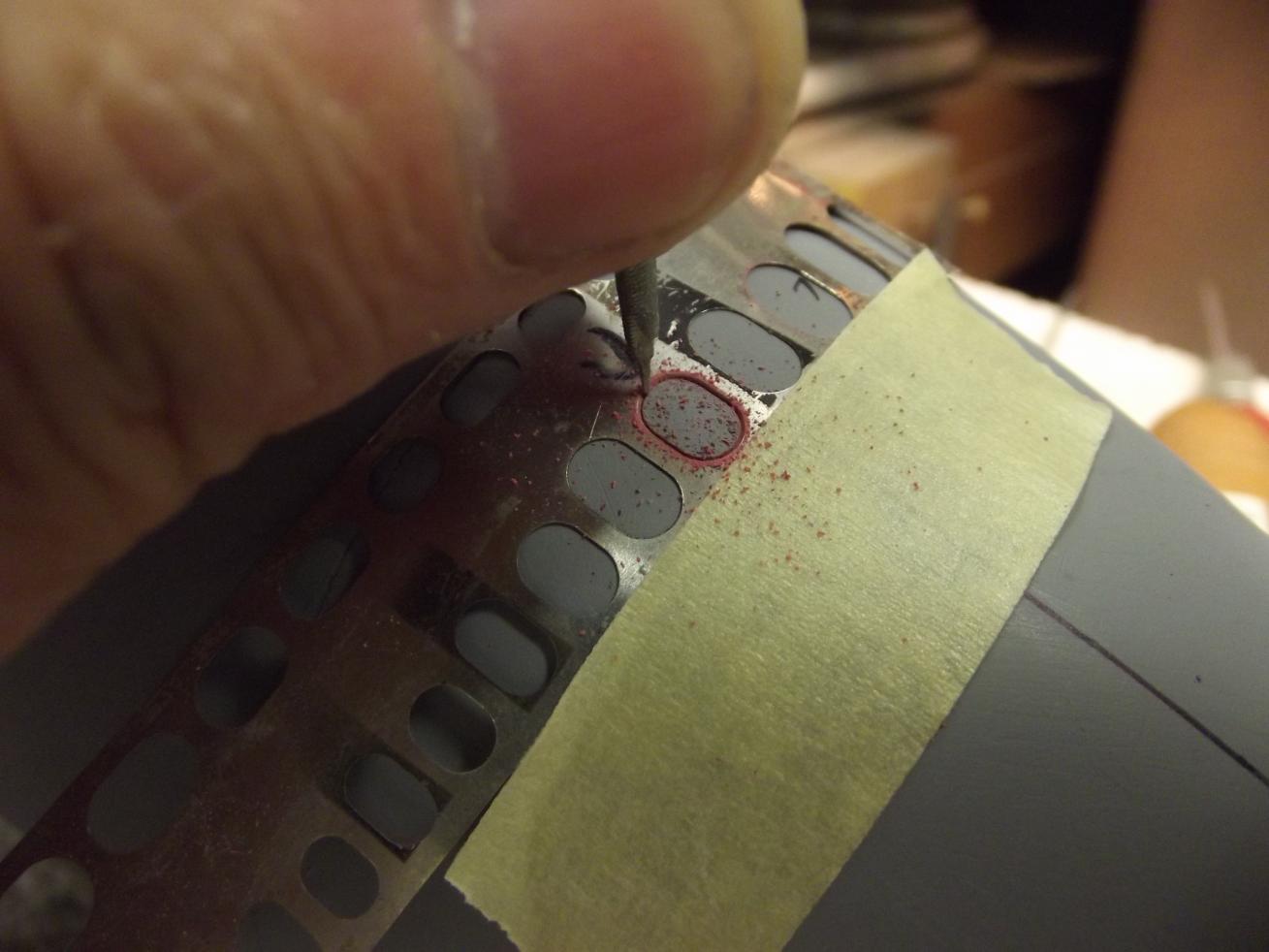

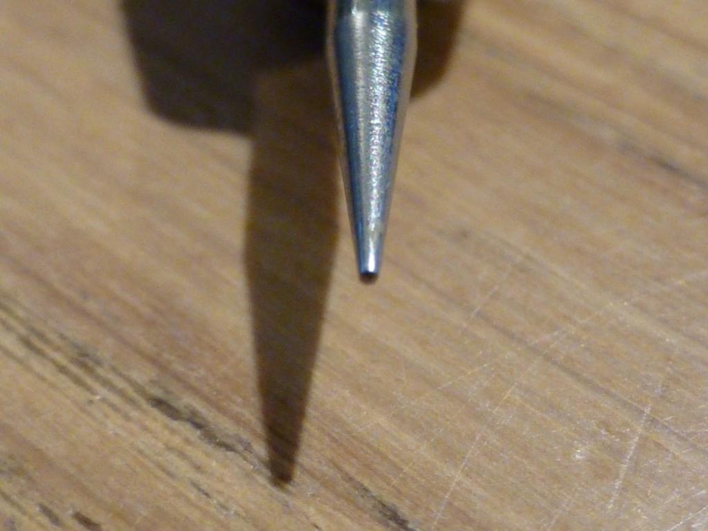

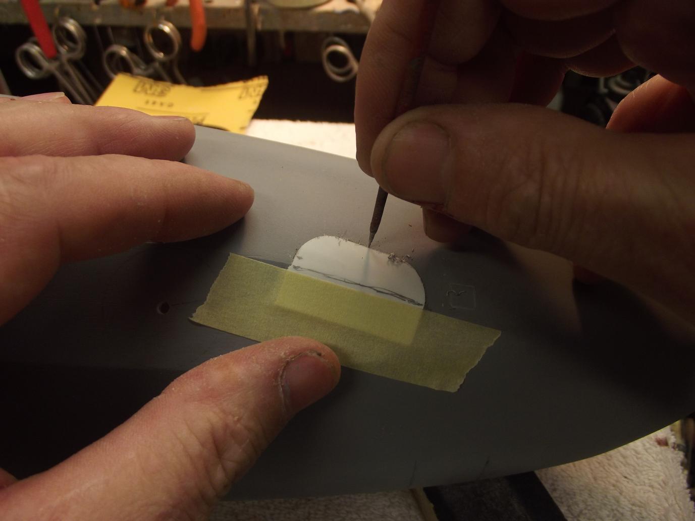

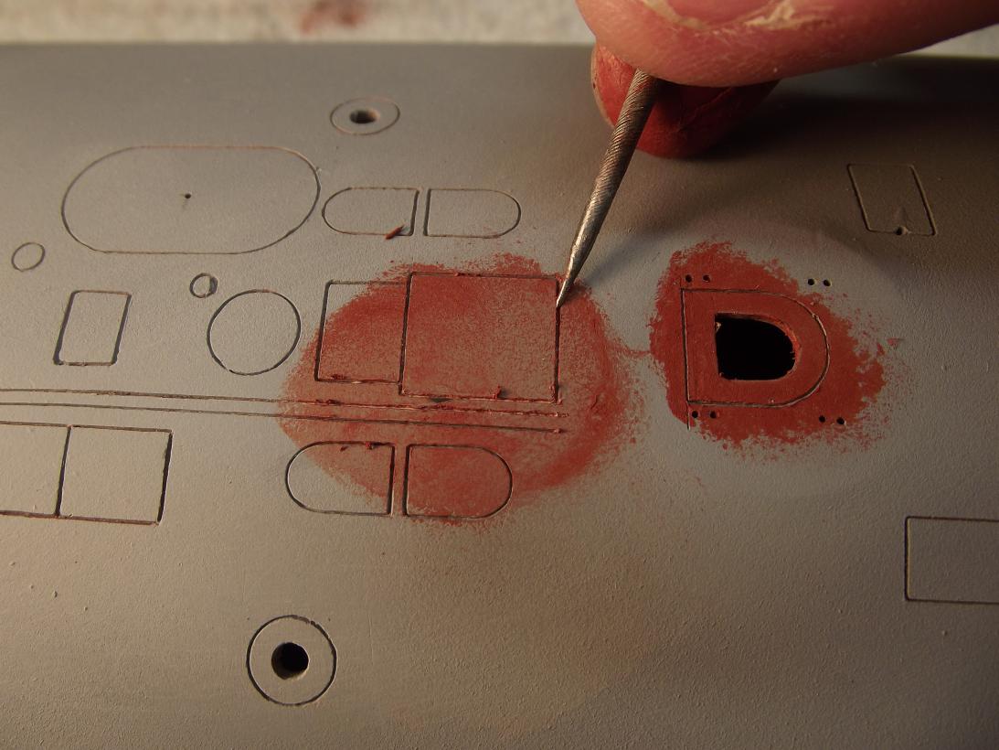

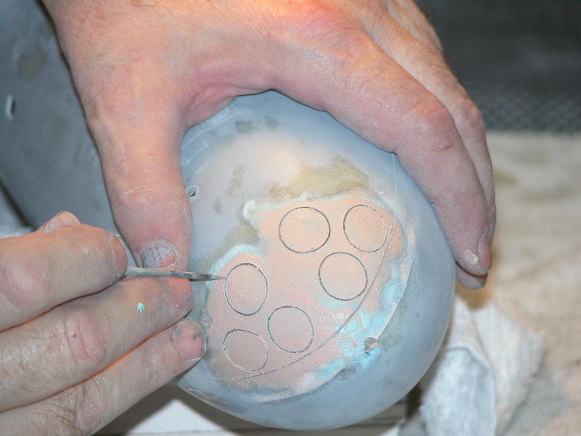

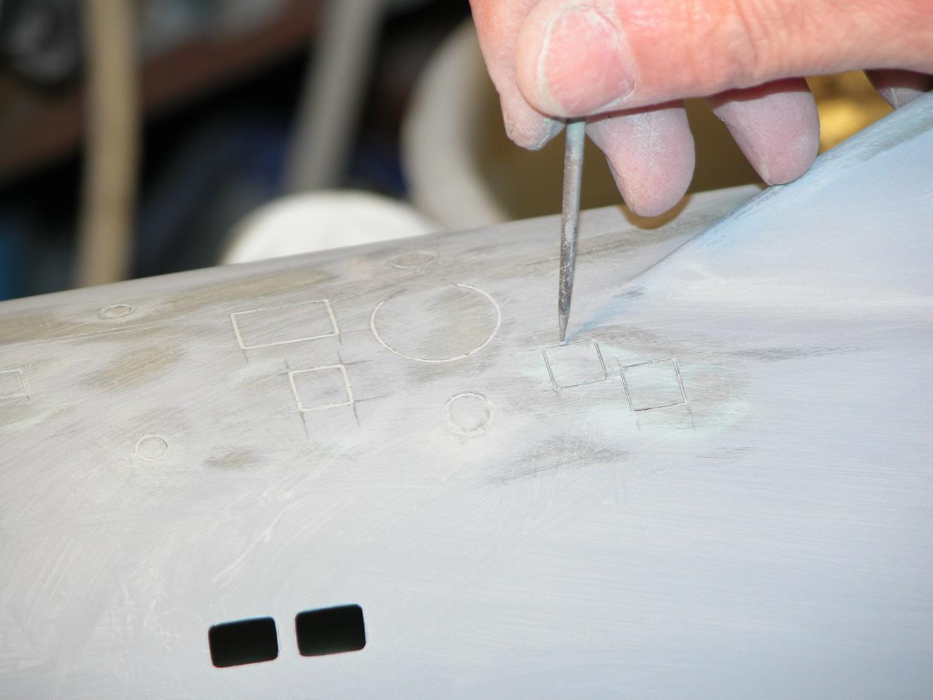

    Pay attention to how the shank just above the tip is as narrow as can be without being so weak as to bend under the pressure of engraving.

    Scribing
    I have been doing some test for scribing. I used the needle of a pair of compasses, blunt the point (just a touch). It is ok…….here comes the but part.
Name:	Akula (269).jpg
ID:	98590 Click image for larger version
Name:	Akula (270).jpg
    The problem is that I have to go to deep to get the desired wideness of the grove. When I try to paint is the paint does not reach the bottom part of the grove. When I tried to scribe with a more blunt tool the grove looks like sh*t.
    So I wanted to post here a question how to do it but then I hit the search button of the forum typed “scribing” and the first hit was this.
    Scribing stencils, and a pointed needle (re-worked needle-file) is all you need. The trick is to start with the sharp point and to then make the finishing passes with a blunt point with a shank of constant diameter. Practice, practice, practice.
    It is all on the forum……So I have my starter tool just have to make my finish tool now.
