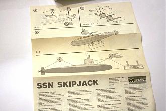

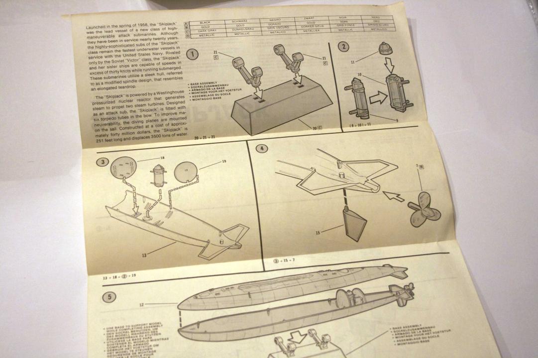

            The instructions were interesting they looked pretty simple.
            however, we don't need no stinking instructions :)

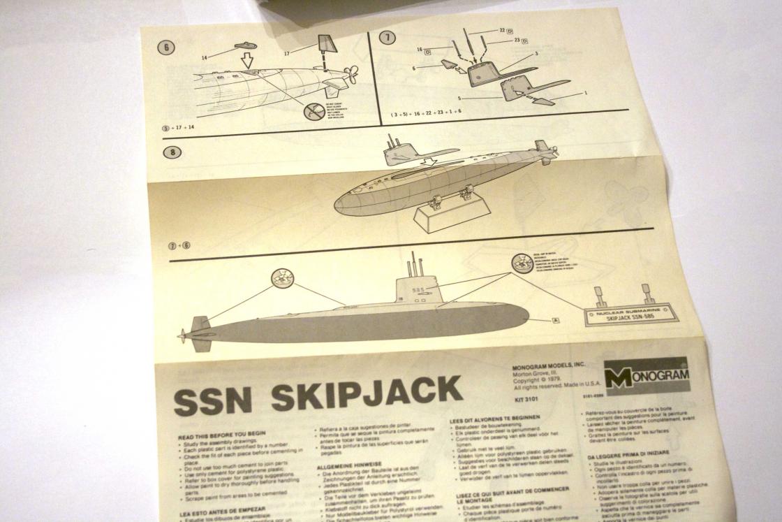

            The back of the instructions were more of the same but
            dad showed me some of the parts are not accurate.

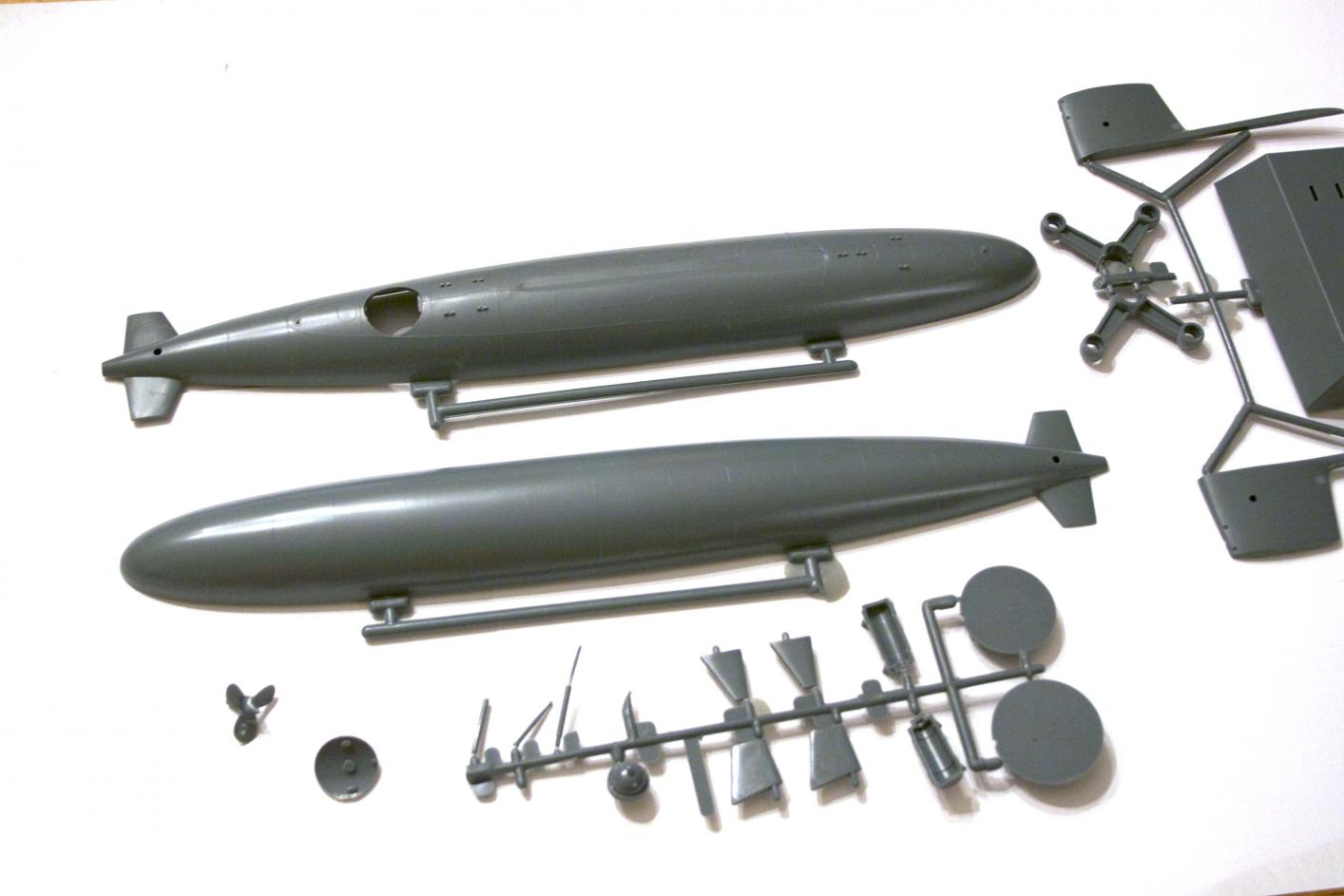

            I was surprised to see how small the sub is.

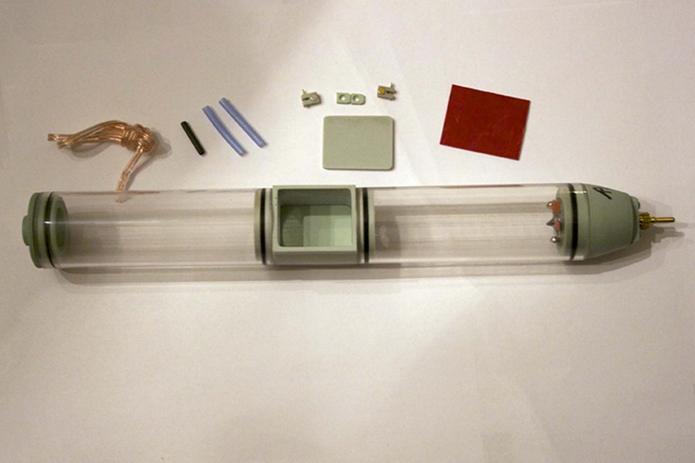

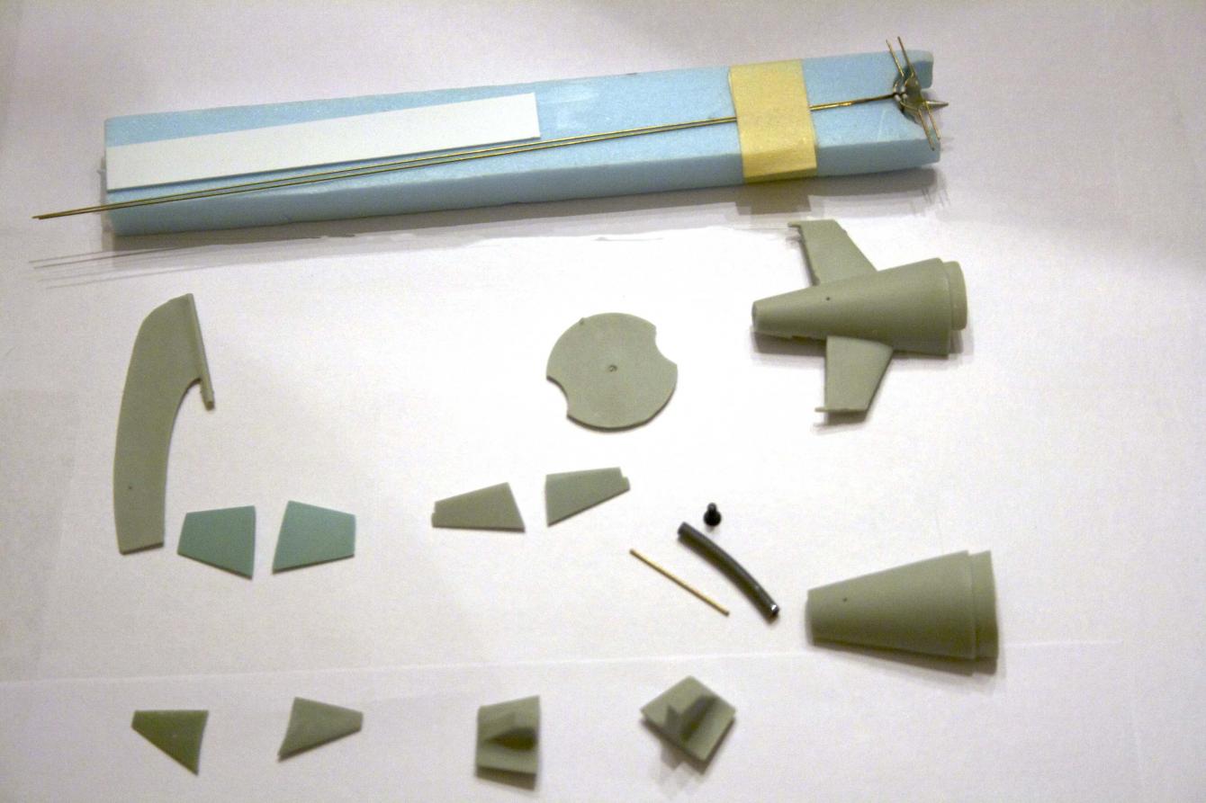

            Next I will review the fittings kit. Mr. Merriman did a fine job on the fittings kit.

                    The sub-driver really got Sam excited. It was hard to keep him from playing with it. he likes the ability to convert the power output between one or two shafts. I showed him how the servos transferred their motion through the top to the push rods - that was a hit! I noticed there are two holders, I am assuming we need to find magnets to fit?

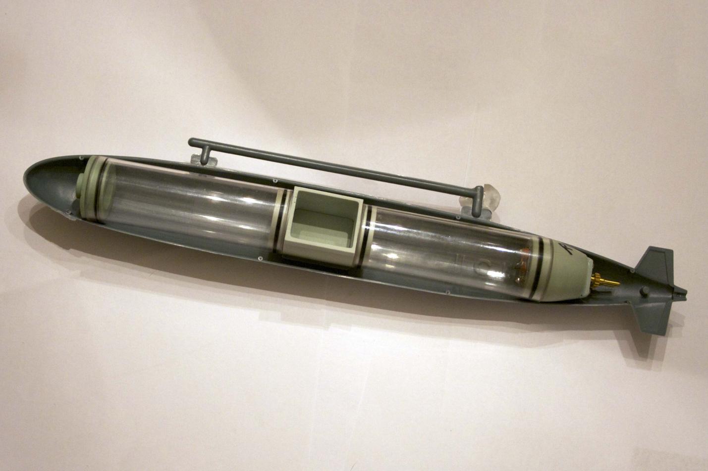

                    It was too much for him to bear. We had to see how it looked in the sub (I was curious as well).
                    Wow not much room. I did not share with Sam, but if I need to add weight, where do I? I guess the extreme ends.

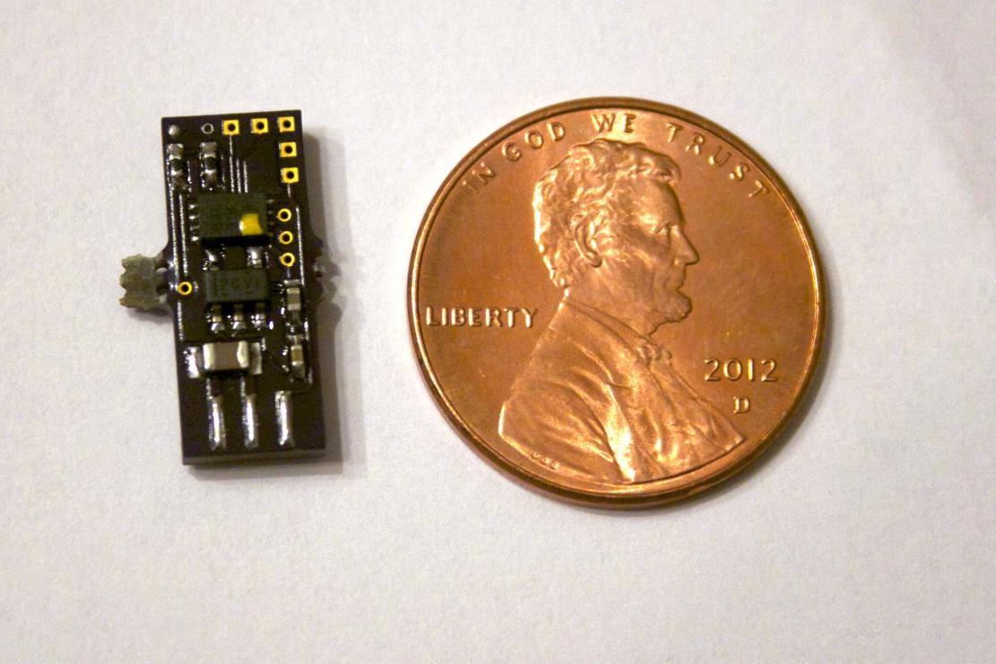

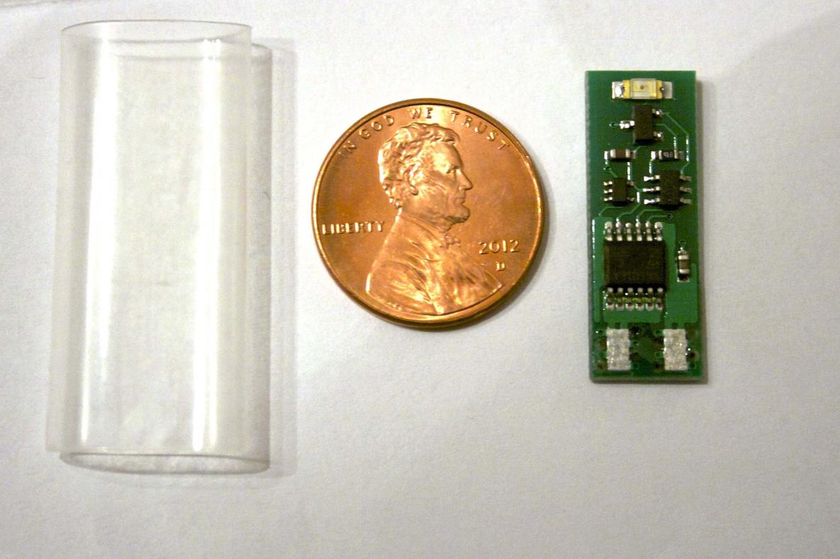

                    This is exciting to me. I bought 3 additional ESCs from Adam Carlson. These are the ones he developed and one was already in the Aluminaut. Two more are going to finish the needed controls for the tiny sub. The third one is to experiment with. We talked and he believes it could run this Skipjack. If I blow it out, Adam said he would replace it.

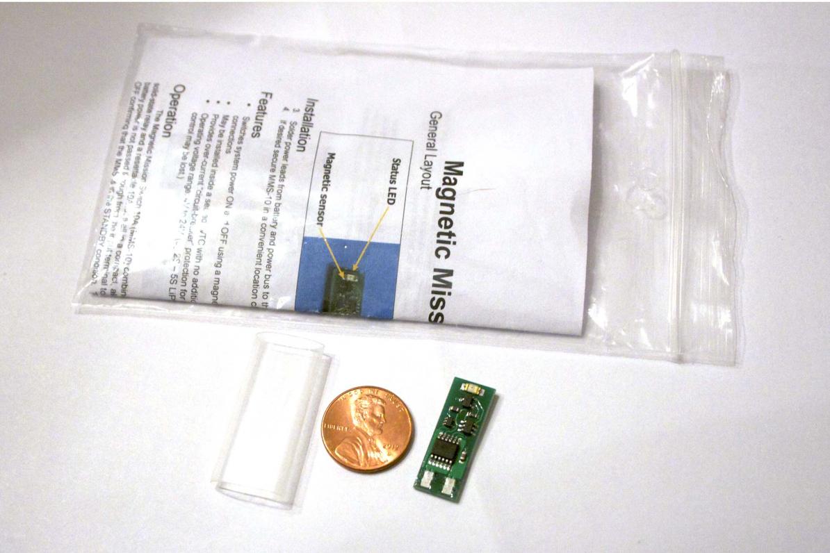

                    Then to add to the fun, a friend, Will, offered to help Sam on his build. Will O. said here and gave Sam a fittings kit and this Switch - How cool is that? So, no rubber boot to worry about.
ID:	92210 Click image for larger version
                    The clear shrink tube is used after all connections are soldered and cleaned.

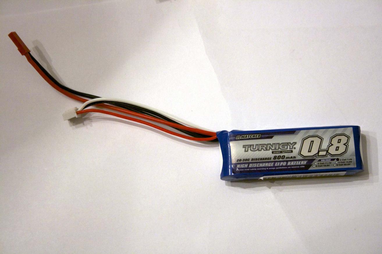

                    The battery.

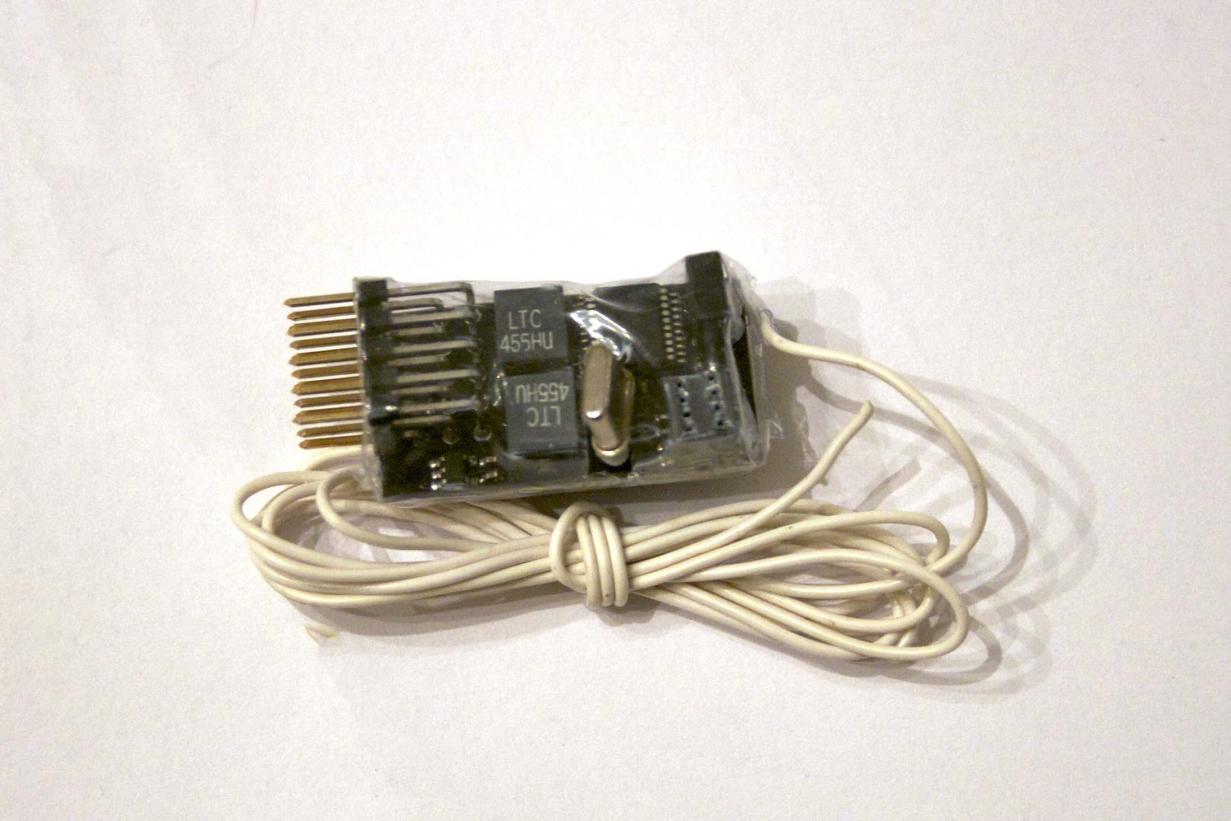

                    The Receiver is a Lepton 6 with the box removed. You might be able to still get some here (http://www.sub-driver.com/electronic...er-75-mhz.html)

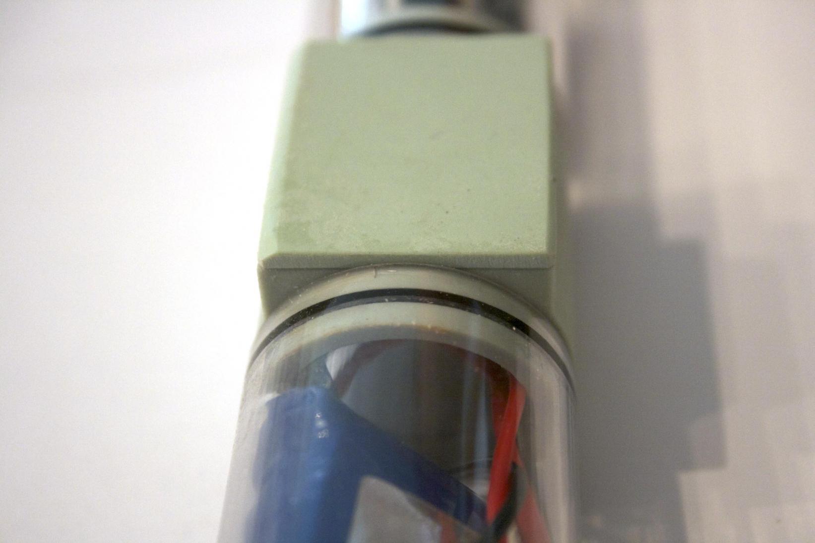

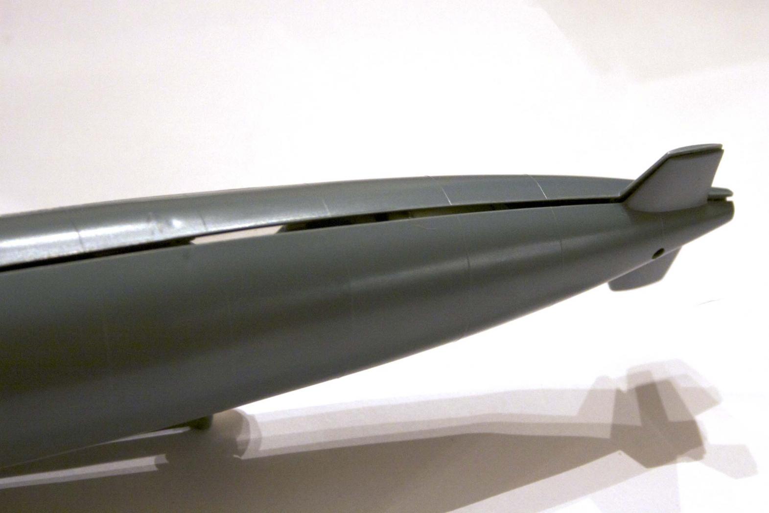

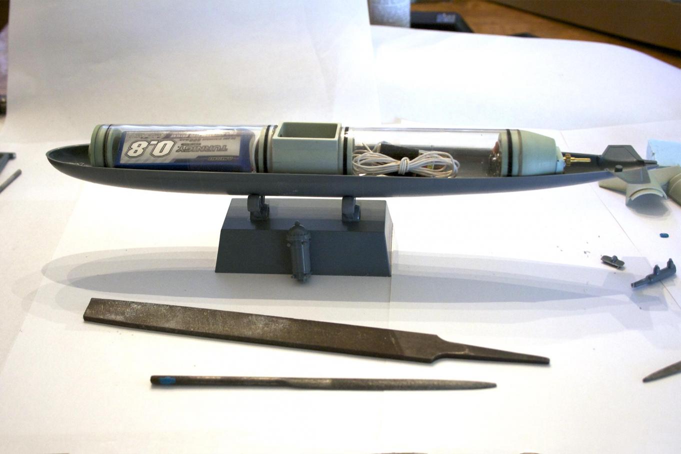

                    We are getting excited because next I see cutting the lower bow and tail sections. An area that concerns me a little is this:
                    There is a distinctive gap with the Sub-Driver installed. I know I will need to help Sam by removing any molded in ridges and maybe rounding the bottom of the center section of the Sub-Driver. Any other suggestions?
                      • 14014
                      Thin strips of lead sheet ahead and aft of the servo box -- you want to pack the fixed ballast weight as near the c.g. as you can -- less 'dumb-bell' effect.
                      The gap between the two hull halves will be filled with CA and baking soda ... you know the drill, Tom. But don't address that till you replace the tail-feathers and make up the bow piece and contour it with Bondo.
                      Neat little devices there. Has Adam gone commercial on us? Hope so, he's a real talent. And one hell of a nice guy to boot.

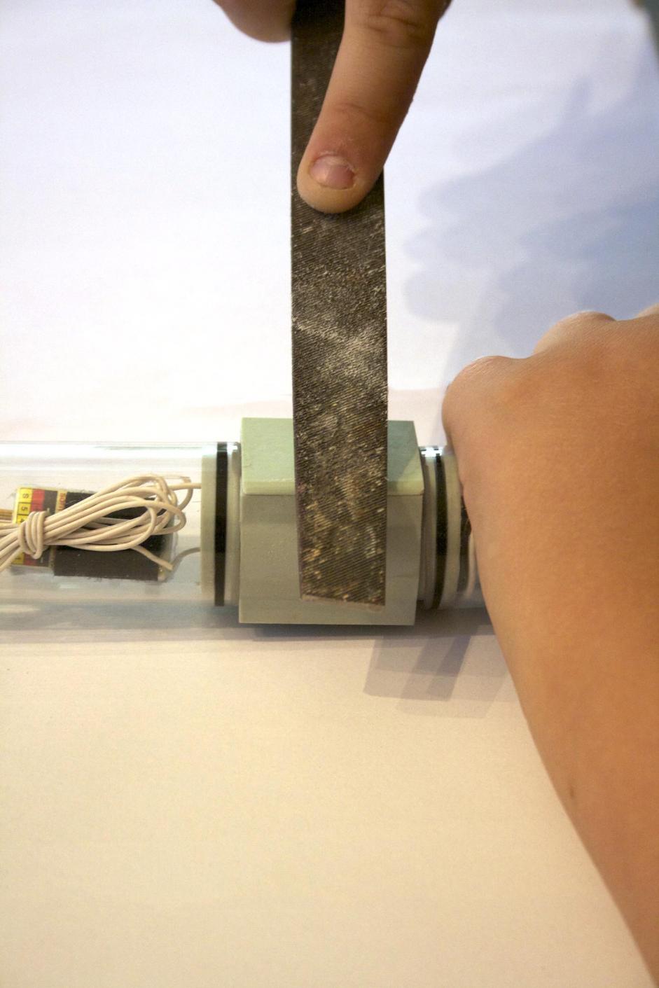

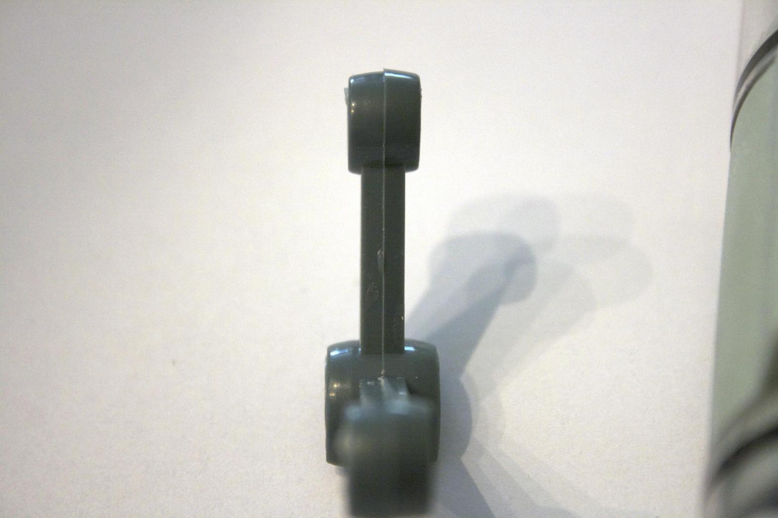

                        My dad thought to round the Sub-Driver to fit inside the sub and to make the gap smaller. It didn't really change the gap much.
                        You can see one side is round and the other is not. It will be rounded evenly on both sides.

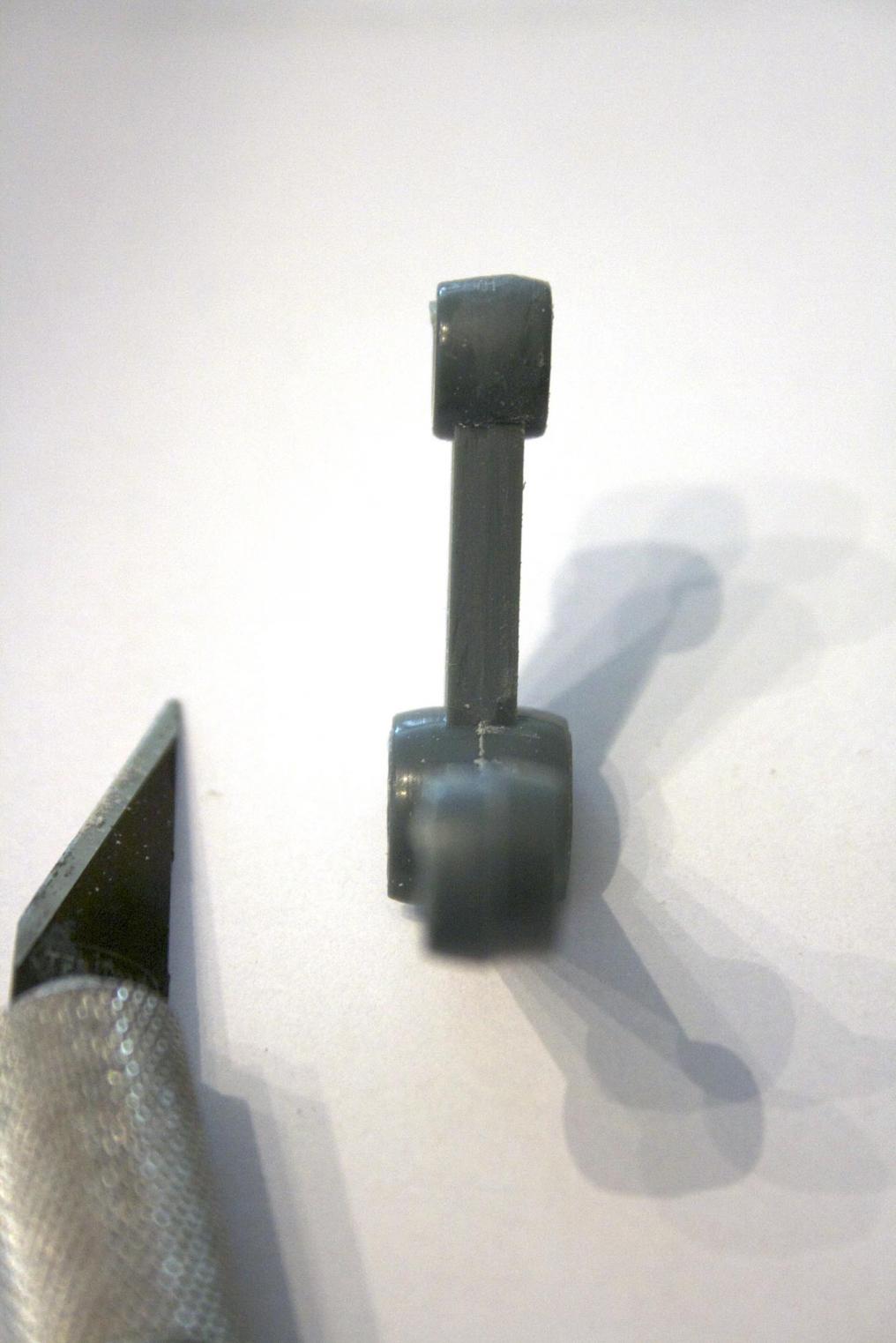

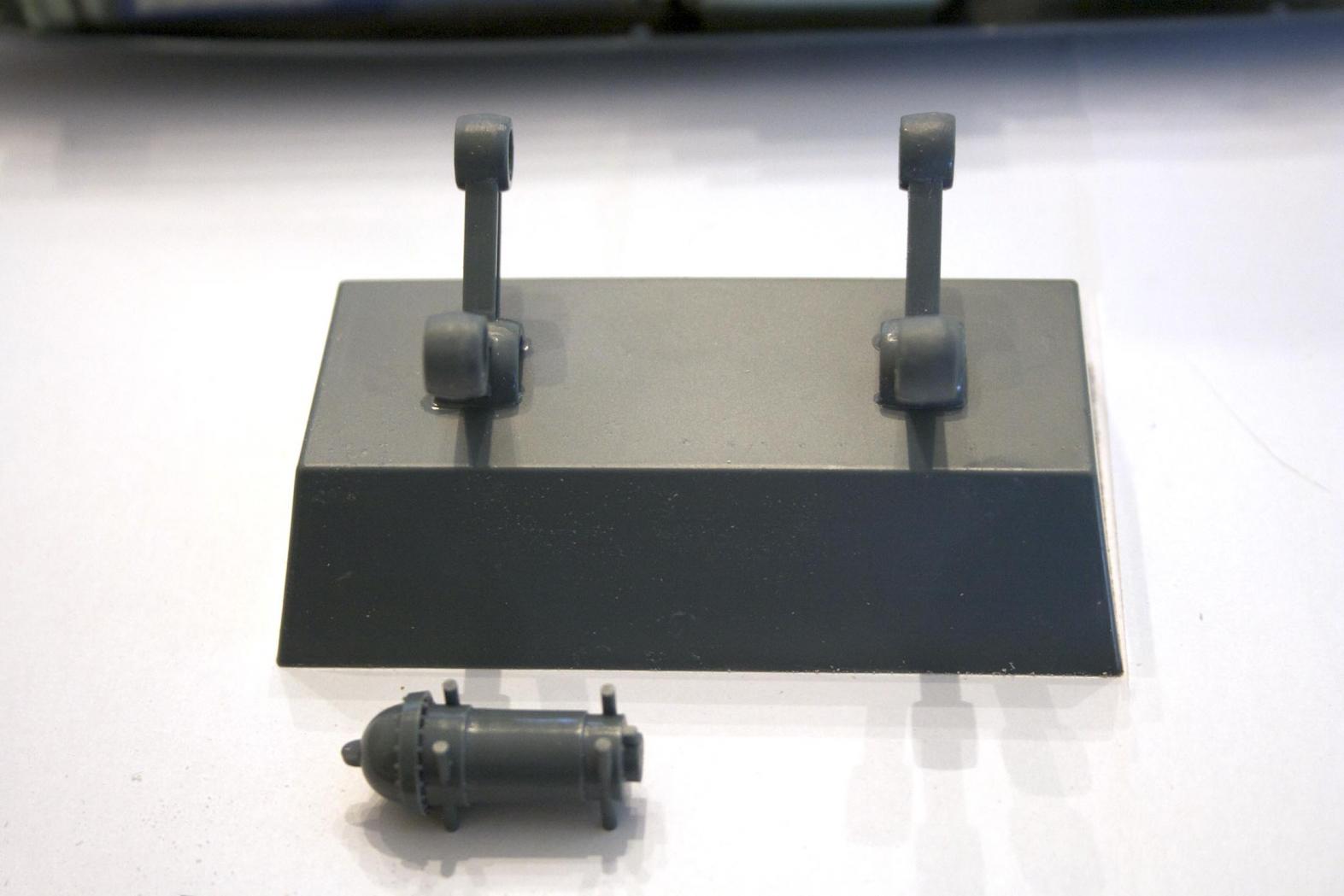

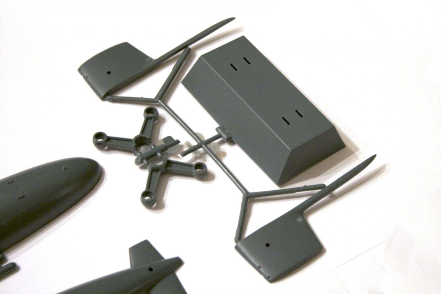

                        This is the stand piece with the seams on. I learned to take off the seams.
                        This is the piece without the seams, I used a x-acto knife and file to do it.

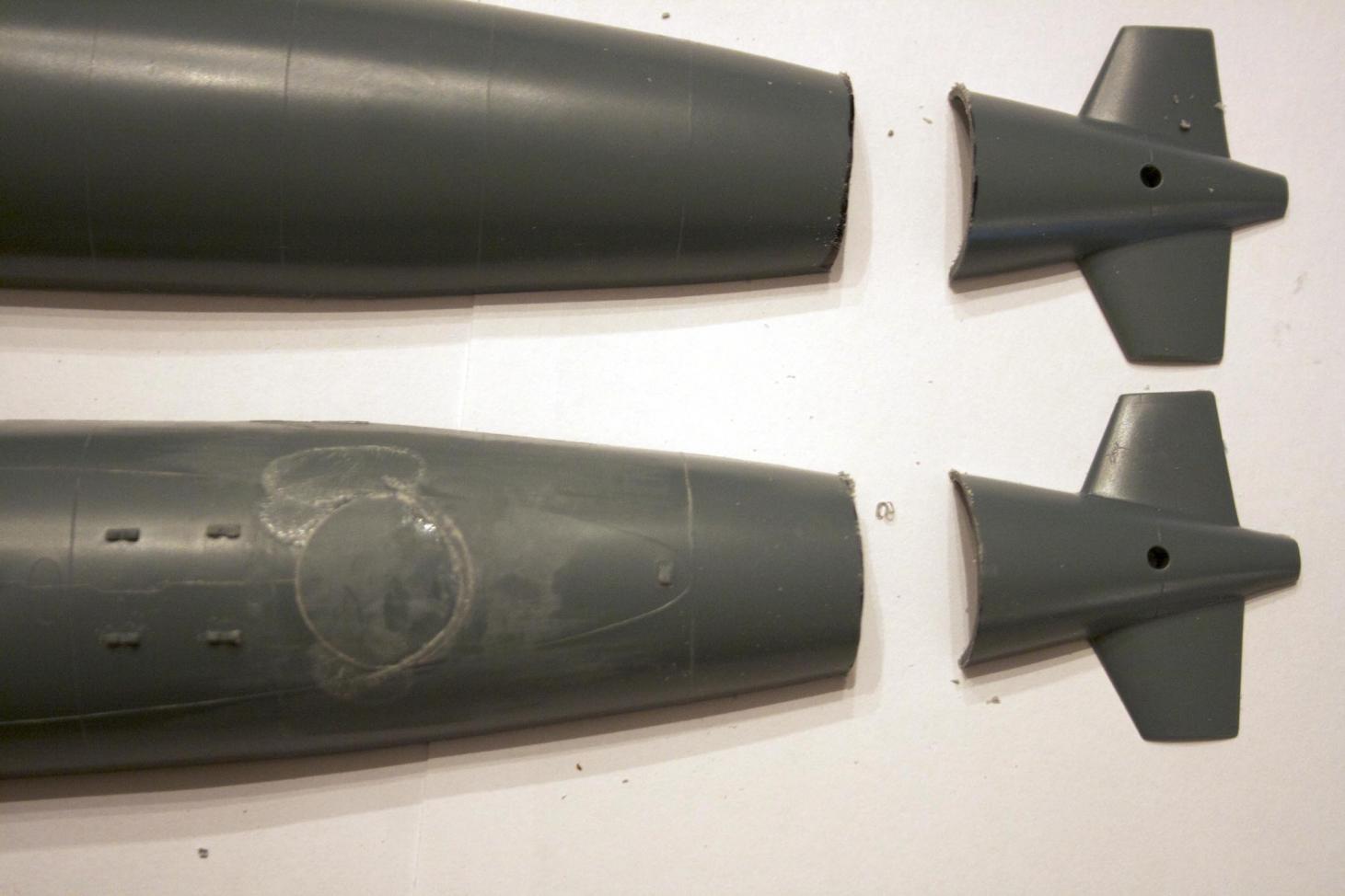

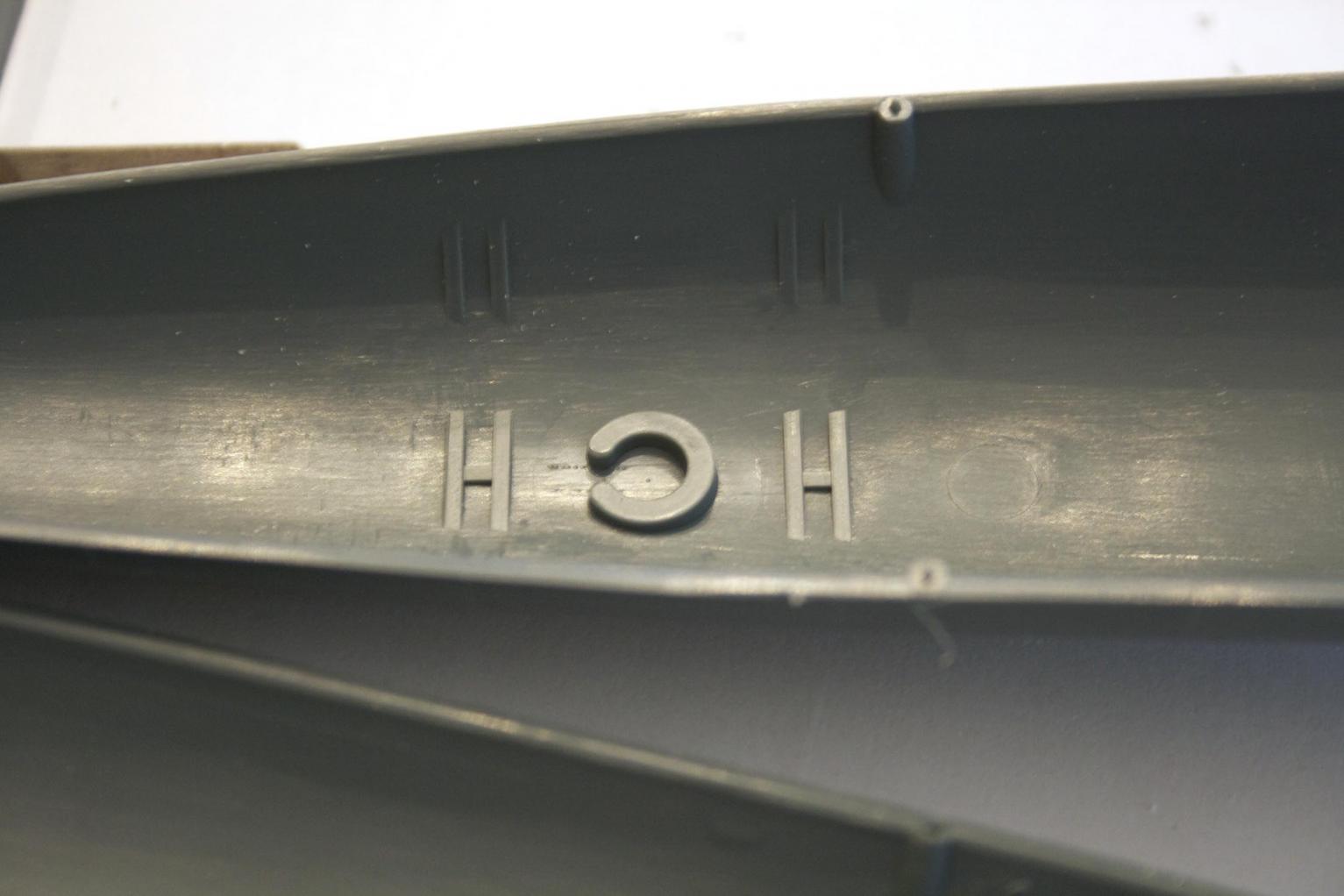

                          Here are my other pictures from last night.

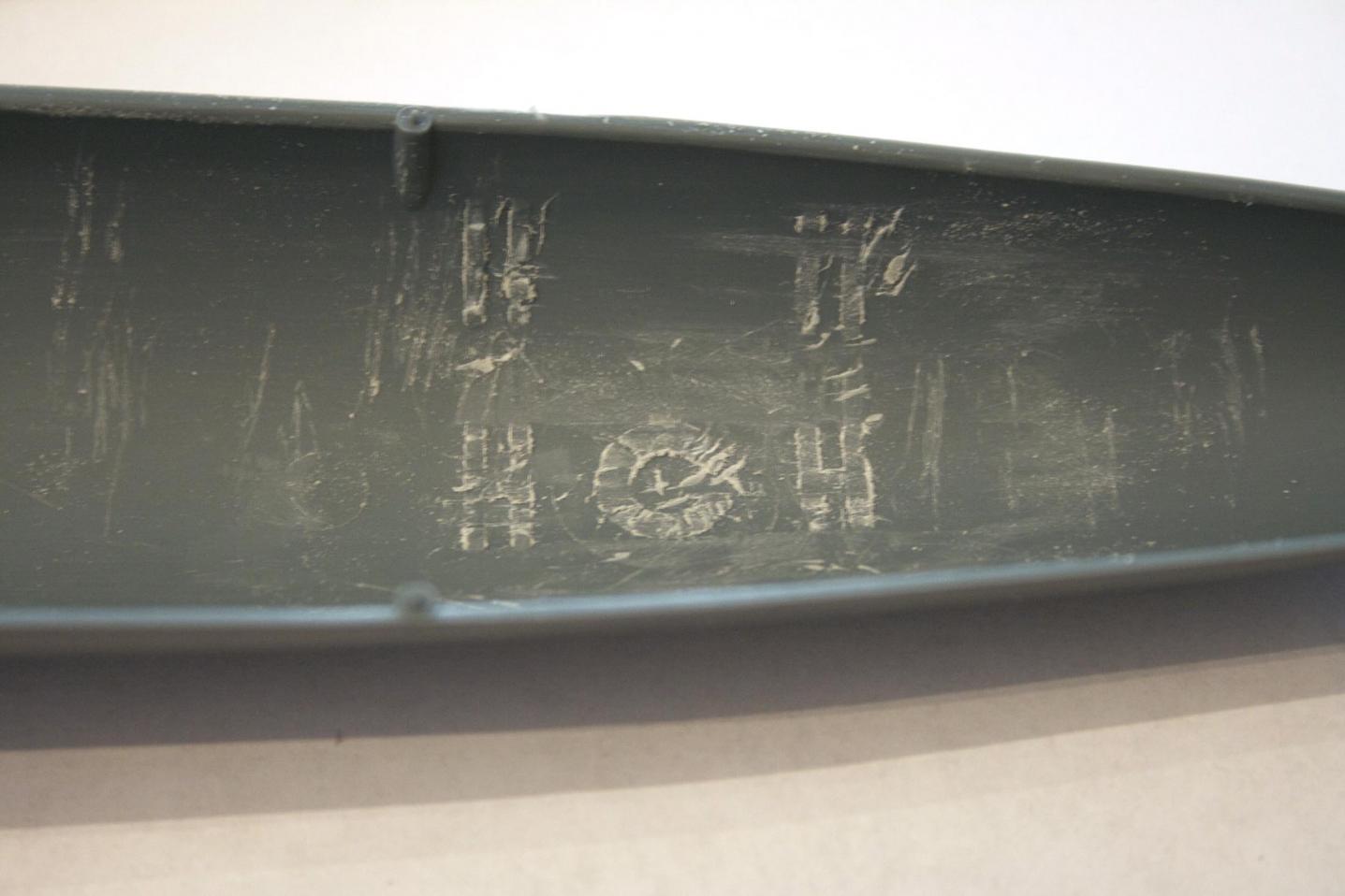

                          This is my stand and the round object is my nuclear reactor. I kinda like the reactor but we're not going to put it in.

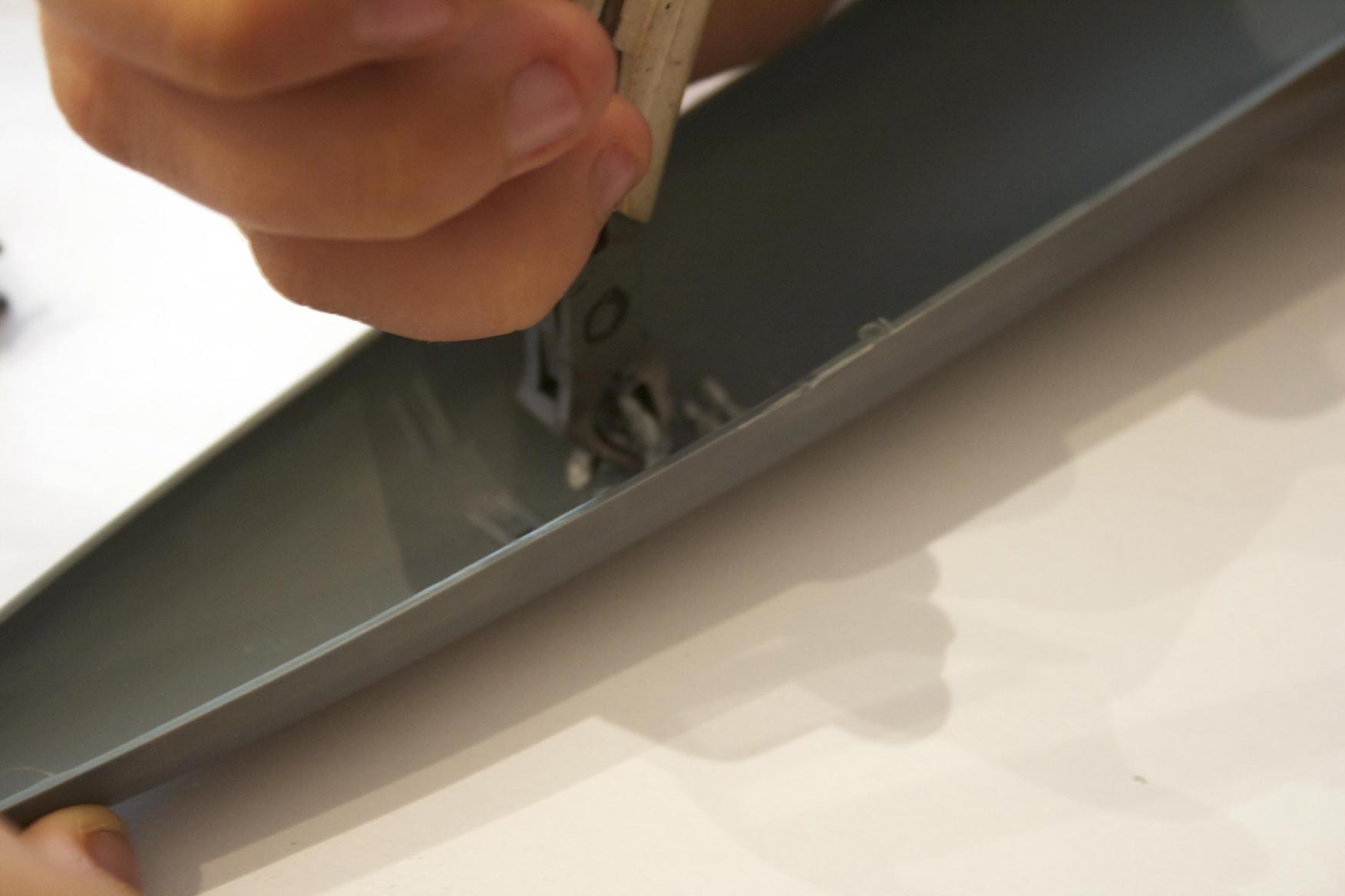

                          This is my piece that holds my reactor and walls and we're going to sand it off.

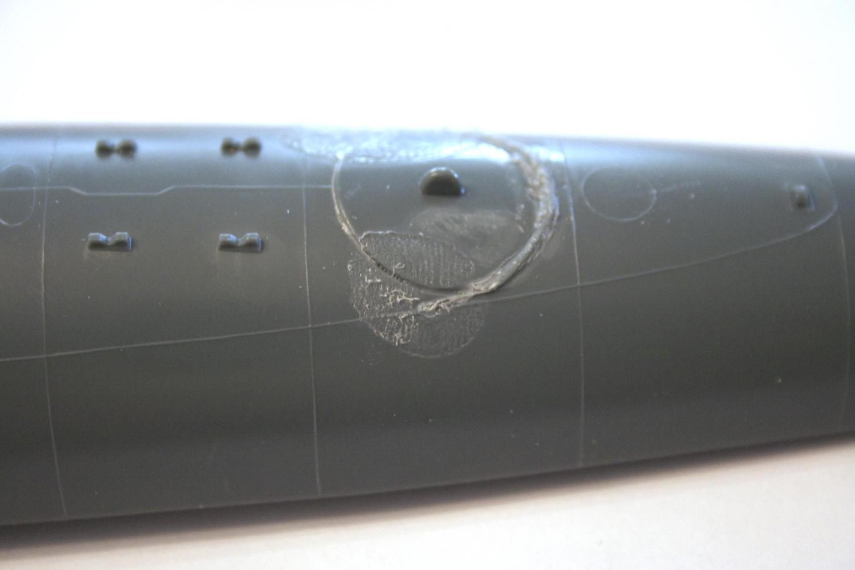

                          This is my hatch that we're going to fill in with plastic. We're going to sand the bumps out on each side of it.

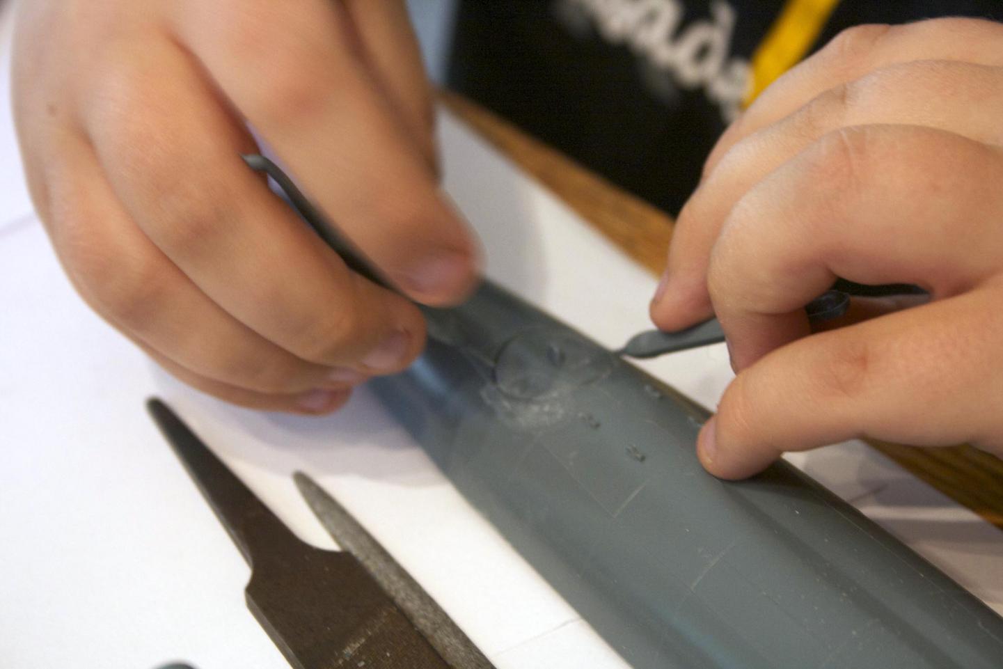

                          I'm trying to clip of the bumps on each side of the piece that holds the reactor in place and I'm going to sand that to.
                          This is what the sanded version of the submarine. I also used a x-acto knife to shave plastic off.

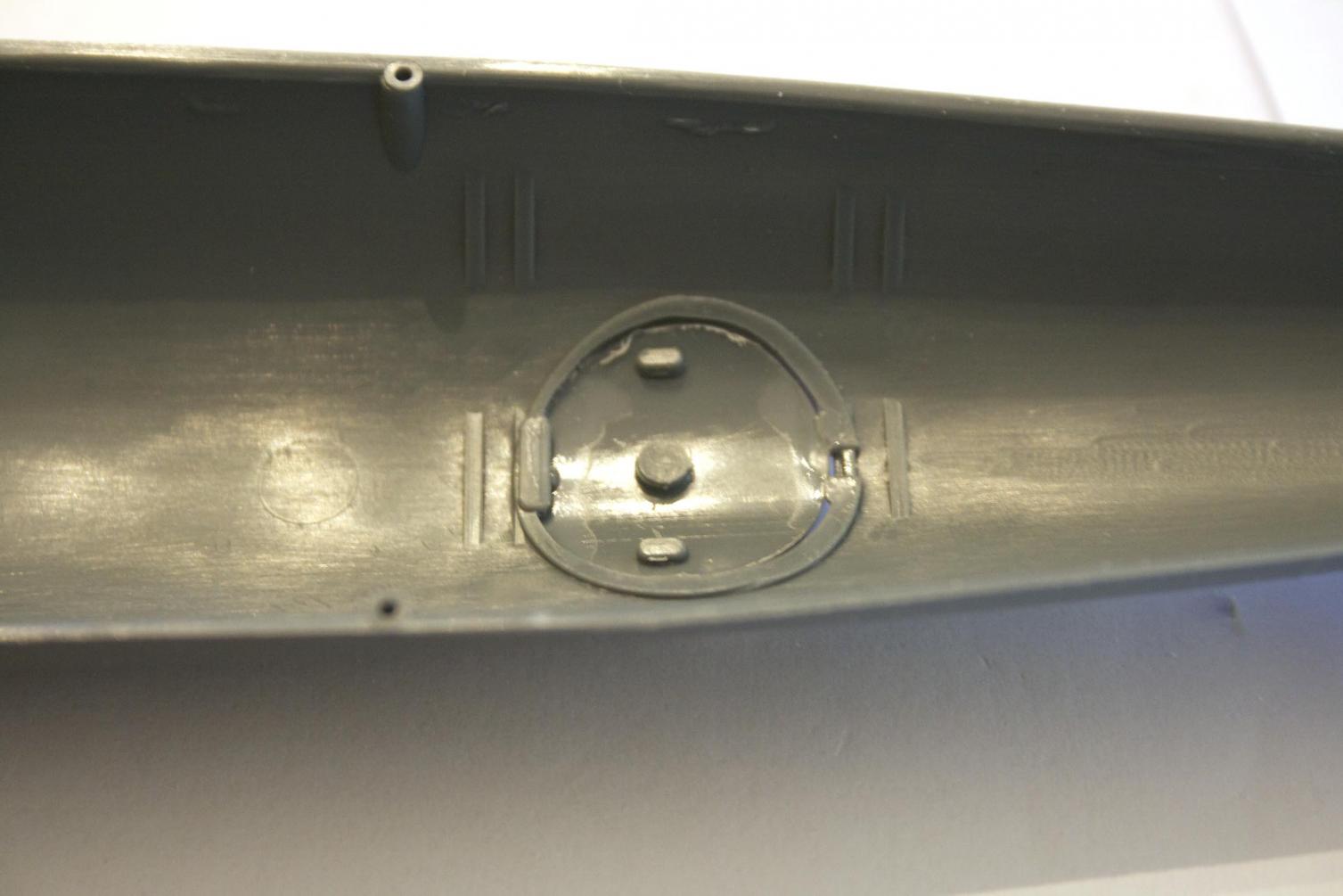

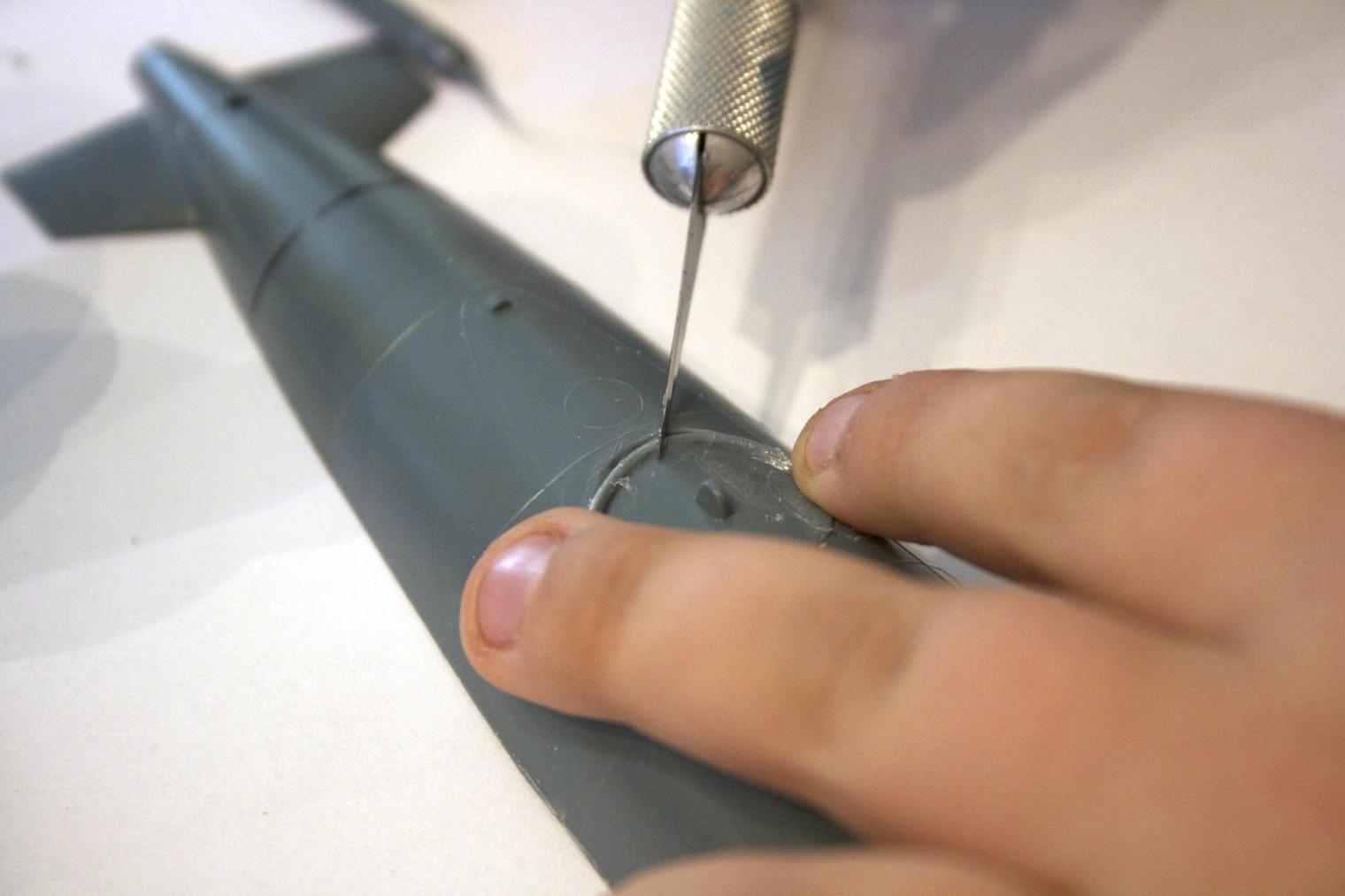

                          I've learned how to put plastic in the gaps inside the hatch on the submarine. Using cohesive glue to melt the sprue, it was smashed into the gaps.
                          Here is my hatch and I'm using a x-acto knife to push the softened plastic in place.
                          Here is what the hatch looks like with the plastic in place. I learned the difference of cohesive and adhesive glues.

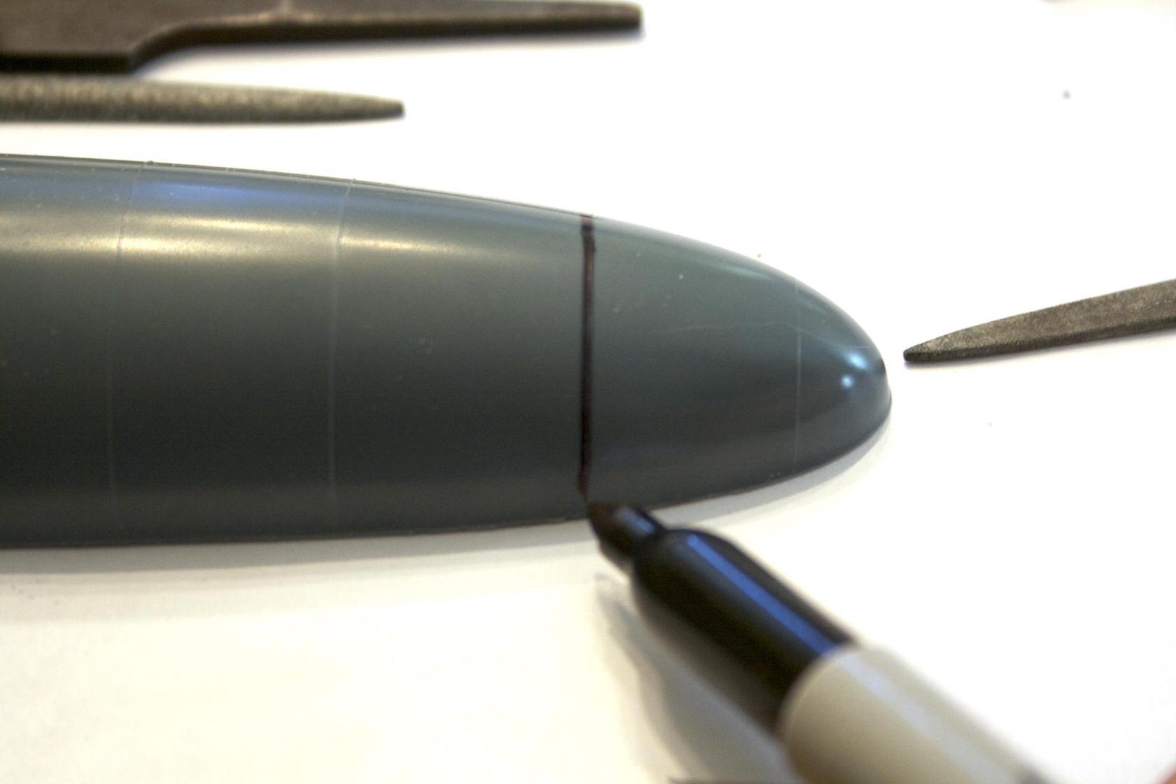

                          My dad thought we should mark the bow with a sharpie.

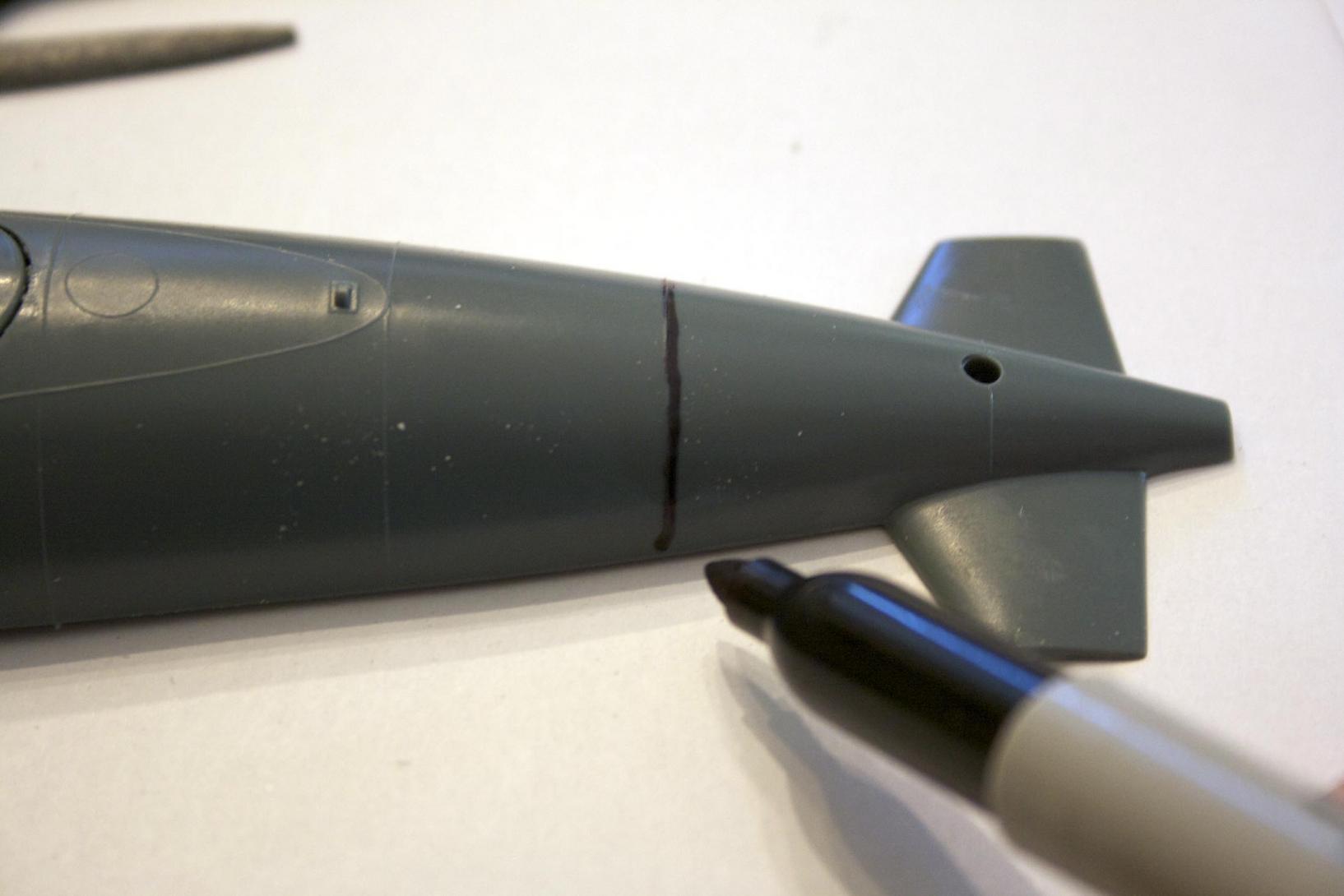

                          We did the same thing here but we will cut it off. Dad felt it is important to place the aft end in for prop alignment.

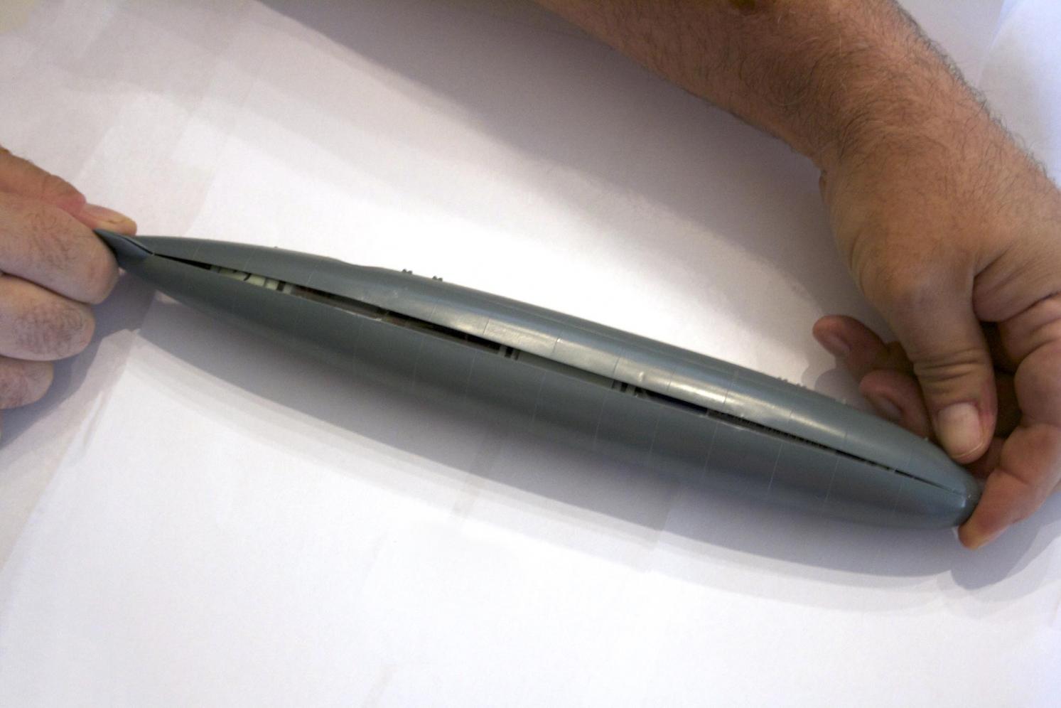

                          This is the bottom half of the sub with the Sub-Driver in the submarine.

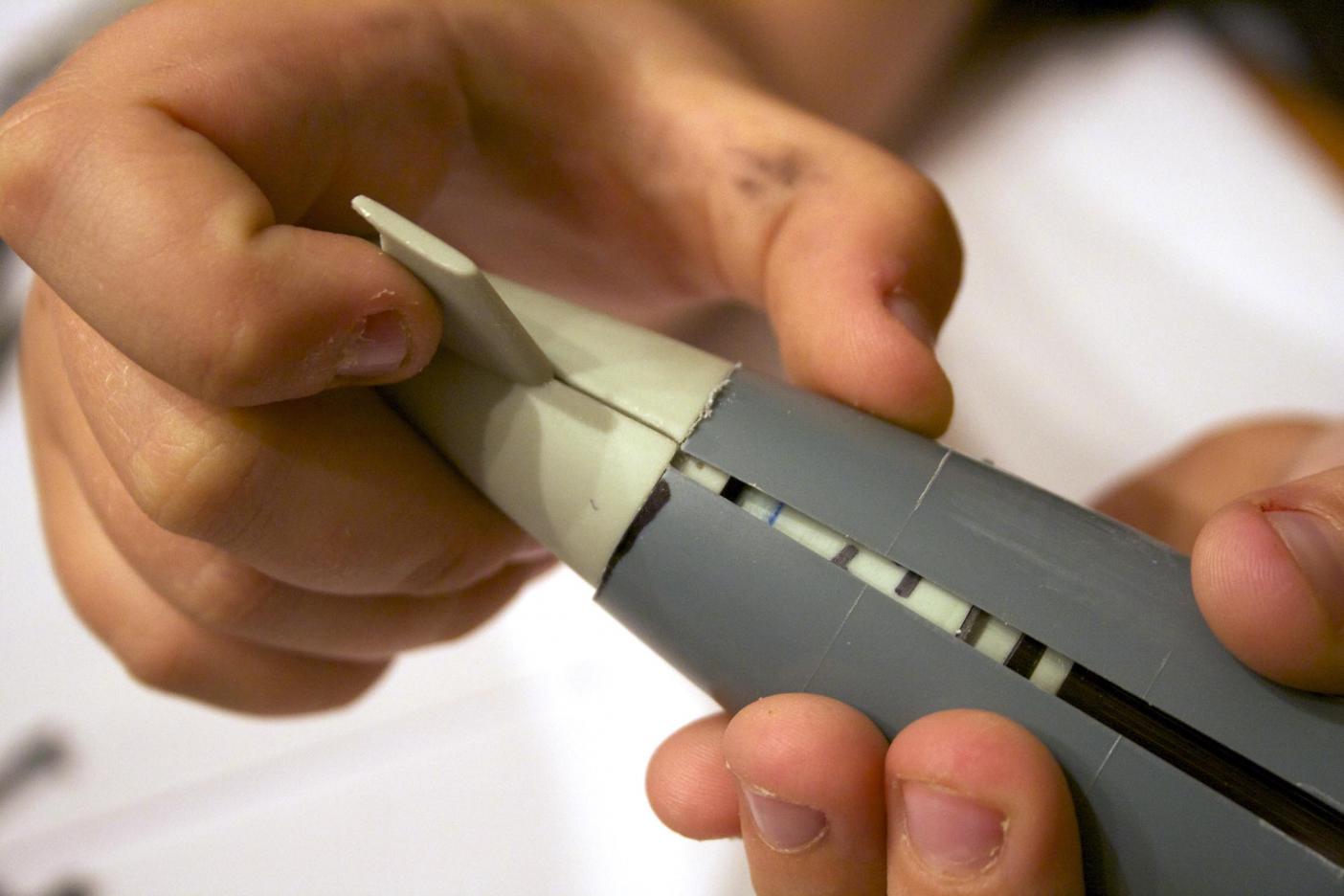

                          This is what the aft pieces looked like after we cut it using a saw.
                          This is what our sub looked liked after we temporarily put the aft pieces in.
