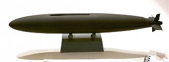

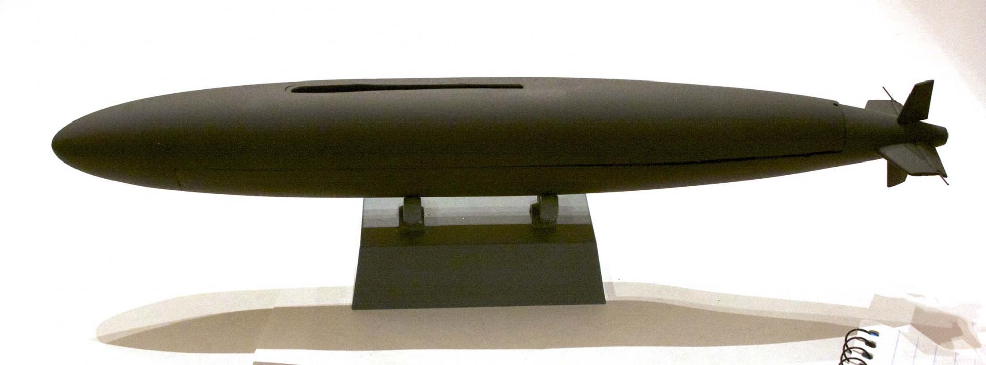

    It is a very busy time for Sam (and all of us). All the Christmas dinners and plays plus horse stuff (rodeo is winding down, western pleasure is starting up). So I have continued some small stuff and some unnecessary details to keep this moving forward and not stagnant.

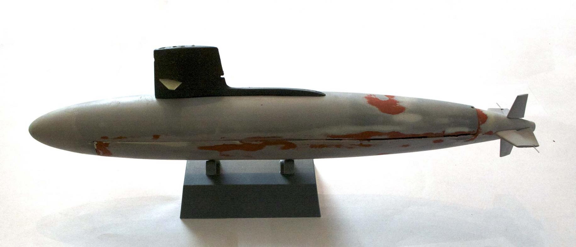

    The hull got a good sanding and filling with Nitro-Stan. After wet sanding at 400 grit, the hull was painted.
ID:	92758 Click image for larger version

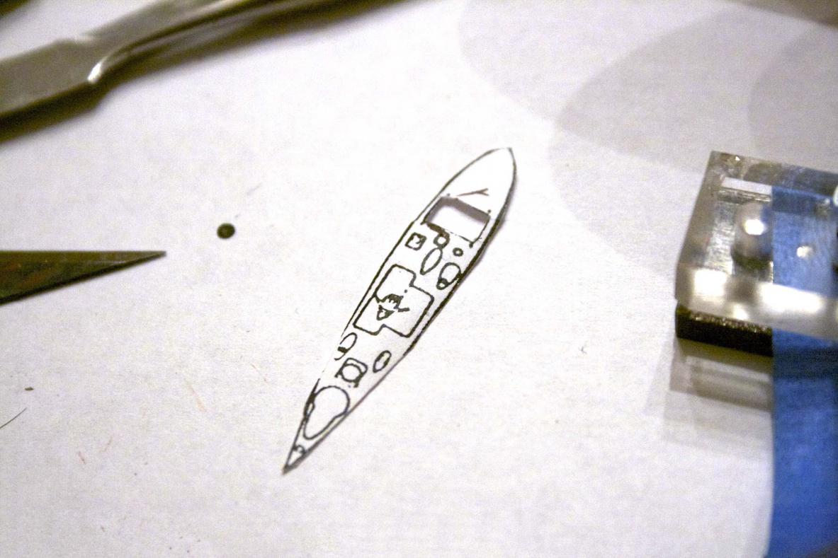

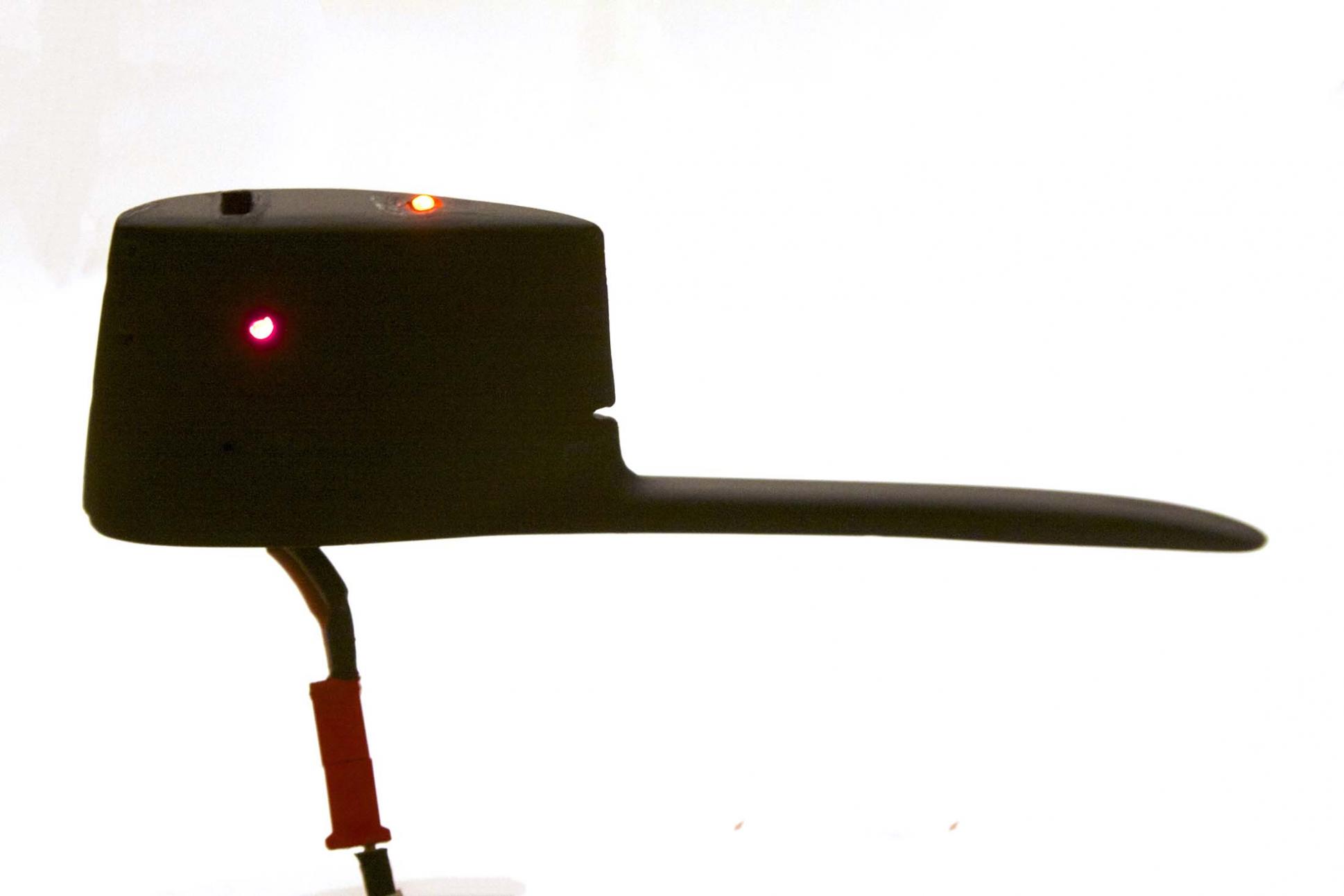

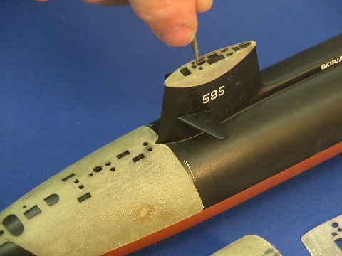

    Pleased with the hull I moved to the sail. Using a copy of the plans included with the fittings kit, I cut out the top of the sail. Then cut out an opening I wanted to duplicate on the sail. This is to let air out. Since this boat a true dynamic diving sub, it will set low in the water and there needs to be a path for air to escape.
    I also domed the top of the sail and put a sharper contour on the leading edge of the sail (some of the stuff not necessary to do to get this sub going). This meant I needed to paint the sail again. So to prevent painting the LEDs, I punched out some dots to cover them (you can see the dot size in the photo above - a little past the tip of the x-acto blade).

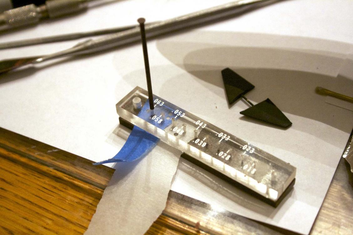

    Waldron Model Products was a company I really liked. Looking for a link, I discovered they are no longer around. I love their punch and die sets. Here is what I used to make some small dots.

    After spraying, the dots peeled off the LED using the tip of the blade to gently lift the tape off.
    Tested the lights again and they work.

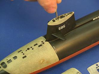

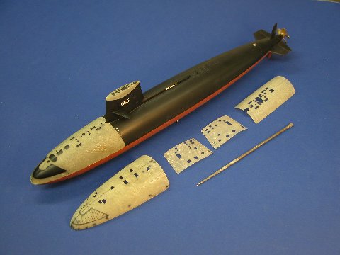

      David shared some photos that he did in scribing his little Skipjack.
ID:	92806Click image for larger version
      This would be fun to do for Sam. I shared that with David and he said he would loan me the templates. How cool is that?

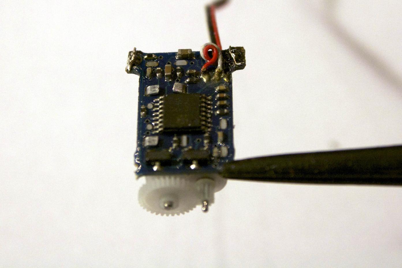

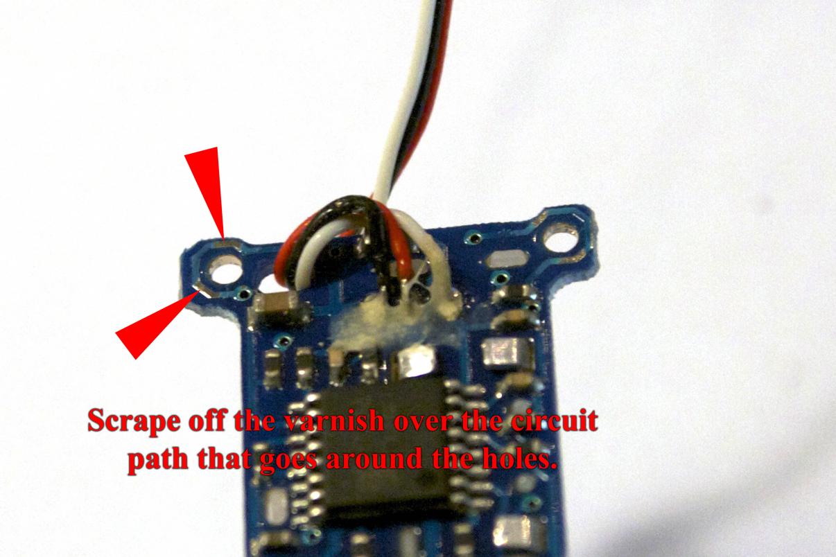

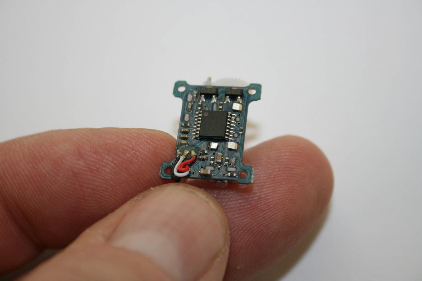

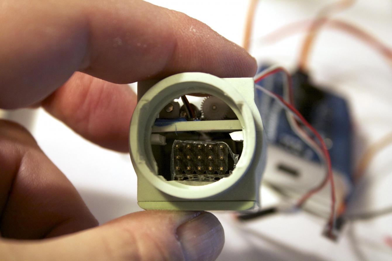

        I have not used these micro small linear servos before, so this was new to us.

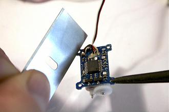

        Look closely at this servo, there is some circuitry paths going around the holes used for mounting the servo down.

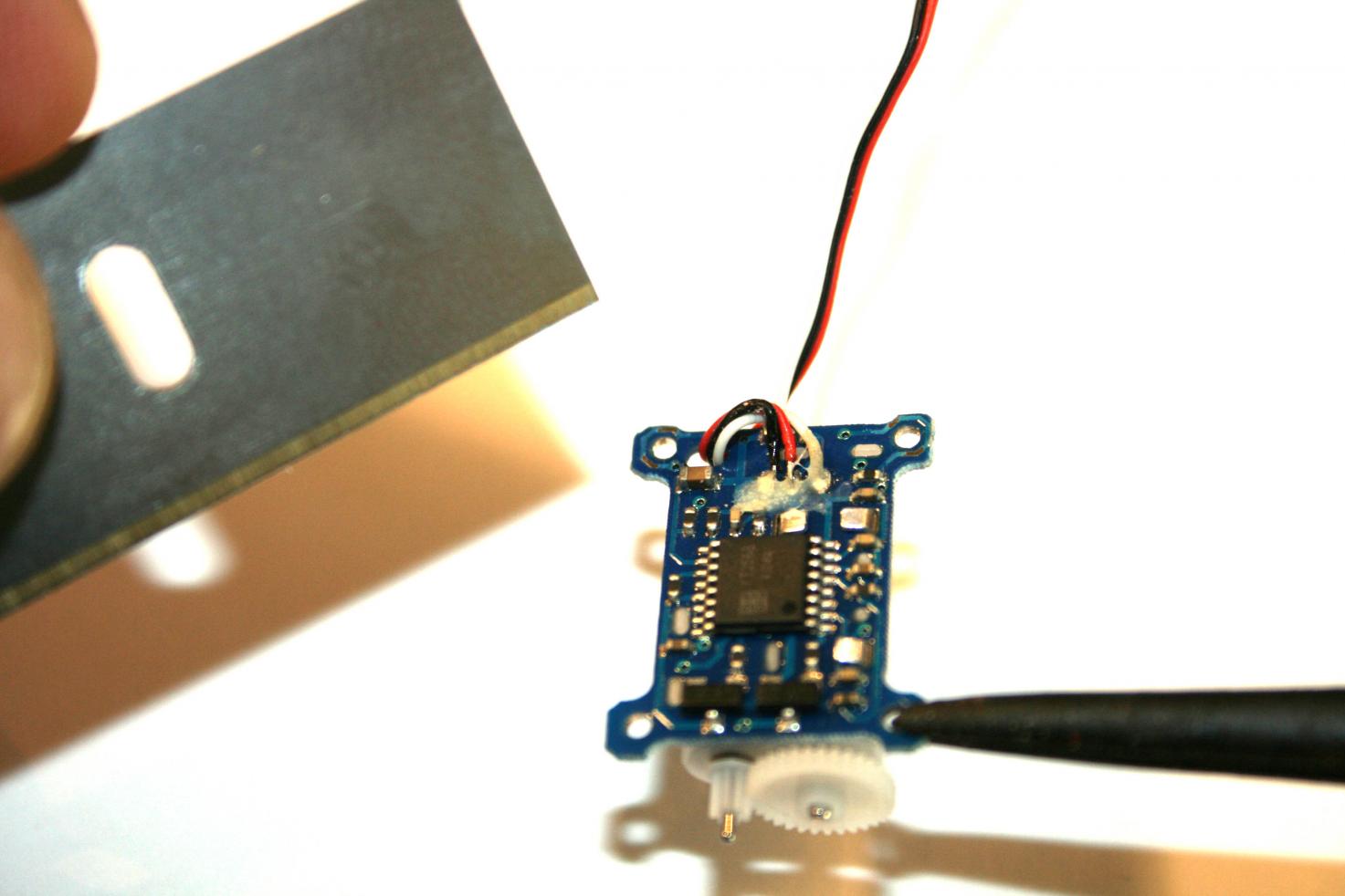

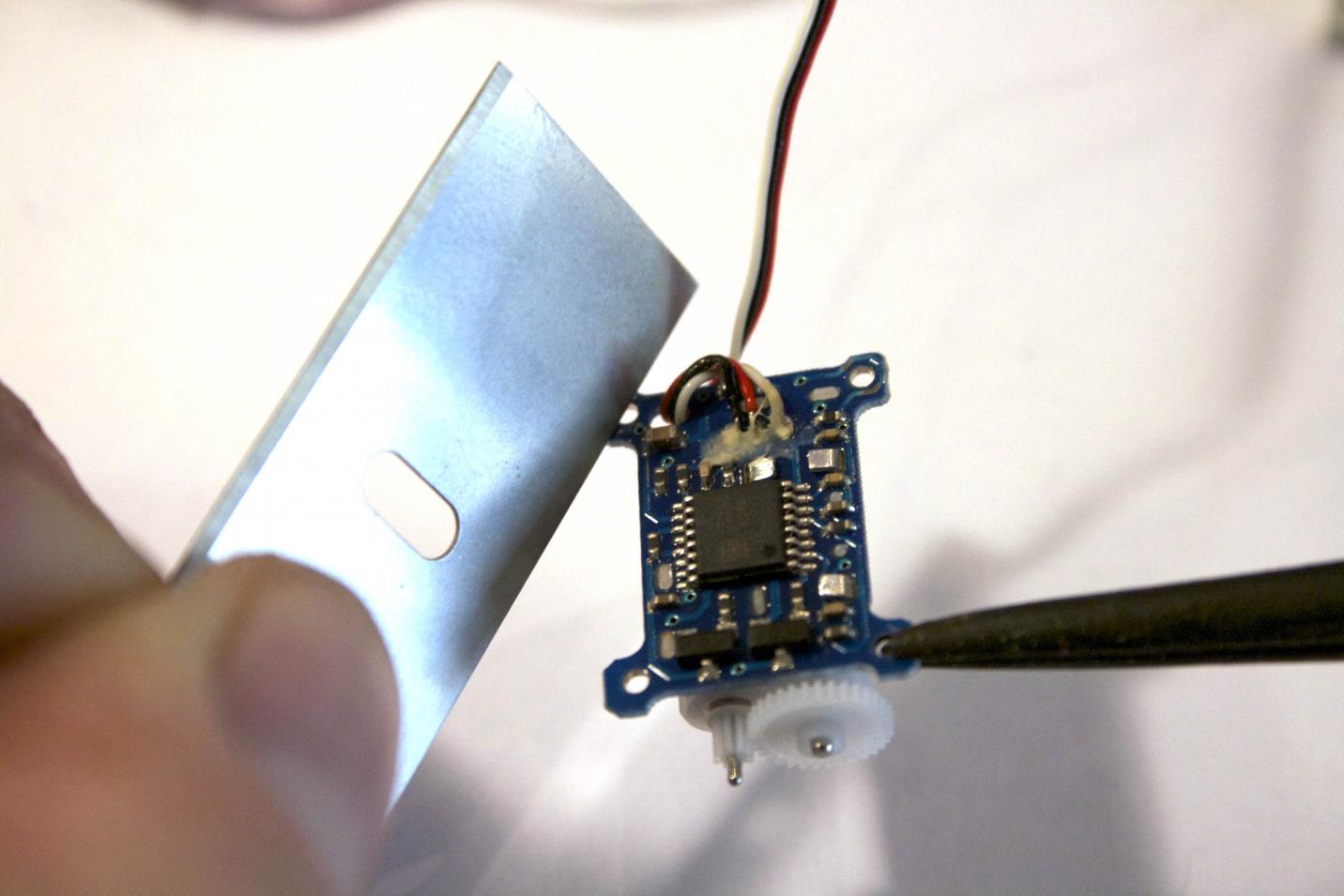

        Two servos side by side are a little to wide for the servo tray. But I learned that trimming these servos will allow it to fit.
        I took a single edge razor blade (any sharp edge would work) and scraped the varnish coating off the circuitry I needed to solder.
ID:	97650Click image for larger version
        Did that to both sides.
        I soldered a small wire across the hole to each bare spot I created to jumper across. Then I took up drinking. What a pain.
        Tested the servos and to my surprise they still worked. Then I got brave and cut the outer portion of the loop and tested the servos. Still worked.

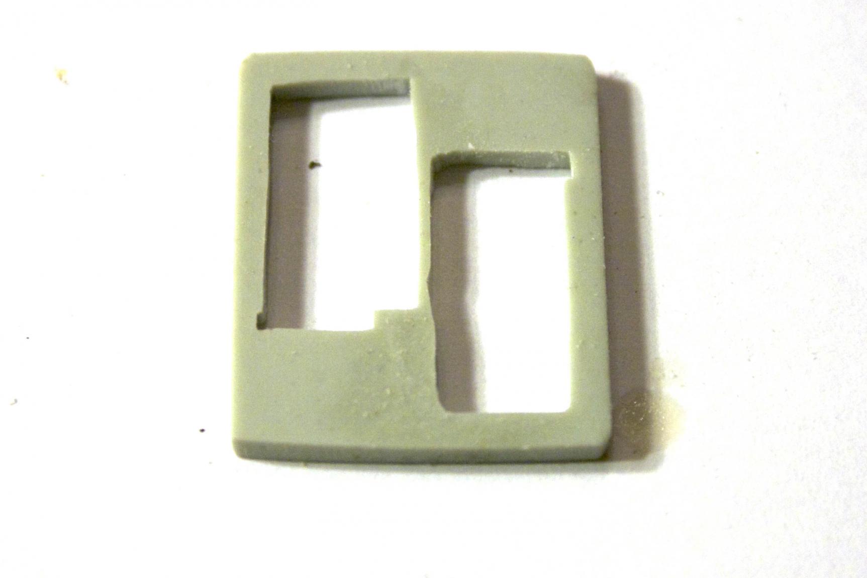

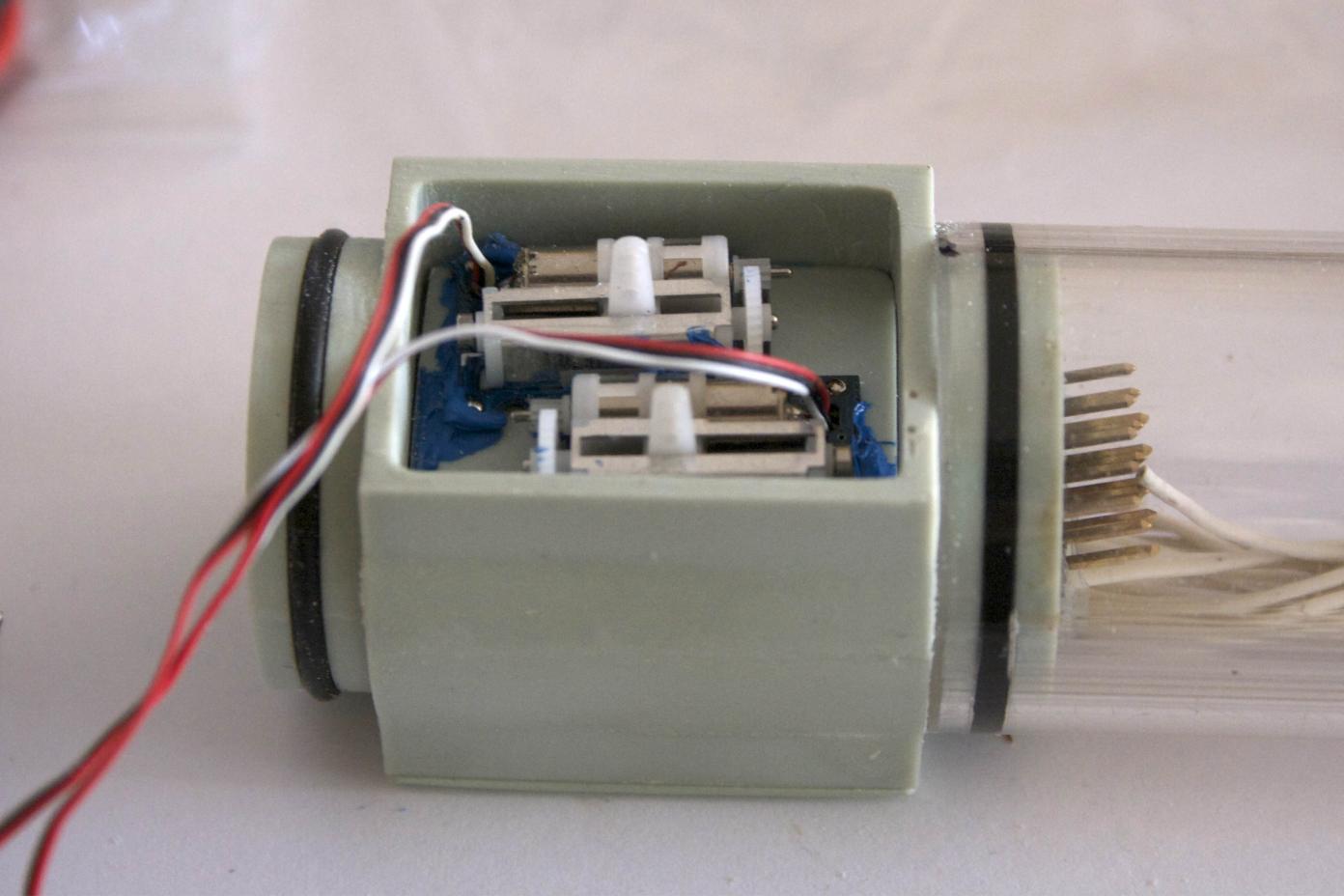

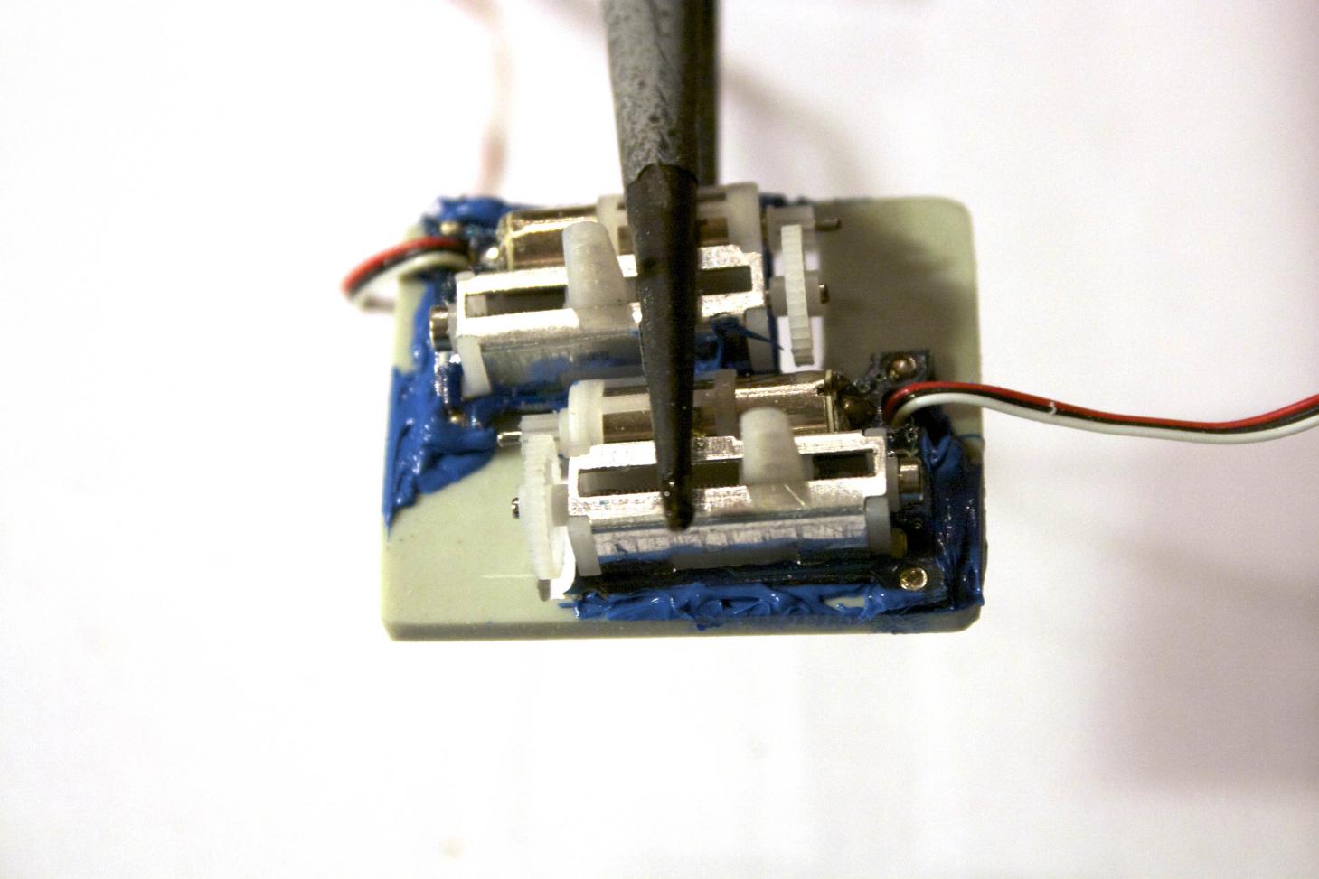

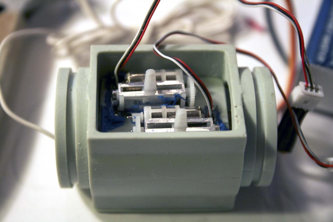

        I laid out the servos and cut out a hole to allow the components on the underside of the servos to fit through.
        I affixed the servos using RTV rubber and held them down until it all dried. Tested the servos again. They worked.
        A little filing and the shelf fit in snugly over the receiver.

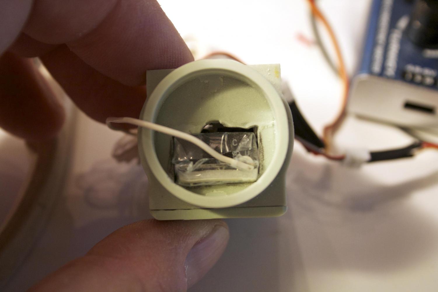

            Thank you Manfred, yes, he was pretty energized to do more soldering, so today he practiced more soldering. While he did that I worked on getting the receiver to fit inside and the servo shelf put in.
            The end of the RX was outlined on the bulkhead. Also marked where the corners of the RX meet on the other end.

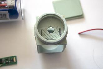

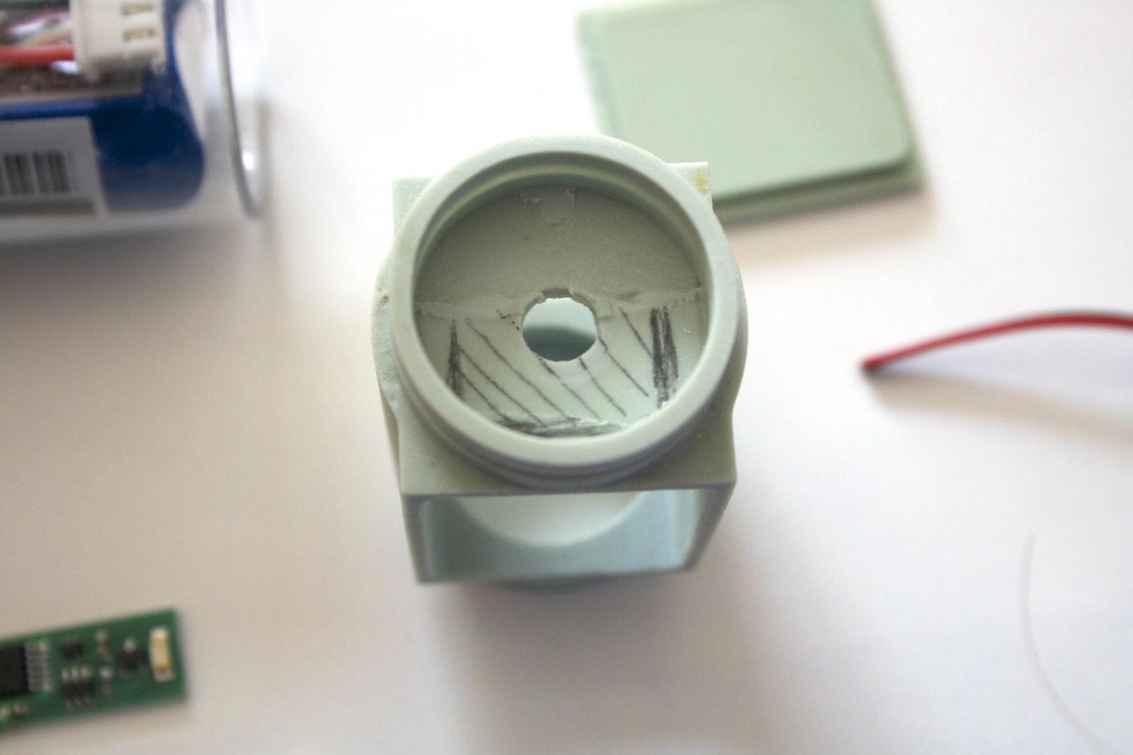

            After cutting out the profile, some filing was needed to smooth out edges and refine the fit. There will need to be another hole to pass wires from the battery to the other end, but we can work on that later.
            On the other end, a flat file was used to put some notches in for the receiver. The inside of the tube portion has the sides tapered for the batter to fit better. You can also see the tabs (just scrap styrene cut into little squares) installed to hold the shelf. A dab of RTV on each tab will hold the shelf in.
