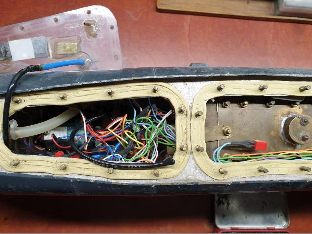

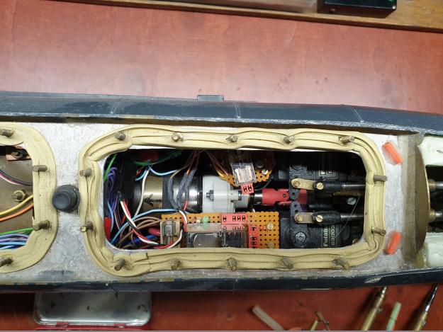

              Front and rear hatch opened to get the stuff out.

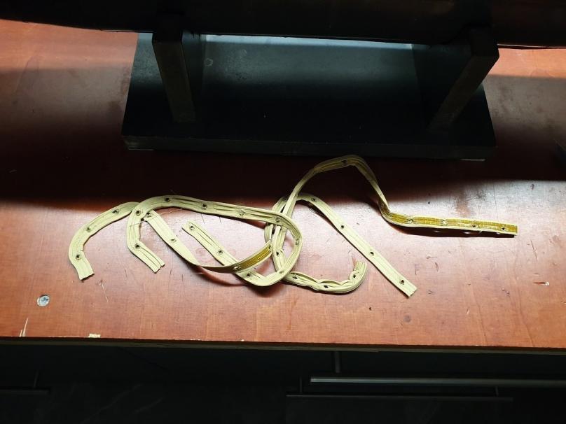

              All hatchseals where shot, they will be replaced by new rubber.

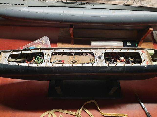

              Middle hatch opened and took loose the peroscope stuff.

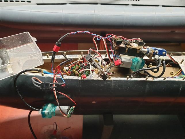

              Peeled out the cables at the front to get to the receiver batteries.

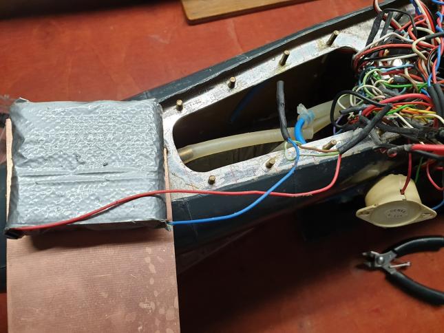

              Five Eneloop cells, giving me 6V 2500 MaH, more then enough to run her for a few hours.

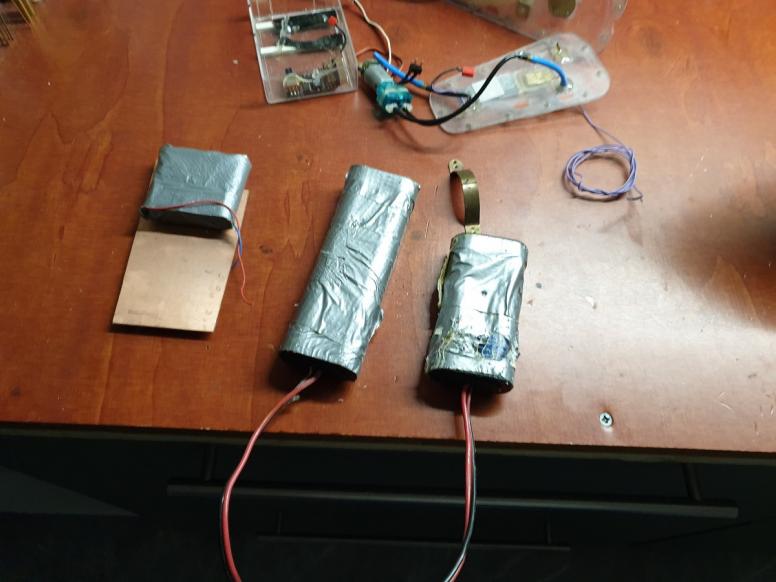

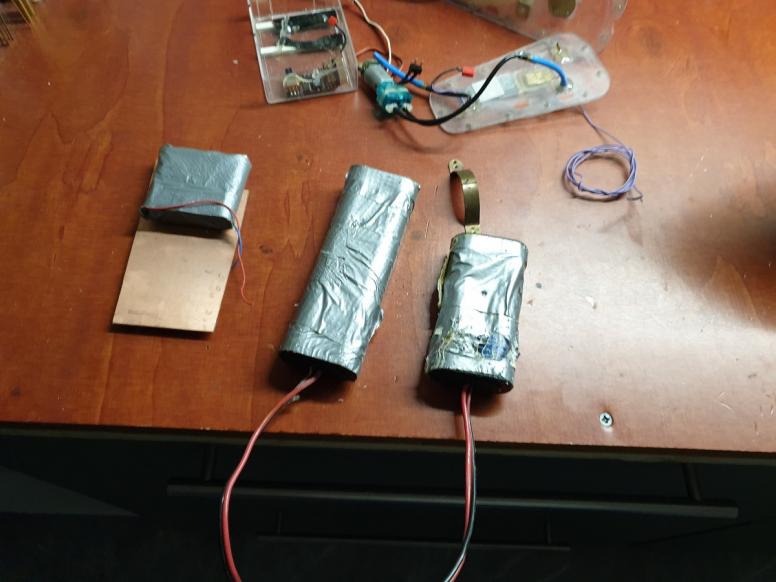

              Main batteries removed, 12V 5000 MaH, giving me a drive time of about 2,5 hours.

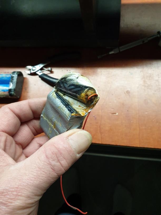

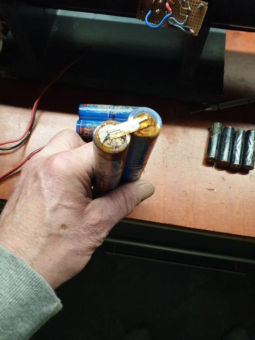

              The state of the receiverpack, corroded due to moisture.
              Same story on the main batteries, they both held it for twelve years, so it was time to get me some new batteries.

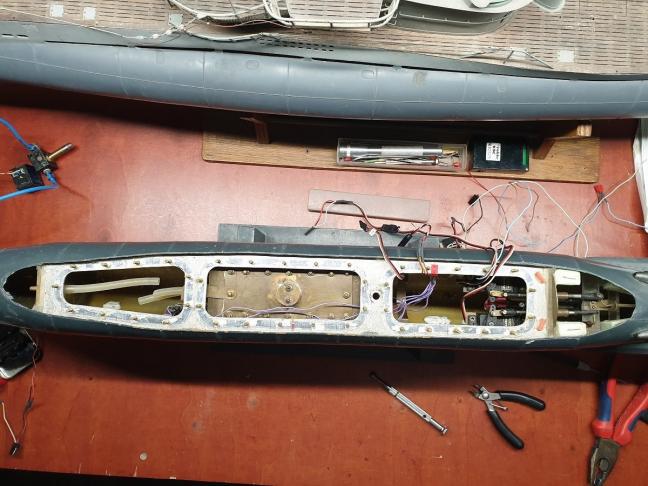

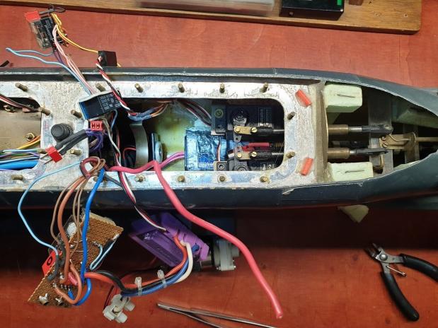

              Hull completely cleared of all components, left the rudder and diveplane servo's in, no need to get them out.

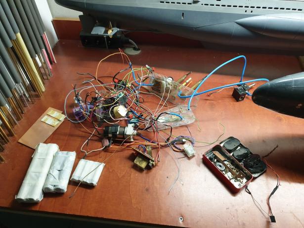

              This pile got out, i want to avoid this mess of wires in the rebuild.
