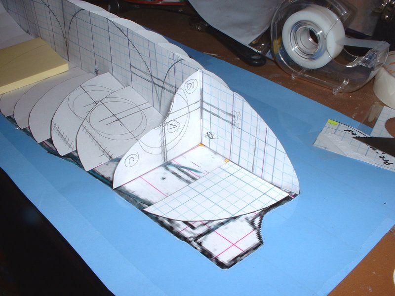

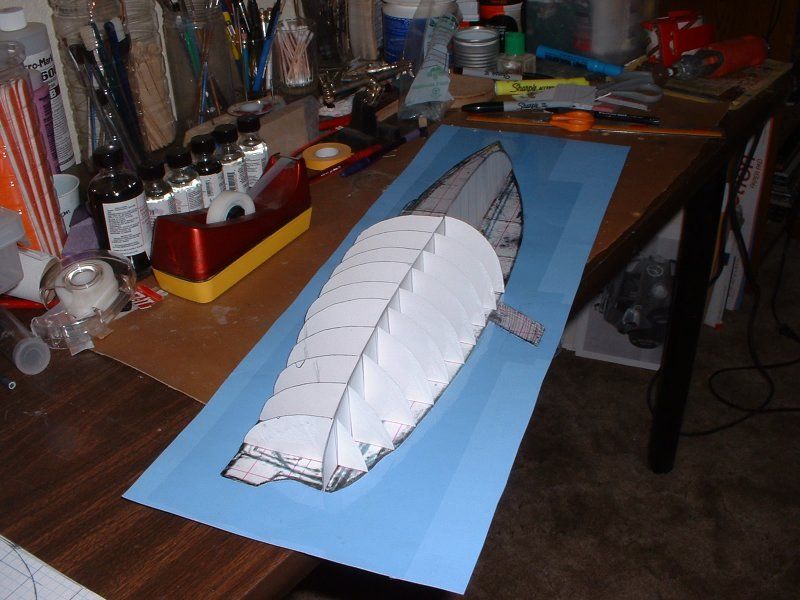

    Okay. Things are starting to move right along, now. There's still oodles we'll need to adjust ... but we're getting a 3D shape roughed out. I had begun at the midsection, and moved backwards ... partly because the rear of the craft was probably easier to "see" than that strange bow! I had "saved that for later," on purpose ... figuring that making the stern "look like something" would give me confidence to deal with the bow.
    Sometimes, inertia is your biggest enemy. A good friend of mine has a saying I like, a lot: "Do something, even if it's wrong". I wouldn't advise such a course of action, if dealing with toxic chemicals or lethal voltage levels, etc. ... but when dealing with paper "slices": hey, why not?
    Most of the info above, as you can easily see, can't possibly be ready for prime time! But it's a starting point. And perhaps more importantly: it's a starting point that's based, not on a "wing it, by eye" sort of "seat of the pants" vague feeling of what the original thing might have been shaped like. It's a good starting point, which sorta-kinda makes sense in some areas of the craft ... that began with a historical "blueprint"!
    Had that blueprint included a plan view drawing (top or bottom) ... or even some nice, orthographic "end views" we could avoid a lot of what we're having to deal with, in these steps. But with this methodology, you can still get there. It takes serious thought, and some "bravery" (to not want to look foolish, or crazy; especially in these very early "baby steps" phases of "figuring out the shape") ... but the sytem works well enough to get you to the point where you can, without much fear of loss or embarrassment or whatever, start shaping "solid parts".
    We're clearly not to that point, yet ... but compared to only having a side view drawing, and one cross section, we're light years ahead now!
    • Steampunk
      • Feb 2010
      • 62

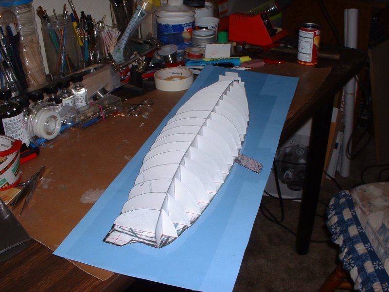

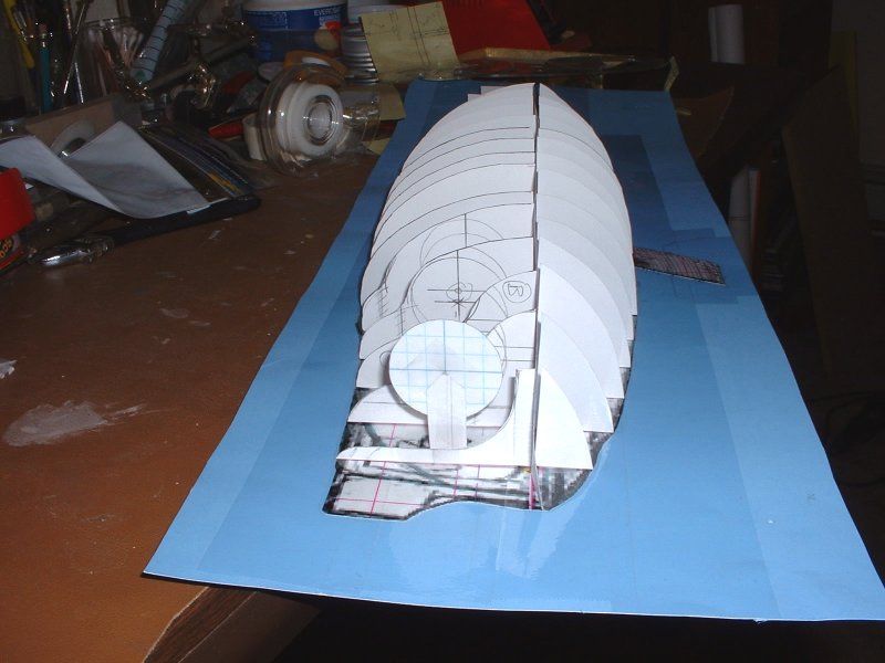

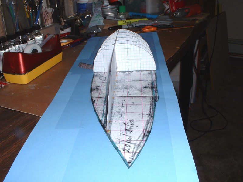

      What's needed, at a point like this, is some "resting your eyeballs" time.
      Which is exactly what I did, once I had that initial work in a form where I could look at the overall rises and falls and curves, from multiple angles. I literally stuck the whole thing up on a wall, for multiple days ... and just left it there, without making any changes to it.
      Over time, certain areas will "jump out at you". When they did, what I did to deal with it was to simply write myself a Post-It Note, describing that one problem. And not worrying too much, yet, about a solution. That will come later! For now, you just have to let your head wrap itself around the overall proportions, outlines, and contours you have created. Get used to seeing what you've done. Good areas will be there. And some that just flat look wrong. And many that you can't decide if they're right, wrong, or just plain confusing. Just let it all sit, untouched.
      • Steampunk
        • Feb 2010
        • 62

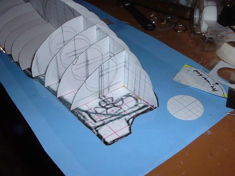

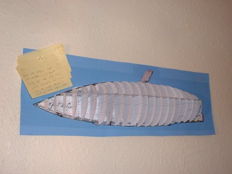

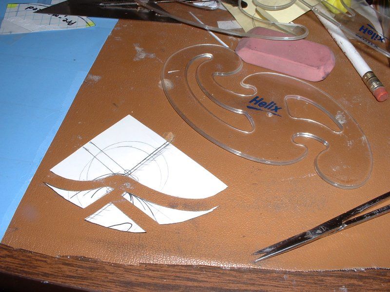

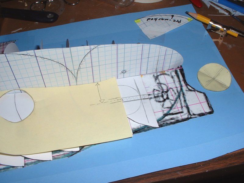

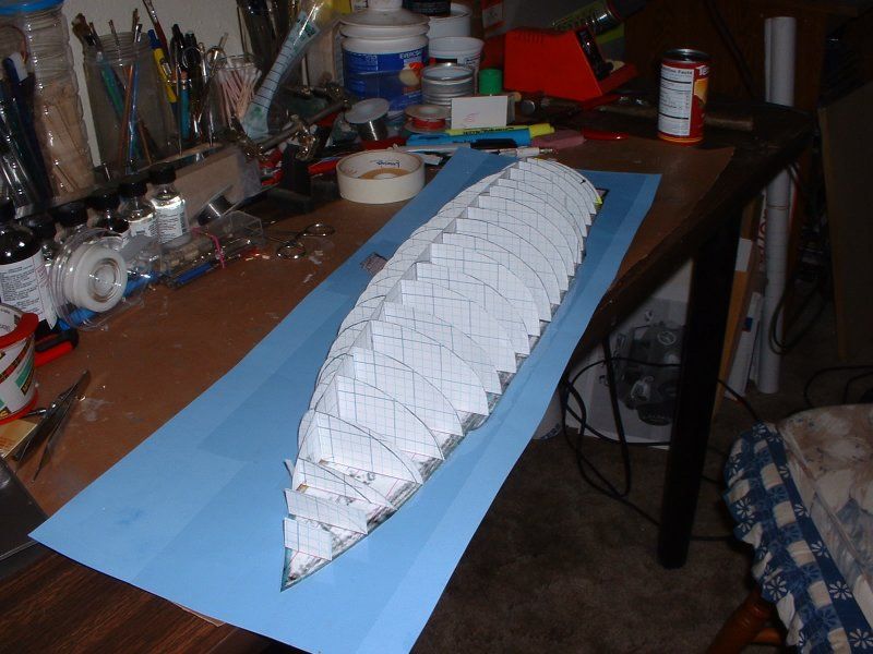

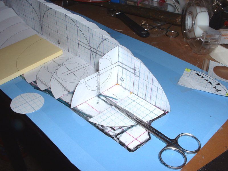

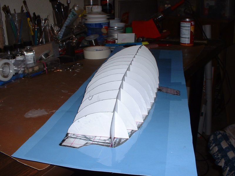

        At some point, a little bit down the road, I convinced myself that it didn't make sense to totally ignore one major task that, thus far, I hadn't dealt with. The props! I knew I'd need some sort of a "cut out" for them to be in. Some "negative" area where they could safely spin.
        So, while I still hadn't gone through my stack of Post-It Notes, and treated them like a "punch list" of items that needed fixing, I felt it was best to tackle that one major remaining problem, whilst things were still in the "cheap and easy" paper stages of things. I could do any fixes, elsewhere, later; but it seemed to make sense to deal, at least in an initial way, with that one major area of interest that I hadn't really done anything with, yet. So, the plan was for me to mostly just leave the whole thing on the wall, for a while ... but, I did a bunch of searching around, in various books and on the internet, to study "real boat hulls" from this same time period. When I felt I had enough info, I did this:
        After this, my collection of photos tells me I switched over to some MDF "wood" scraps, to continue the initial "seeing it in 3D" steps ... but I'm sure that if I went through the paperwork that's associated with this project, I'd likely find that I had "documented" each cross section's full shape, first. That is, pulled each section in turn off of the "spine" or side view drawing or whatever you want to call it ... and traced what I'd come up with, so far. Then, for purposes of continued study of the paper model, I re-assembled that "skeleton" and stared at it for a while.
        It'll probably take me a few days, maybe longer, to get my photo collection into some sort of reasonable order ... then, we'll resume this story. I'm anxious to show the steps I took, and the photos which resulted, when I arrived at the bow shape that I ended up with. It's based, more than one might think, on that 1861 dockside, eye-witness drawing by J. A. Chalaron ... but I'll take a break, and then we'll deal with the bow.
