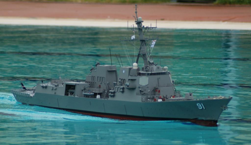

          one of my TF72 clubmates has a 1/72 Arleigh Burke USS Pinckney DDG-91 with a non working RMS in the side hanger. (How cool would a 1/72 RMS be!!)
Name:	20121006 TF72 Wagga-Mick_0004a1.jpg
          Cheers Bruce

            That would be the size of a AA battery.. Nice model.
