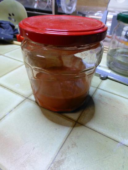

                  #68
                  I
                  (Whispering) Do not let He Who Shall Not Be Named aka M hear this, but I used rattle can paint, Krylon, and sprayed out of the can. Primer was also out of the can. If you decant your paint, please document that. I have not done that yet. Yes there are a lot of firsts and they continue to occur.
                  Really excited about the work you are doing and the fact you are documenting it too. Someone in the future will be looking for guidance and use your build!
                  I did it as per Hephaestus instructions.....instead of a nail I used a drywall screw....they have a very sharp point and are hardened.
                  You need a LONG jar, the process is accompanied with a lot of foam build up in the jar,
                  I was lucky the rattle can was almost empty.
                  Remarkably a few hours later my beloved wife noticed that a red dot had appeared in the lawn…..my proposal to do the hole lawn was rejected…..and from then on long jars appear from time to time on my table in the basement…....she’s the best!
                  I decanted the paint two months ago and it's still good.
                  Grtz,
                  Bart
