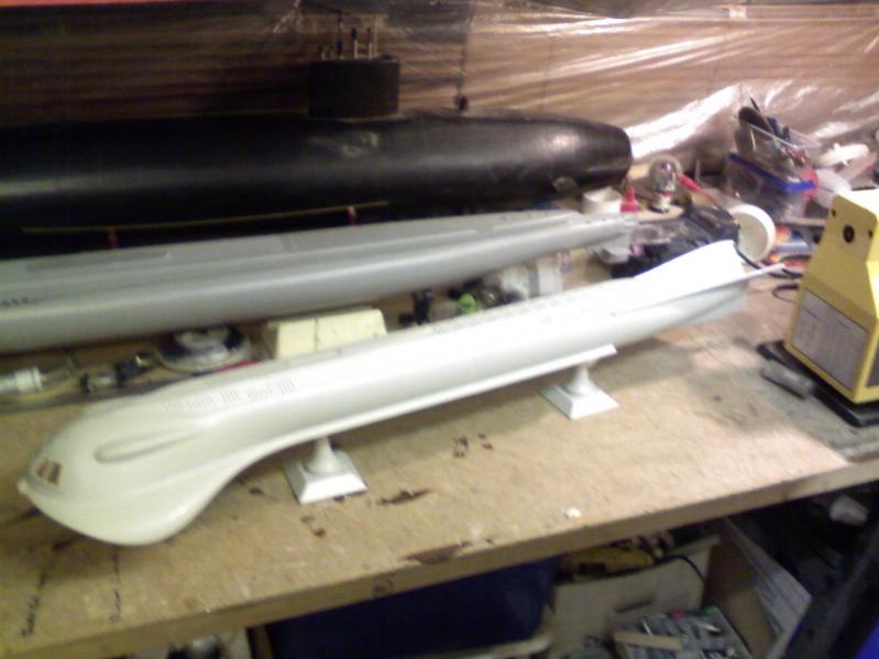

    I am new to this forum,and would like to chronicle the build of a couple of Seview Models.
    Originally I was building static for a couple of grand kid,however they "want them to work".
    A quick word with Mike and the fittings arrived today.
    As I said they were already assembled, so the first order of the day was was to dissassemble them not the easiest of jobs
    So for now just a few pics and I hope I can do justice to the boats.

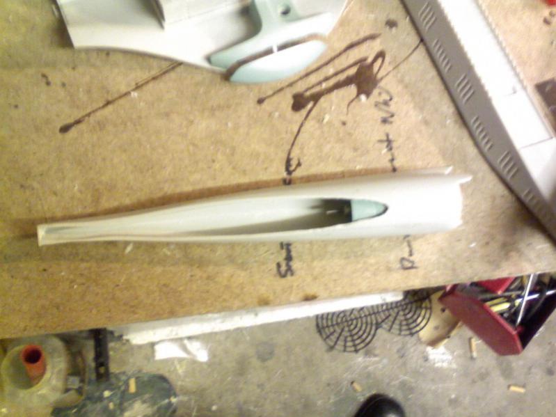

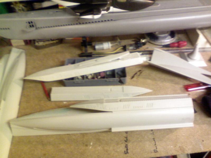

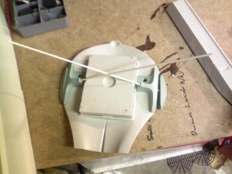

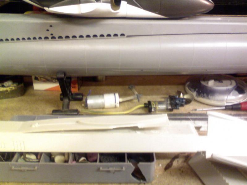

                  Anyway on with the build,both boats are now back in kit form,with only slight damage
                  I have re drilled most of my fitting kits so I can use my prefered shafting which is 3mm grp or carbon rod the castings are drilled 3mm any mountings are drilled to 3.2mm for clearence.
                  The pics show front planes test fitted and the damage to the deck.the propulsor housings have been honed out so I can wrap Davids units with 5 thou thick shim steel instead of using tape still all held with silicone,
                  I Will post better pics as I progress.

                      Looking good, Ray. And I like the .005" shim sheet. Good call. I assume you had originally stuck the kit parts together with CA? Good tear-down, not too much carnage evident.
                      And I like the carbon fiber operating shafts. Another good call.
                      Make sure you weld the parts back together with solvent cement -- after first filing off all remaining CA.

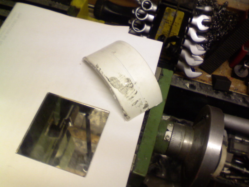

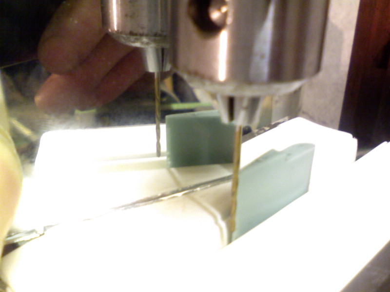

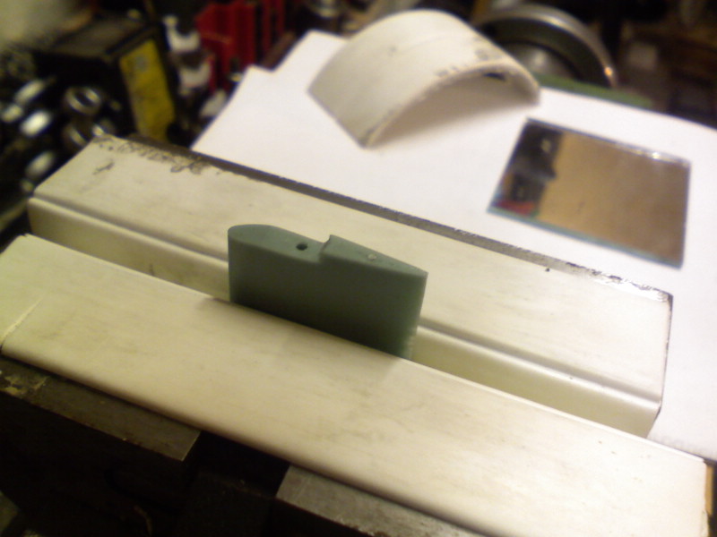

                        I now look at the new rudders,Nice...but they require a very small hole drilling in a very thin part of them.
                        Because of the shape of the rudders you will find that they are only held just behind the leading edge when in a vise,and if you grip them too hard you are filling and sanding again,if you line the inside of your vise with the soft vynyl bathroom sealer the stuff that comes on a roll and is self adhesive it imparts a good grip on the part without damage.
                        keeping it all square..
                        Because of the small size a small ladies mirror works a treat, I hope you can see in the pics you can use it as a set square and it allows you to see around the part in the miller/pillar drill and enables you to line everything up,simple.
                        Always use sharp tooling and take your time,use low speed,and of course be safety concious at all times.

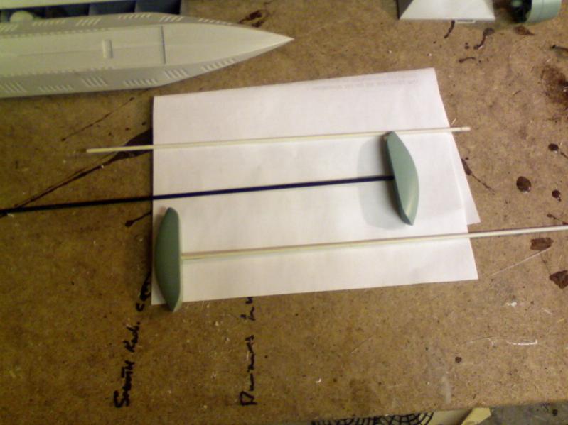

                        The other pic shows the two meterials I use,one is grp rod the other is carbon fibre,in the uk you can get the grp rod from B and Q..
                          • 14012
                          Ray,
                          Very good stuff. You're answering questions I've only glossed over -- and you're right, many people out there don't have our skill sets yet, nor wealth of experience, two things vital to successful kit-assembly and model building.
                          Keep it up!
