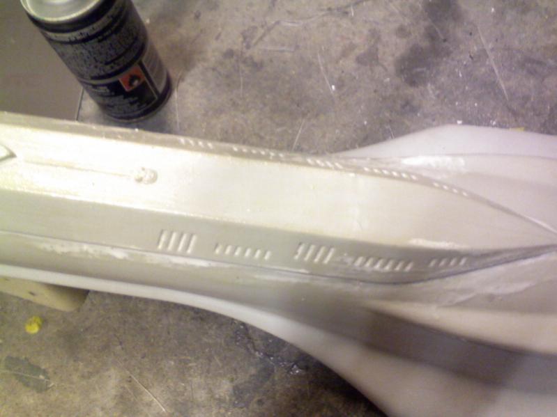

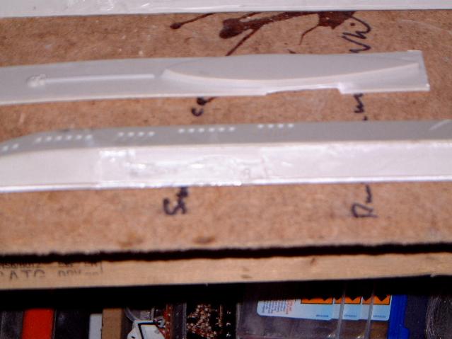

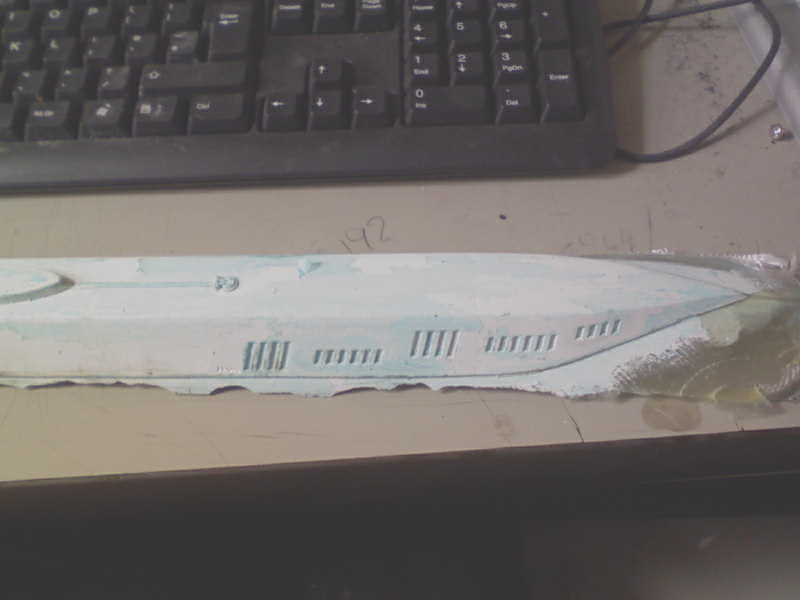

          I have not been able to get a lot done on Seview over the last couple of weeks,due to work on the house what I have done I hope you find interesting.
          Because I have had to cut the boats due to building static virsions,I damage the deck,an Email to Moebius secured permission to remold the deck out of Glass fibre.
          The mold was made from liquid latex,and fibre glass surface tissue,twenty five layers over two days,before removal from the good original boat it was further backed up with polyester resin and glass cloth.
          The resultant mold turned out better than I thought it might,so I have now replace the damaged deck with a glass fibre unit.
          The photos show the damage,then the first two layers of latex on the good boat,the rubber mold,and finally the replacement glass deck,it has a few small marks but easily sorted.

            Well done, Ray!
            You're from the old school. Latex glove with a GRP mother-mold. I like you're style, kiddo.
            The GRP superstructure looks like you used PVA as part of your release system. Good on ya.
            You obviously have been around the tree a few times. What's you model building history, anyway. You seem well grounded in the craft.
            And I applaud your checking with Moebius for permission to make the copy. A very classy move (how many people have the courtesy to do that today?). And the right thing to do.
